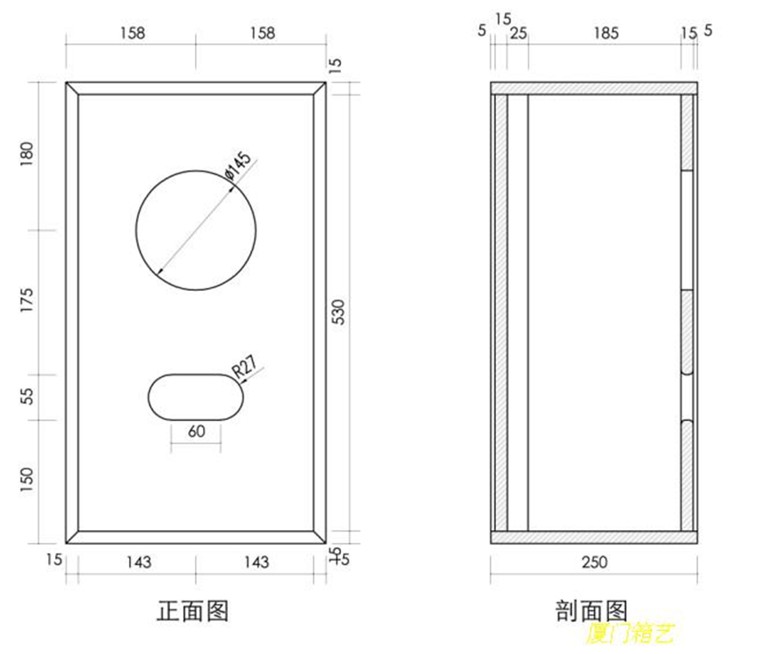

In the meantime, I had asked the supplier to send me a plan for the enclosure but got nothing. So asked another vendor selling the same and here it is attached. However, I noticed that he has a different set of drivers in there, not the ones I purchased. So not sure this wood work.
So based upon the earlier threads this design (attached) seems to have a total volume of about 20 liters, if I'm calculating correctly i.e. External dimension of 560 * 250 * 316 with 15 mm as the thickness of the box. However, the advise was to have a large box i.e. 100 liters and above or the "largest box I can live with" with high dampening/open back (aperiodic boffle ?). Would this work or the sound would be too boomy and not extended down to 60Hz ?
Could you folks comment on the above stated.

Given that I use the dimensions in post #25, would there be a difference on which side I put the driver (I'd rather have the driver on the narrowest width). And the vent, can it be located at the bottom/top etc.
Are there (dis)advantages of those design choices (given that the speaker volume/vent area is constant) ?
The narrower the baffle, the higher in frequency that it rolls off at, so there will be a slight difference in its 'fullness' down low in the speech BW and the cab's dimensions are such that the vent can be anywhere on the cab, though the closer it is to a hard boundary the more it will affect the quality of its bass response if not stuffed.
Not sure what you're asking for, so I'll just note that in a sim using the smallest cab for venting the pioneers concluded would give acceptable performance [25.47 L net tuned to Fs], it has a very strong mid-bass [underdamped] that requires it to be well away from walls, corners unless mounted well up a wall [normally preferably at an odd harmonic of its height, but may sound better at an even one in this case] and if you decided it sounded too 'bottom heavy', then the cab wasn't big enough to hold all the stuffing required to roll it off; so as already noted, a mostly open cab stuffed to 'taste' is the way to go.

Also, just to clarify, what I mean't was that:
Given I can choose any 3 sides of the box to put the driver, I'd rather choose the side with the narrowest width and the highest height. Any implications of this choice ?
Same with the vent placement, top/bottom/front/back, what difference does it make ?
Also, if I were to place the driver off center would that help in attenuating the boominess ?
Thanks in advance again.
The narrowest side will mean the baffle step response will occur at at relatively higher frequency, so you need to compensate for that if you want bass extension. However where you position your speakers will also matter, you can get back some bass by using room gain by placing your speaker near the wall. Personally I prefer the wider side, but also place the driver slightly asymmetric

I understood you the first time ;), but apparently you didn't understand my response :(, which by implication of explaining what the difference was between wider and narrower baffles meant yes, you can put it on any side you like, same as the vent since your cab isn't a high aspect ratio one, i.e. one being quite long in one dimension such as a MLTL.
Offsetting a driver in a box assumed to be of ~uniform air mass particle density only changes its inner, outer eigenmodes and since the damping inside is there to damp them down it's of no benefit, though on the outside it can be beneficial by averaging [smoothing] them out to reduce any perceived/audible effect on the driver's output and why some folks put felt, foam or similar on the baffle near/around a driver if not offset in a golden or acoustic ratio.
'Boominess' is due to the cab alignment being too acoustically small and/or tuned too high [underdamped], so short of making it larger and/or tuned lower depending on the driver's 'effective' specs [Vas, Qts' = Qts + any added series resistance], some form of EQ is required, with heavy stuffing being the most common used by DIYers and some manufacturers.

Based upon all the information I've gleaned from this thread and other readings, I'm settling on the following (impatient and don't want to succumb to "paralysis through analysis"). Please advise if I'm in the ballpark, of any "faux pas" or if I'm totally off:
I'm settling on the below:
  • Volume of about 25-35 liters due to size limitations (against a suggested 100L and up)
  • I'll be using a perforated back (pegboard)
  • Heavy damping on the inside i.e. mostly ceiling insulant, and car noise damping material that I have already
  • Driver will be on the broadest width (to improve the bass, albeit a little) and may be off center (any way to calculate optimum placement ?)

If I have a perforated back, do I need a vent/port as the diagram in post #25 suggests ? Are they mutually exclusive ?
No, the entire back is a vent, so if more is needed, then start converting sides to pegboard.
Offset drivers using a golden or acoustic ratio [two out three of an acceptable room ratio].
Thick baffles require the driver cutouts for to be heavily chamfered [>45 deg] for all but bass alignments with a low XO point.
For lossy cab construction, only the baffle need be rigid/braced with the driver mass loaded to it, i.e. build like an OB and tack on a lossy back box that's only there to hold the insulation.
