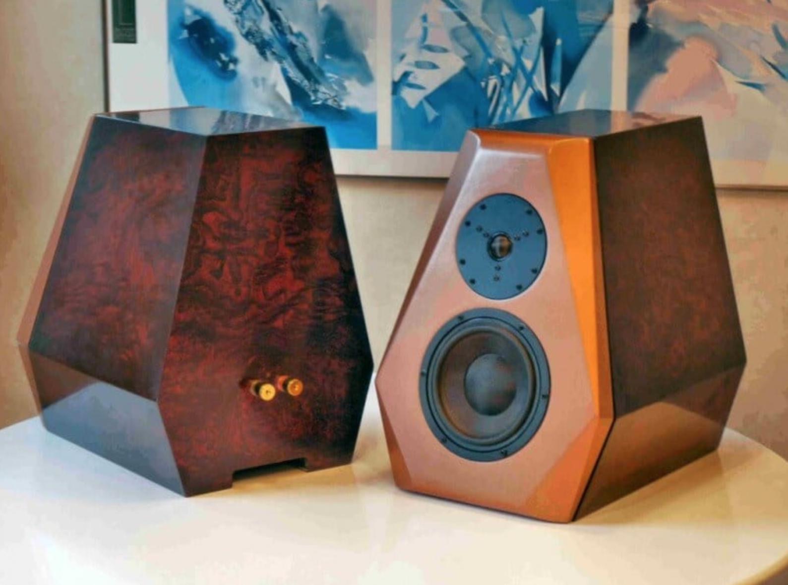

If a passive radiator isn't used on the midrange I like the look and benefits of a faceted cabinet like seen here.
Any critiques or additional thoughts out there?

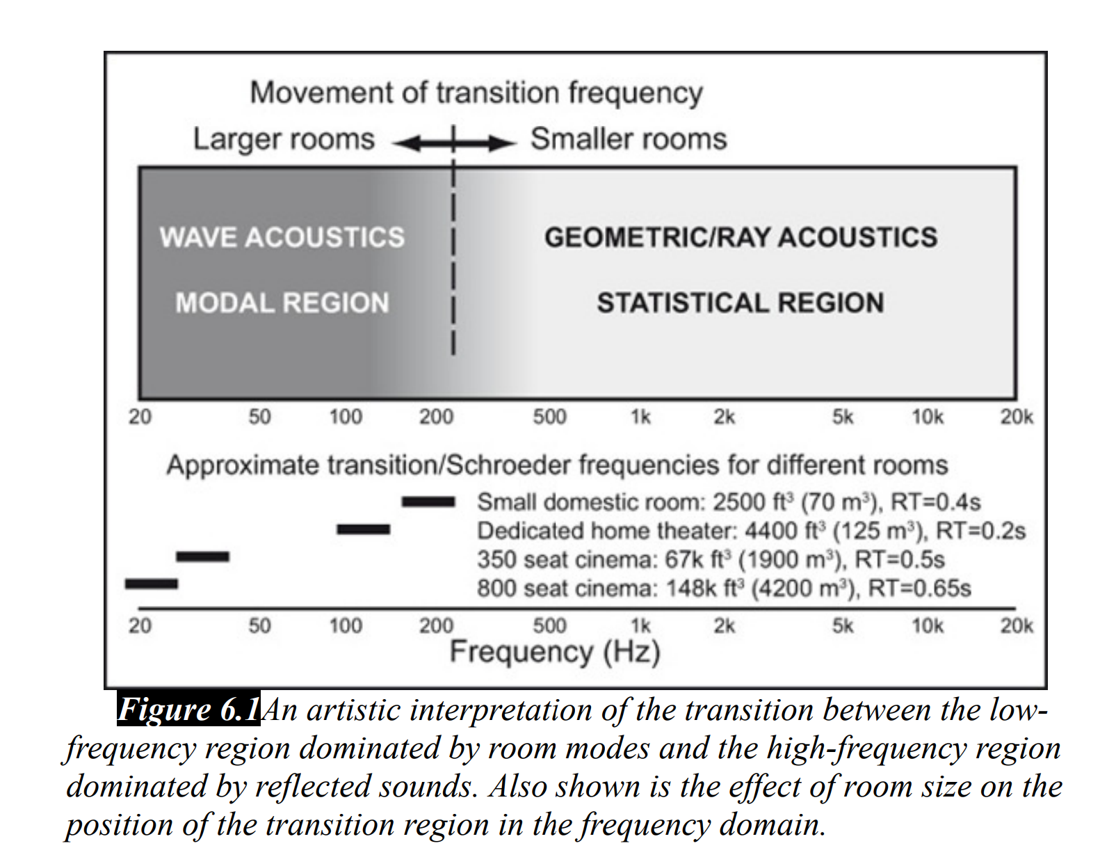

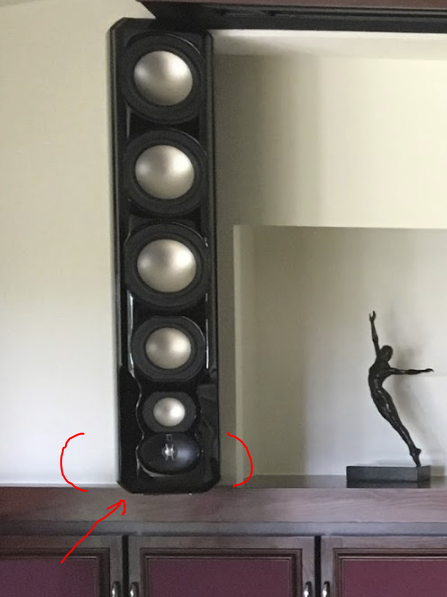

Have you ever seen this graphic?
It's from Floyd Toole's book on home audio. The point he makes in the book is that you need two audio systems, one for low frequencies below the small room transition frequency and a separate one above. A four way speaker can't deal with the low frequency zone.
In fact, if you look at Floyd Toole's house you'll see Revel Salon 2s mounted upside down. Strange. But the part I'm not sure is widely known is that Todd Welti specifically crossed the low frequencies out of the Revel Salon 2s in Toole's house. The low frequencies from the Revel Salon 2s interfered with Welti's four subwoofer low frequency sound field management system.
So, if Welti and Toole crossed the low frequencies out of the Salon 2s I'd argue it isn't a good idea to follow that kind of design as a DIYer. Instead, just build the top part and then add a low frequency multi-sub sound field management system.
