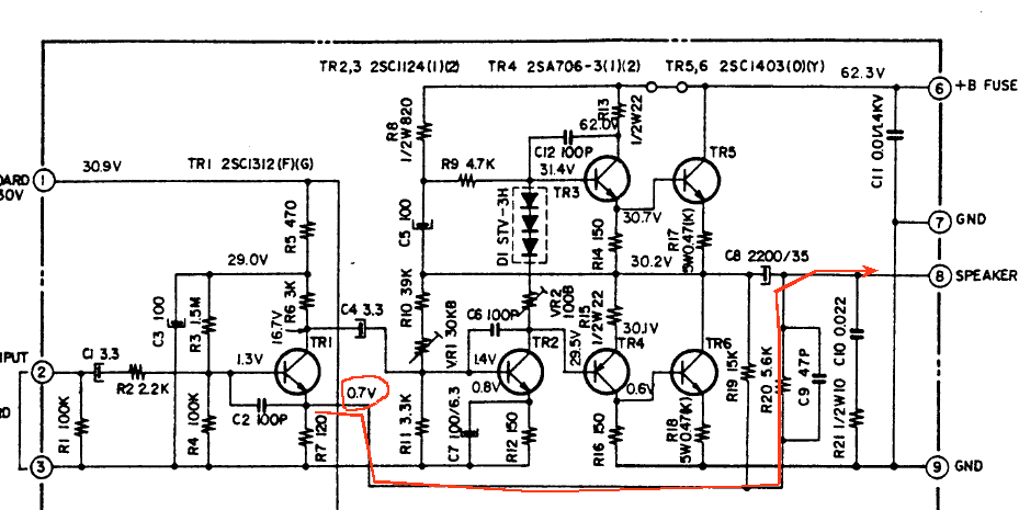

Put a 10 ohms (<100r) resistor on every output and try again.
There is a NFB resistor coming from a 0.7V Emitter through 5k to the output. If the output is NO-load, you read most of the 0.7V. With 8r load it calculates as 0.001V. (Cap leakage and settling will typically give a little more.)

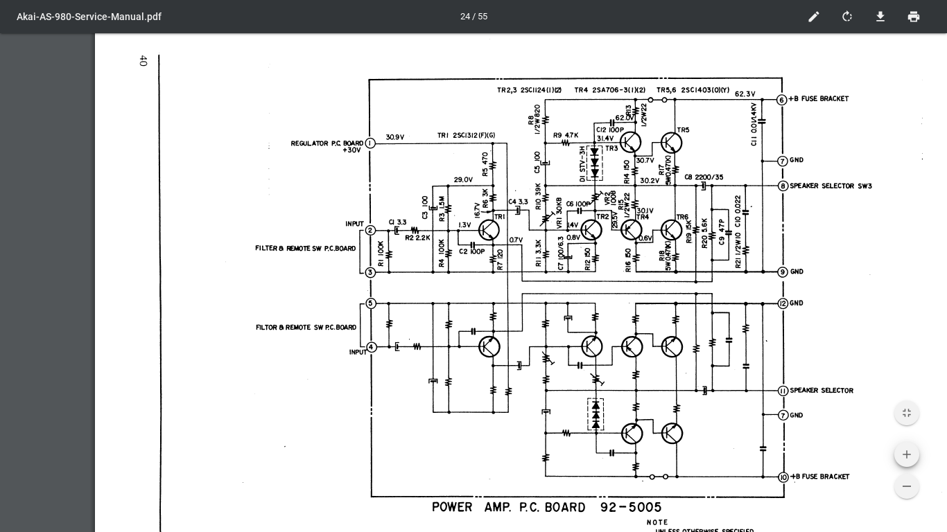

I guess there is something wrong somewhere that probably caused the fuse to blow in the first place. I'm attempting to attach a circuit diagram of the amp board so hope that works.
The output to the speakers is shown at points 8 and 11. As you see, the 62.3 input voltage comes from the fuses, one of which was blown. It may have blown by someone shorting out the speaker terminals or by something on the board - hard to tell.

As PRR stated, you can measure the emmitervoltage (top R7) at the output when no load is connected. To reduce this (harmless) dc, you can add a bleeder (over the speaker terminals) of 120 ohm (sufficient W)) reducing this dc to some 16mV.
It is inherent to this topology.
Without a load the time-constant to discharge the output blocking capacitor is 44 seconds. So after 5 minutes or so it ought to be reading OK.
The feedback point is a combination of before and after the blocking capacitor C8, so any charge on the capacitor will throw the output offset. (Its done this way to reduce capacitor distortion).
Because there is a blocking capacitor the output offset will invariably be tiny in real world use with a load. (Unless the cap leaks badly and the amp has a huge offset internally).

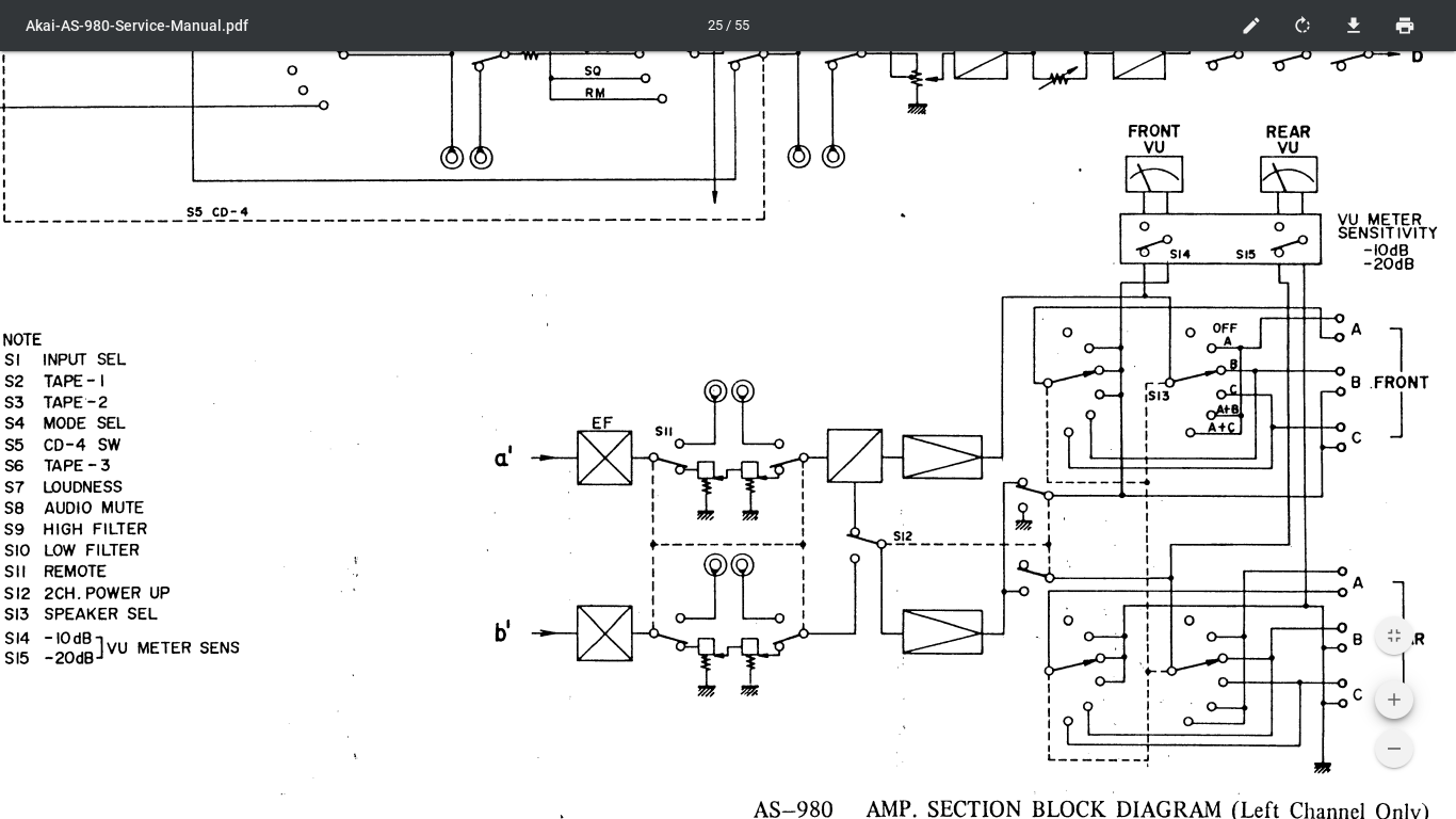

The dc offset doesn't reduce in time. I will try the solutions suggested but meanwhile I've been trying to understand the logic of the circuit and I think I now understand that at least. From the attached diagram you can note switch 12 which selects 4 channel or stereo boost. It is shown in the stereo boost position and here it takes the inverted signal to one of the amps and feeds it to the negative speaker terminals so this explains why in this mode I measure no dc offset on front L and R - it is on both + and - speaker terminals so the difference is zero. With switch 12 in the other position the 4 amp outputs separately drive the +ve speaker terminal with the other being grounded, so the dc appears on all 4 speakers. I will try measuring dc offset on each speaker terminal to ground just to confirm this.
