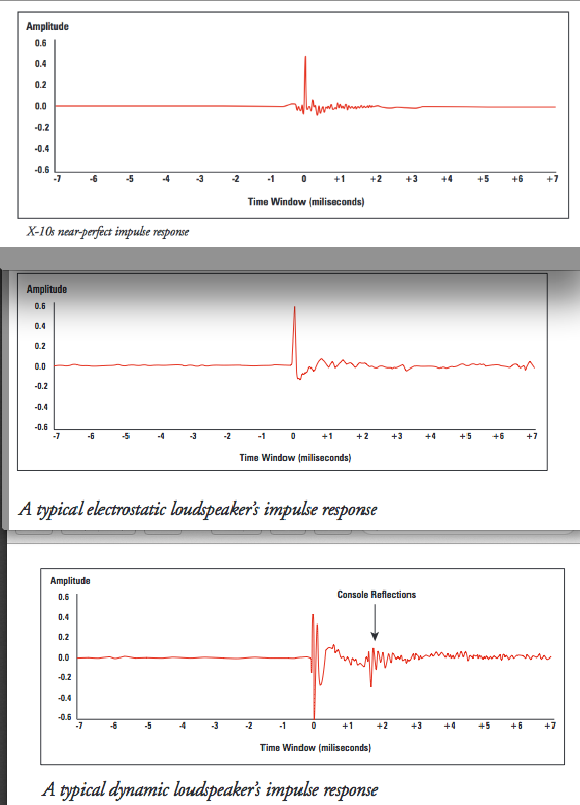

This piece of a paper written by John Dunlavy shows interesting impulse response:
That last impulse response example of a Dunlavy speaker sure looks compact.
Not a big negative peak after the positive pulse.

I don't see how the last one is possible. It does not average to zero and hence it will have changed the static pressure of the world.
That came straight from John Dunlavy's papers. From the interview with Dunlavy by stereophile he seemed quite serious about measurements of impulse and step response. It appeared to have had his main focus at the time.

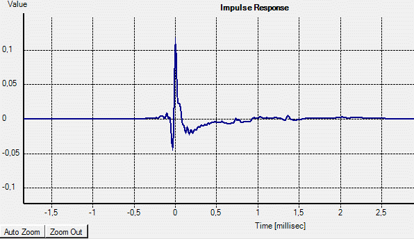

Here is an old design on mine. Except for the fact that the impulse is upside down....

Seems your polarity reverse shows the usual leading edge +amplitude higher than the -amplitude, which I have noticed in the impulse response of other speakers with good transient response.Here is an old design on mine. Except for the fact that the impulse is upside down....
