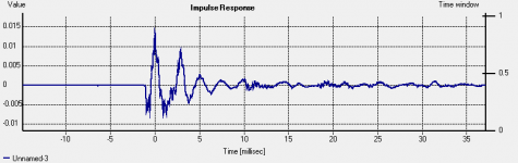

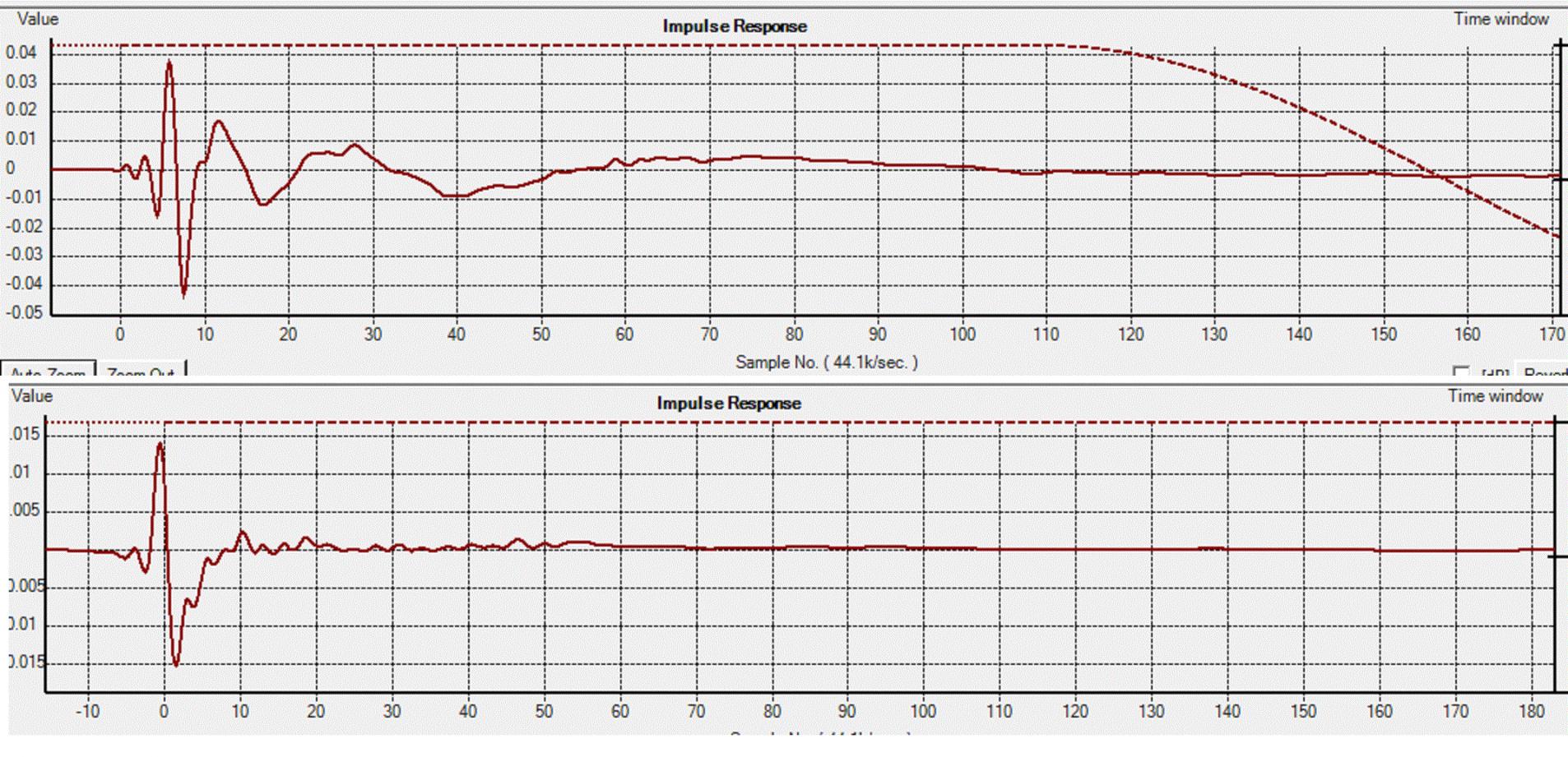

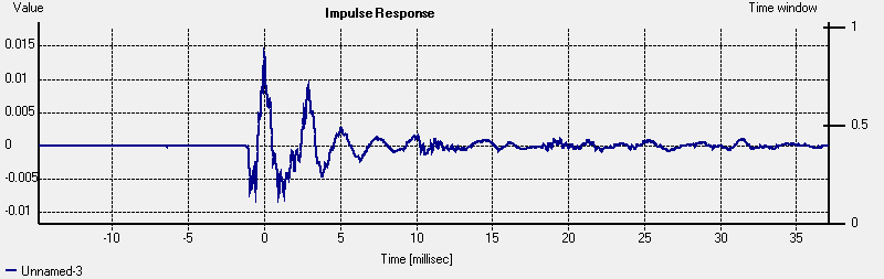

Very interesting. Can you tell us more about these impulse responses ? My guess is that the second one can be the Summa's or the Abbey's because the DE250 breakup around 15kHz. For the first one, I have no idea. You say that it is non minimum phase ; can you explain how you can see that ? And what is it's origin ?View attachment 376041I put these two together as classic examples of highly different impulse responses even though the frequency responses of both are pretty good. In the top one the non-minimum phase aspect is obvious. Both have a LP filter at 12 kHz because the bottom one have a strong resonance at 15 kHz which causes a large ripple in the impulse which obscures what I am trying to show. You can still see the ripples slightly. The pre-ripple is from the digital filter in Holm.
I see the same thing in music. If you have massively expensive speakers, they are focused razor sharp and each sound is distinct. Call it clarity, call it transparency, call it Mary, call it what you will, but when you hear it, you know it.
Good description, matches my view.
And to get that sound for a very reasonable price: make your own speakers 😉
The second one is, of course, a Summa, few other speakers have this clean an impulse - none that I know of.
The first one is a well known dipole.
In a minimum phase impulse response the impulse has to decay monotonically. This is clearly not the case as the oscillation extends out quite far and appears to actually start after the main impulse. This could actually be the LF filter needed to boost the sagging low end of a dipole, but it could also be the diffraction around the open back, or a mis-time aligned set of drivers. I don't really know except that this is not a "compact" impulse response and hence will not reproduce waveforms accurately (not that this is an essential requirement, but some seem to feel that reproducing a square wave is a good thing.) The Summa will clearly reproduce a square wave with almost no aberration at all.
The tail on the dipole may actually be why the bass sounds so "spacious". I am not an expert on dipoles so I don't really know. Accuracy is my thing and an ideal impulse response is a good indication of such.
Edit: On looking at the first impulse response again it may actually be decaying monotonically and hence may be minimum phase. At first it looked to like the second set of oscillations started later than the first and that the first had decayed down and then the second rises up. But that may not be the case. I just grabbed those impulse without taking a serious look at them.
The region in the Summa at about 50 samples is clearly non-minimum phase because it rises up out of the background. This is likely a cabinet diffraction (not positive, I'd have to do some more calculations to be certain). Normally we would not even notice this because most impulse responses will obscure this kind of thing.

Nothing that you have said is new to me, except that I don't get how you can claim that the Summa is not minimum phase given the impulse response that I showed. That's like saying that one cannot tell minimum phase from an impulse response, which is not true. Perhaps there are things that I do that negate your claims?
It sounds like you don't buy the concept that a speaker system needs to reproduce the waveform of the signal - square waves, that sort of thing. I'm not sure that I do, but I have found that the more compact the impulse response the more I find the system to be "transparent".
John
If you are claiming the Summa is MP then you are claiming that through the crossover region the woofer and tweeter acoustic responses sum to an all pass response with no or linear phase variation. Is that the case?
I have never thought about it in those terms, but judging from the impulse response that would appear to be the case.
If you don't believe that this is the case, then how do you explain the impulse response results?

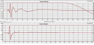

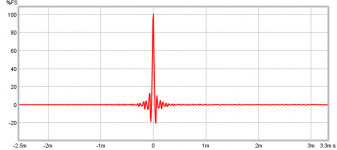

An ideal impulse would be a large first peak followed almost immediately by a negative peak of almost the same amplitude, but this second peaks would tail off with a very long ripple indicating its HP function. In the second one there is a small aberration from the cabinet at about 50 samples. But the bottom curve is far better than the top one as far as a compact impulse response goes.
Negative peak of almost same amplitude is vague, and misleading. Conditions of crossover frequency and filter order should be given along with bandwidth of system(which is pinned down in these measurement by sample rate of 44.1kHz).
A series of 1kHz Butterworth filters of increasing order with first positive peaks normalized to 0dB with sample rate 48kHz are generated; the magnitude of first negative peaks are as follows:
1st order: -9.1dB 35%
2nd order:-7.5dB 42%
4th order:-4.7dB 58%
8th order:-1.2dB 88%
10th order: 0.2dB 102%
First order filter is minimum phase; all pass as sum of high pass with low pass returns Dirac. Non of the others do.
Impulse response with more compact form most closely resembles 10th order filter. Since all pass function of speaker system is not high order, impulse response likely indicates that driver exhibits extreme overshoot with increasing amplitude and frequency of drive signals, or in other words highly complicated phase behavior.

I checked the phase of that impulse response in Holm and it is a straight line through the crossover.

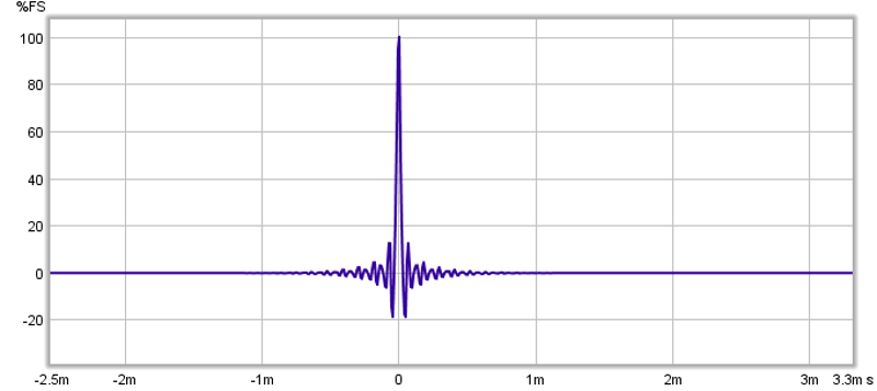

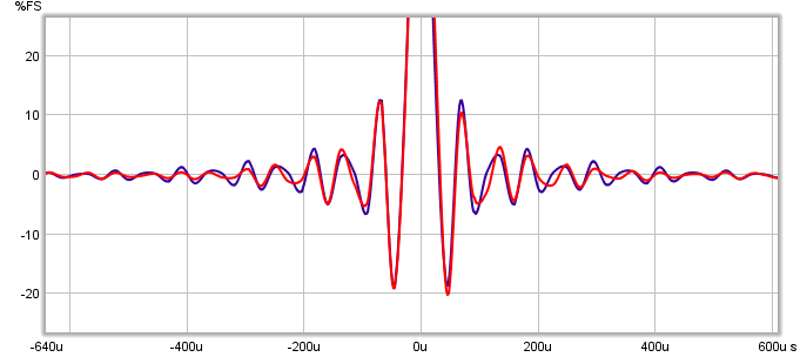

I've worked with tidy impulse response for quite some time. System is implemented as linear phase; drivers are corrected for amplitude and phase, and linear temporal anomalies are optimized to listening axis. The system bandwidth is controlled by linear phase high pass and linear phase low pass filters.
The combined all pass filter becomes model of system impulse response:
The measured impulse response is visually very close to the target set by the model:
The two viewed as overlay and zoomed in amplitude:

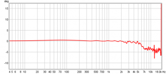

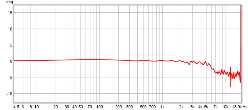

Phase is not only a very straight line, it is also very flat:
