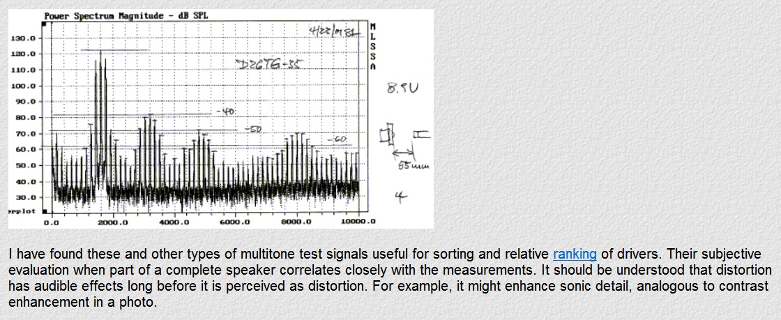

adding some objective discussion
Ok maybe we should spice the discussion up by introducing more objective data already provided by Siegfried L.
He clearly showed that just a few tones played simultaneously will introduce a broadband noisy background for all the other tones to come. The idea behind the "darkness" is to keep that background noise as low as possible i.e. "quiet", so any tone jumping out of that background and going back into it has a large dynamic range. In other words prevent the individual tone "spillover" into the other tone frequencies and their intermodulation. So he called for introducing multitone distortion measurements.
check the following links:
Frontiers
on the example of the tweeter excited with just two tones, a carrier tone and a modulating tone at 1/10th the carrier frequency where only the three tallest spectral lines are expected, one gets a whole spread of new ones running at a lower level. so there you are looking at the content inside the "darkness". well if that content is not kept low the background will not appear as "dark" and the speaker clarity will suffer.
there is no reason why these tests could not be done on both the raw drivers and the finished speakers.

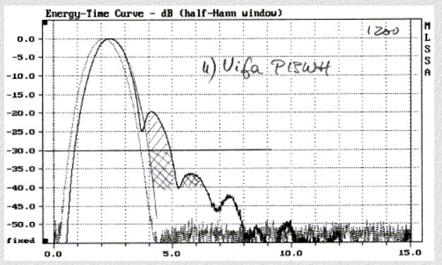

I however noticed that in his measurements Vifa P13WH which was well regarded in Olsons's Ariel speaker did very well. The ranking does not quite reflect it since SL, in his test, stuck to a constant volume displacement and this driver was in a smaller size than the rest, so the comparison for this driver was not apple-to-apple.
I also noticed a nice bouncy shape of the rolloff curve, which may be of importance in addition to considering the mere area under the curve.

As to multi-tone, it does not show those things that I do consider as important in the impulse response because it is a steady state test.
I would like to make a plea here about terminology. The term 'distortion" gets confused and we need to resolve that. When someone says, for example, that a horn sounds "distorted" that may be quite true. But that could be two things - linear distortion or nonlinear distortion. The two things are quite different and using the single term "distortion" does not adequately define the meaning. For the most part I exclude nonlinear distortion in a loudspeaker as a major effect (as does Toole and Olive). But I certainly believe that linear distortion is a major effect.
Most people will think of "distortion" as being nonlinear, as was implied when you mention multi-tone because this test will only show nonlinear distortion. All linear distortion is evident in the impulse response, but nonlinear distortion is not.
So I just hope that we can all be clear on the terms and meanings so that things don't go off on a tangent due to bad terminology.
I would consider the cross-hatched area to be indicative of a bad response, although ETC is too smoothed for my taste.
