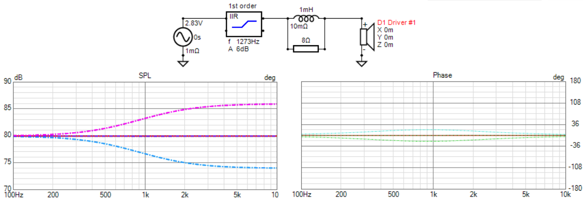

That's not the subject we started talking about, although I'd be happy to discuss these at another time.
Just to put straight what I was talking about with series inductance since direct filtering of this nature is a reversible effect..
I leave it to you to show that there is anything more happening...
