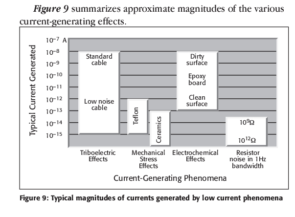

From Keithley, it seems they put Teflon in the piezo/mechanical stress category.
