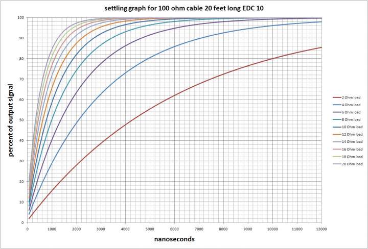

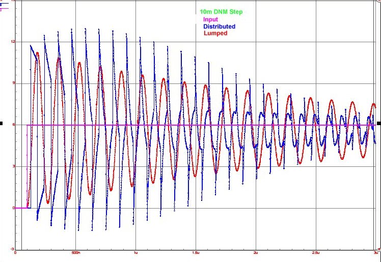

Scott. Yes, we have simulations of lumped Vs distributed done with SPICE by Keith Howard, Technical Editor, Hi Fi News, in PDF format. Could some one please tell me how I can post this on the forum so all can see?
As pano said, you can attach. The attach window shows the size limits for various filetypes.
This graph seem familiar??

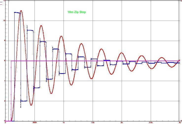

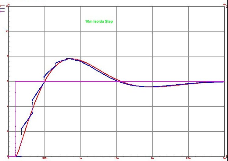

Attached are simulations of three cables. 10m DNM (CI 470) 10m Zip (CI 120) and 10m Isolda (CI 8). The mauve trace is the step input, the red trace is the lumped and the blue trace is the distributed R, L & C.
I will attach the circuit later as this lot fills the allocated attachment size limit.

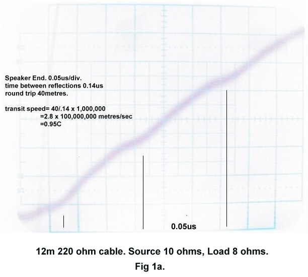

Ill repeat it. Its not a round trip. Its one way from the load to the source.
You said 100-200 reflections, think about it the "action" at the load starts with a 15ns delay all the subsequent steps are 30ns wide.
The first two do not predict your "slower response" glitch, they look like ringing around the desired level. Low pass them (like any real audio power amp would) and they will tend to look alike.
Please, please somebody send me the schematic of a nice 100W amplifier that makes the blue traces.

Thinking about it yes you must be right. I dont recall exactly the time delay but at the time of the experiment the delay was as predicted from the speed of signal propagation. In the intervening time I had forgotten the round trip so I was wrong in my example calculation assumptions but it doesnt change the principle nor what I saw ie the steps in the square wave front edge. Of course you do have to use a fast scope to see the staircase so square wavenplots produced in say mag reviews wouldnt show it. I think it was at least a 100MHz one perhaps even faster.
Need to repeat the experiment to establish the hard facts.

You are correct, assuming a prop delay of 15 nSec for the length.You said 100-200 reflections, think about it the "action" at the load starts with a 15ns delay all the subsequent steps are 30ns wide.
I agree with you. The ringing of the speaker line in that fashion will do nothing that the load can see.The first two do not predict your "slower response" glitch, they look like ringing around the desired level. Low pass them (like any real audio power amp would) and they will tend to look alike.
Why was the load put higher than the line??? What a messy model, and not consistent with the actuals..
I believe you meant magenta trace.
Why oh why is it anyone would assume that one needs nanosecond risetimes to have reflections on a two meter cable??
Cheers, John

Just what i said. And a quite fast amp to get such slew rates ;-)I think it was at least a 100MHz one perhaps even faster
Will ask some mosquito friend of mine if he can ear such frequencies. The one who complain about my tweeters.

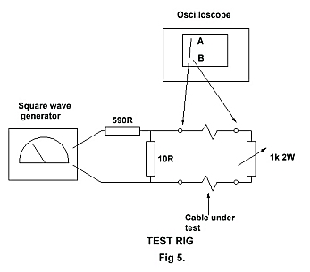

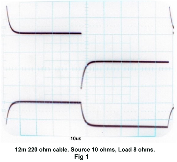

Measurements of 12m DNM cable (420 ohms)
The first picture is the test setup. It doesn't matter what the source (amplifier) impedance is. Ten ohms was used for convenience to show the reflected signal at the source. The source impedance can be between zero ohms and infinity, and the results at the SPEAKER end are the same.
The second picture shows the slow rise time at the speaker end (as shown by a 100Mhz scope) and the third picture shows the reflection ripples at the speaker. The simulations are theory to show that there is a difference between lumped and distributed and the scope pictures show reality.
Following, on the next post, are scope pictures of impedance matched cable.

The theory of the reflexion of electrons on line extremities witch makes you able to build an echo chamber with only 5 meters of cables.My question was meant to be: What is low frequency transmission line theory?
So you need 100mhz scope to see effects in under 20khz signals? That should be a red flag.
