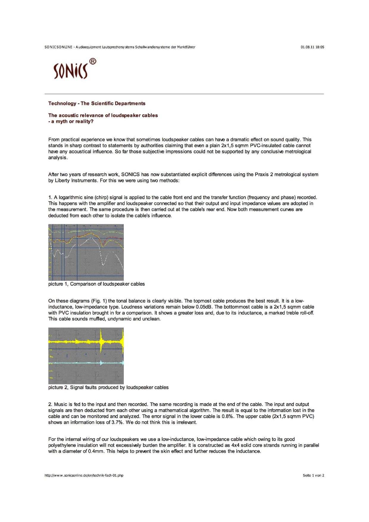

Here i try again ...
Thanks for sending this. But I think it would only be useful if plots were shown of the loudspeaker's impedance vs frequency and the inductive and capacitive components thereof. Some interesting correlations might show up. This measuring set up is flawed otherwise. The same cable could do well on one loudspeaker, and badly on another, and with another cable, the results could be reversed.
Vacuphile, the loudspeaker was a Sonics Allegra and the first plot shows that the impedance curve is reflected into the cable. It is a 3 way reflex design with a minimum impedance of 3.3 Ohm. This is rather low impedance and with a higher impedance speaker, thinner cable would perform ok. Most speakers have also a rising trend of the impedance in the treble due to voice coil inductance so even a higher inductance cable would work. The loss in the treble and frequency dependent loss of volume in a cheep 0.75qmm PVC cable could of cause also be equalized in the crossover or by the use of electronics, analog or digital. If then there is still a considerable difference in sound to the non equalized exotic cable i would be surprised. Yes you are correct, this test is only valid with the speaker and amp combination i used but is has shown that there is not simply a treble and volume loss in cables but also it forms a frequency dependent divider due to reactance. A "normal" customer has no idea about that so he is simply swapping cables and hears differences. This could be due to simple, linear differences in frequency response, although minuscule.
Is that a valid 3rd party test?? Is it just a link so I can read it too?
btw, Even Monster and BOSE are famious for their "white paper" stuff.
I think that paper just shows that a potential divider divides potential. Note the way that 'difference' is described as "error". This is classic FUD: before you can sell a solution you have to sell the 'problem'.
Yes, i think the essence is valid. i did the test myself when i was CEO of Sonics so it contains some sales blurb. I mentioned that in my previous post. Sorry for that. You can read the complete thing under SONICS® - Audioequipment Lautsprechersystems Schallwandlersysteme der Marktführer "Technics".
