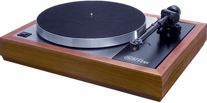

But first, let's discuss those old microphonic turntables. Because the LP cartridge was a microphone to vibrations in the LP groove. It was always well known that to put a turntable near a speaker or near thumping footsteps was a BAD THING! 😀

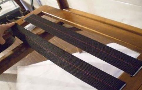

The Linn Sondek had good acoustic isolation, being mounted on soft springs. It was quite forgiving. Hence sounded good. Sofa webbing works well too.

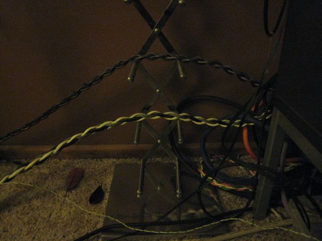

This business with lifting cables might have a much simpler solution. Whatever effects are created by having a dielectric, or metal plane, or mains hum near the floorboards, they will be reduced by twisting the cables:
Twisted pair - Wikipedia, the free encyclopedia
In practise, cables (maybe 100-150 ohms characteristic impedance) are higher impedance than 8 ohm speakers, so the effects at the speaker termination are inductive. So run those cables on the floor, but TWIST them if the effect of a nearby dielectric or ground plane or mains hum is significant. That's what the science says. 😎

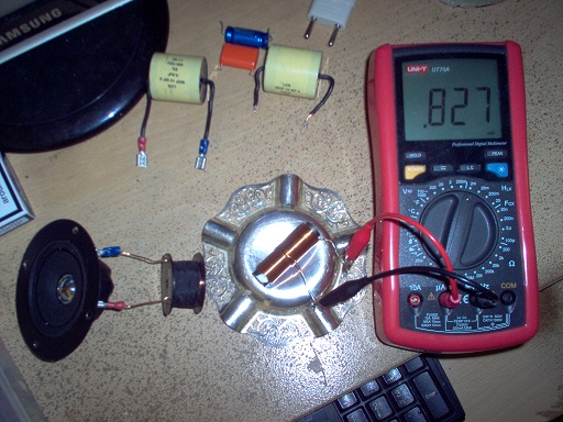

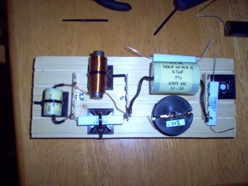

There are measurable effects from nearby metal surfaces on coils. Hence I have abandoned metal PCBs in favour of wooden crossover mounts. This 1mH coil measures about 20% different near a metal ground plane. I take it you all understand right-angled placement of coils to reduce interaction.
