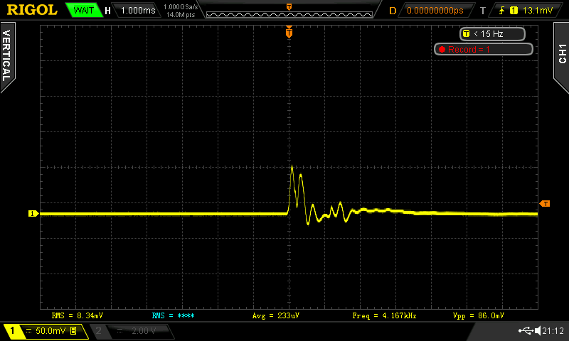

You can get microphony in cables, I've got some coaxes which generate some pretty good signals when bent. However the effect generates charge, which needs impedance to turn into voltage. The effect is spectacular on a scope (imput impedance 1MOhm) or a low noise preamp, however, when considering the output impedance of a power amp and loudpseakers in parallel, you can expect the resulting voltage to be infinitesimal.
They make "low noise cables" for stuff like EEG or vibration sensors, those got a special anti-triboelectric layer inside. Balanced microphone cables are filled with cotton because if they weren't you'd hear a THUMP everytime someone walks on them. All those have a thing in common : high source impedance.
Here is a scope shot... it's a 50 ohm coax that's been hit with a pencil. It generates some 85mVpp into 1Mohm. This tells that this particular coax isn't to be trusted if measuring stuff from a high impedance source. If the source impedance was 1 ohm, well, the effect would be 1 million times less... on a typical audio amp output impedance it would be in the nanovolts... would probably make less noise than a flea fart...
A simple test would be to grab your speaker cable and wiggle it. Does it make noise in the speakers ?... Probably not... if it does then you got a bad contact somewhere and a bit of DC on the amp output...

Coaxial cable is not figure 8 speaker cable which is typically used for speaker connection.
Coaxial cable connected to a high input impedance of a pre-amplifier acts as a capacitor in parallel with that input, and as capacitors maintain even a minute value of charge in their dielectric any change in capacitance due physical distortion will no doubt produce a voltage change at the input of the pre-amplifier and thus will be amplified.
But of course that is not what we are talking about.
C.M
Indeed. As peufeu points out, speaker cables are always shunted by low impedance which settles the matter anyway, no matter whether fig 8 or co-ax. Besides, signal levels in speaker cables are perhaps 80dB (x10,000) larger than microphone level. Speaker cables aren't microphonic in use, in my book.But of course that is not what we are talking about.
