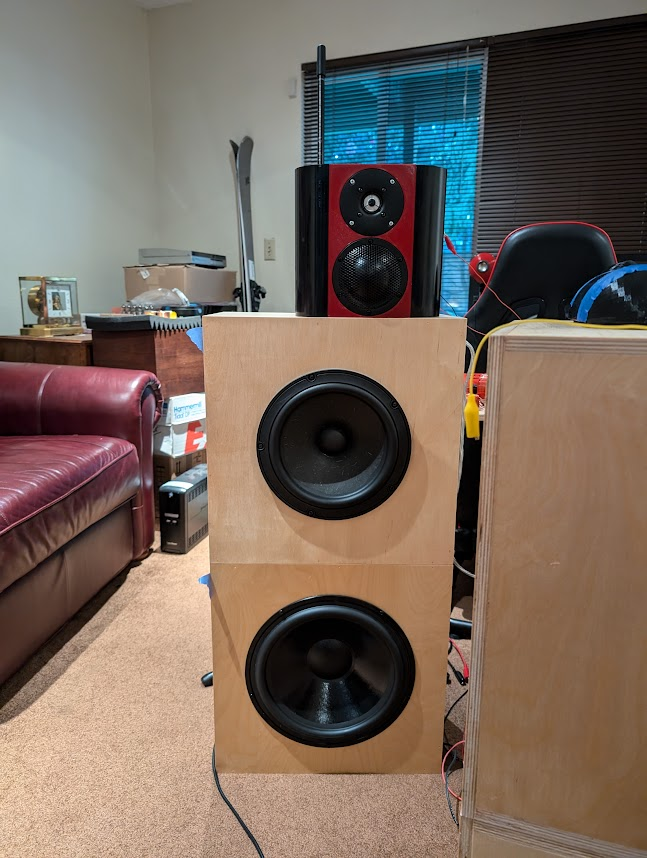

For example my recent build has a 10" woofer, 3" midrange and 1" tweeter. It is 3 dB down at just below 40 Hz, will play with low distortion at 108 dB at one meter and has a very wide dispersion. As I'm not a good cabinet maker it looks sort of bad. I spent $150 on the woofer, $40 on the 12" passive radiator, $500 on a very good dome midrange and $85 on the tweeter. It actually has two of each driver, with drivers on both the front and back to form a bipolar speaker with an omni pattern.

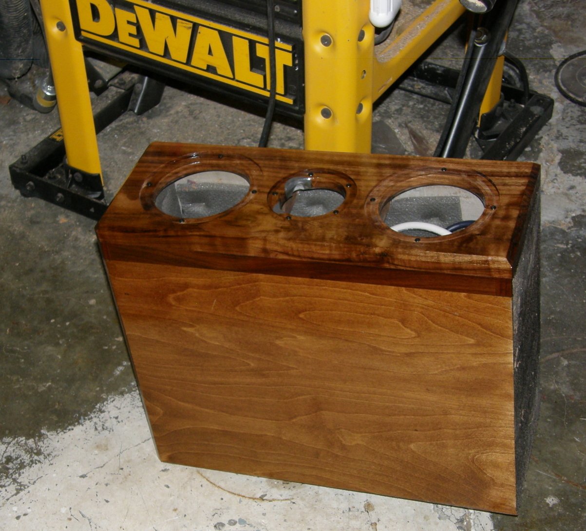

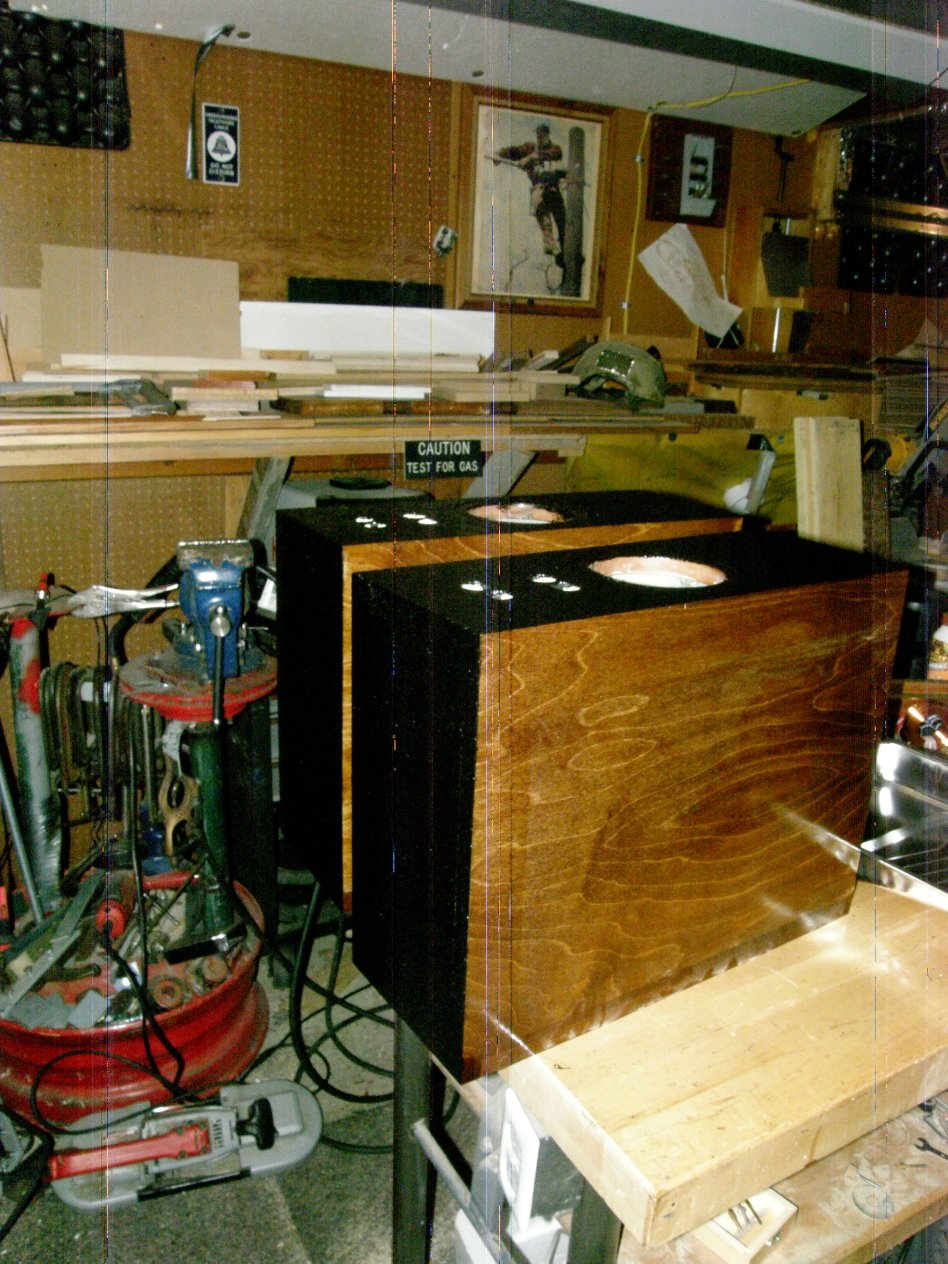

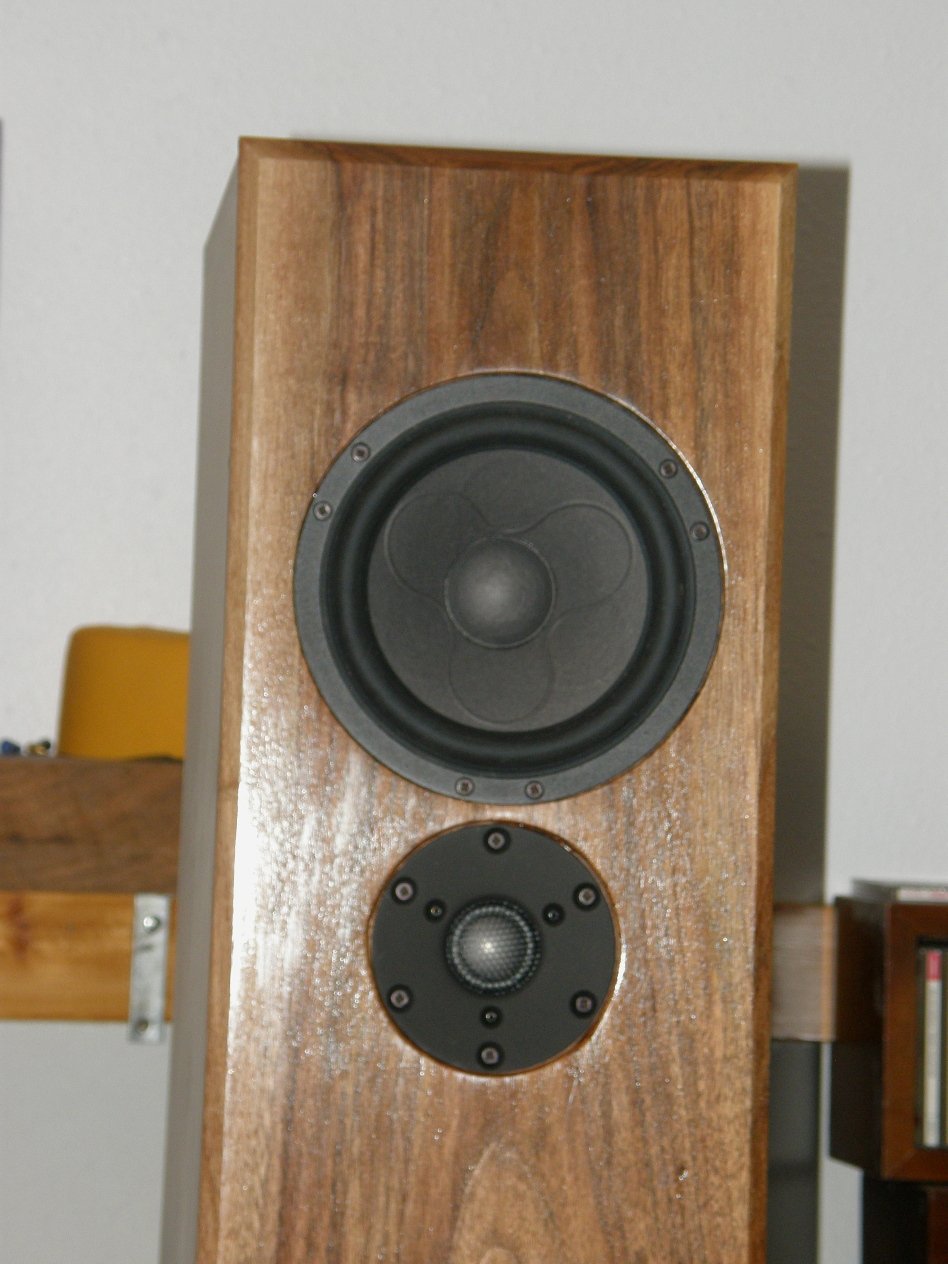

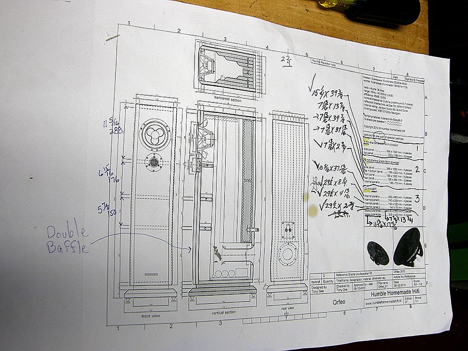

Yes. I built three cabinets of two different Gravesen designs. All three were for a friend in Denver. The first set was small, but very heavy due to the internal design. The next two were floor standers that were also heavy due to the same thinking of internal cabinet design. An unusual amount of MDF was used for all of these cabinets. I will try and find some excerpts of the process.
