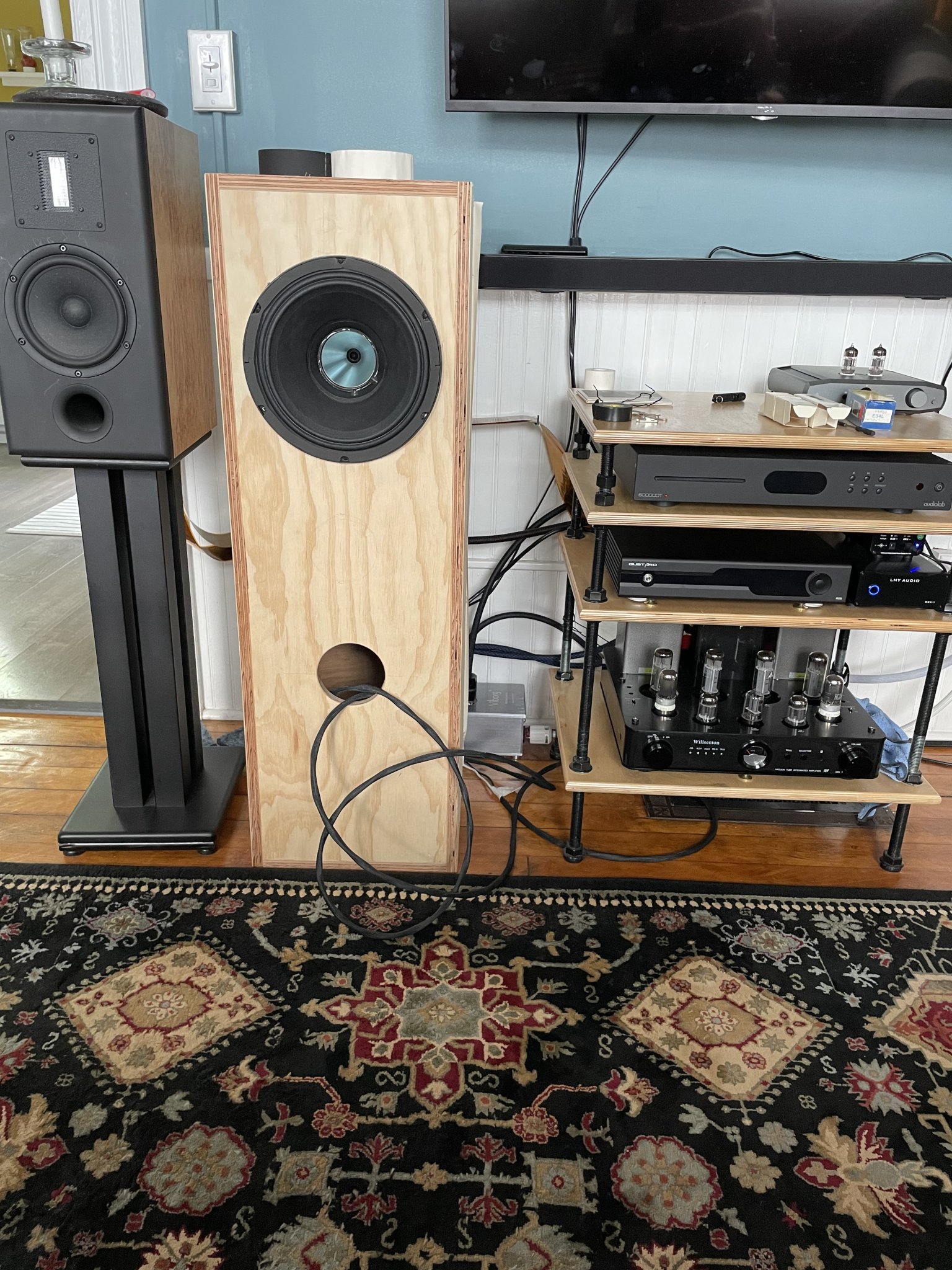

FWIW, here's my test enclosure:

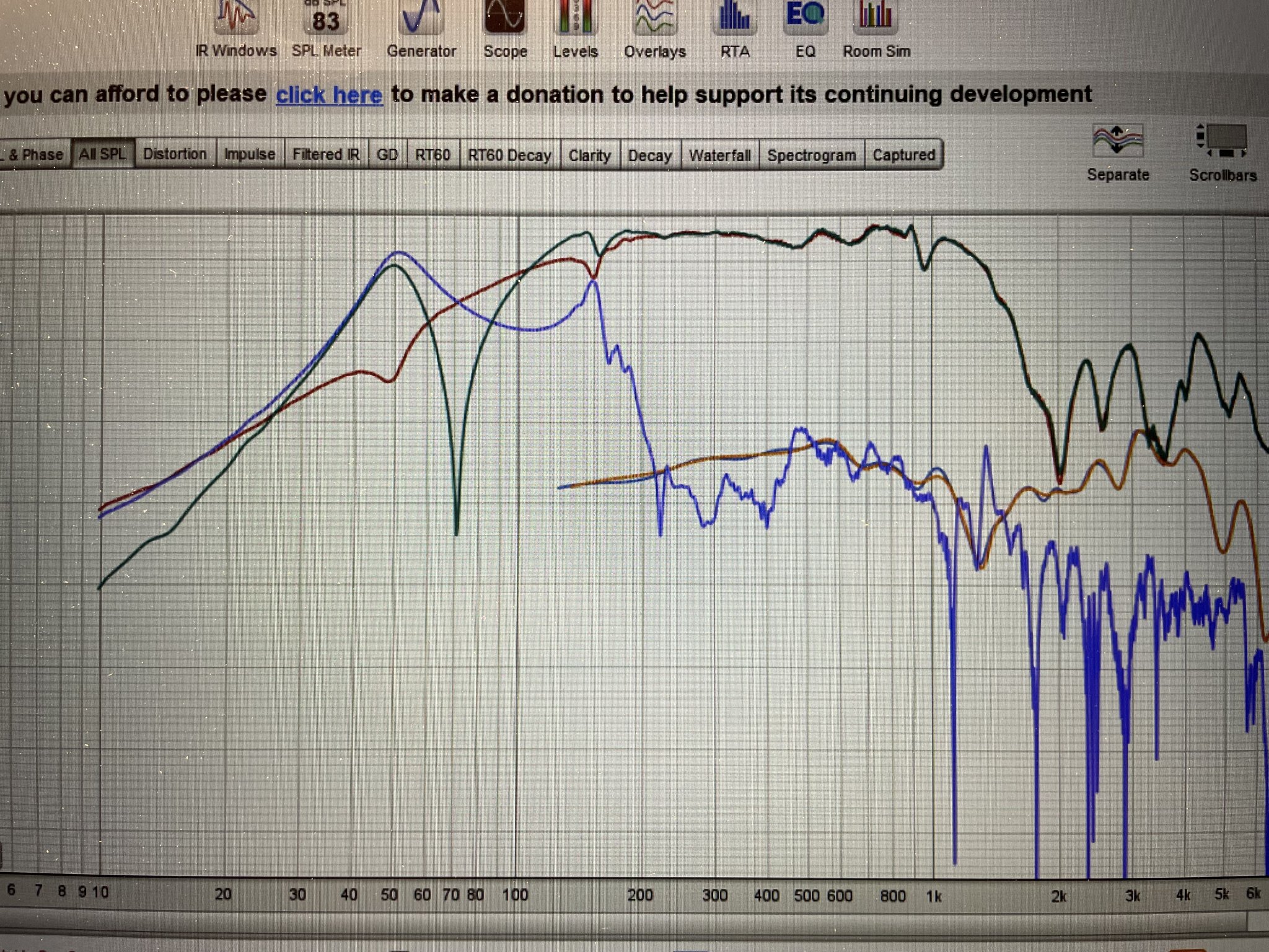

Here is my first dilemma - I've summed the port with the nearfield woofer measurement, in the first pic the port is dialed down -6.4db to align better with the woofer. In the second I dialed WAY down to -12db just to see what the difference would be. I don't understand where that nasty null is coming from at 60hz, does anyone have an idea?

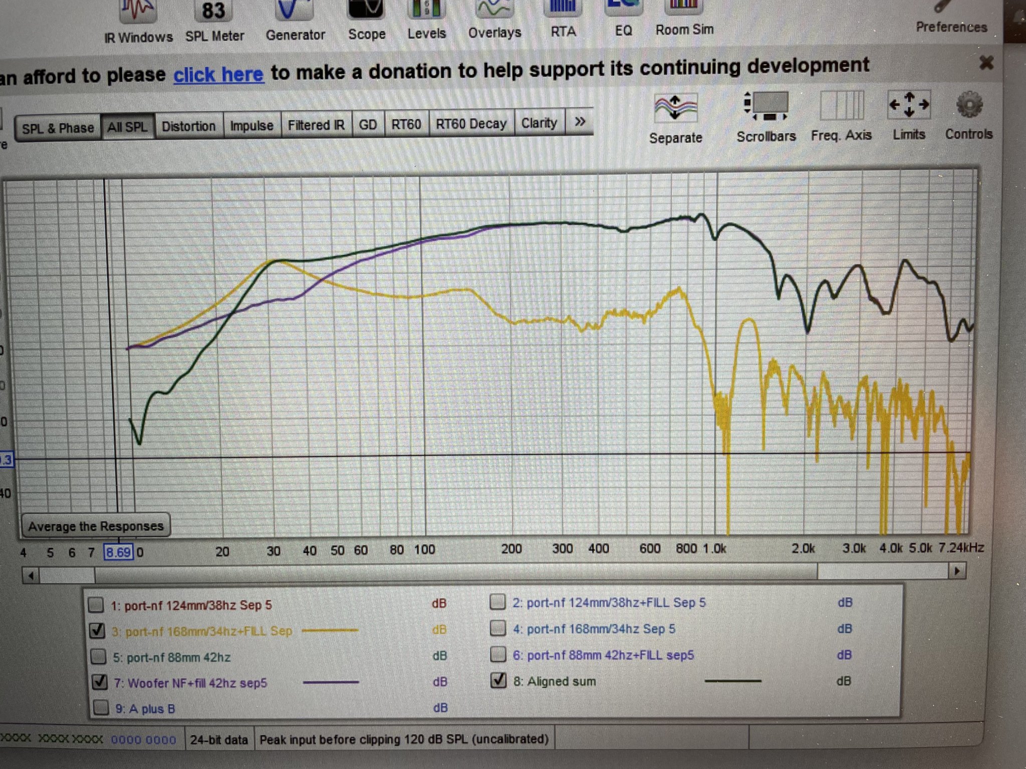

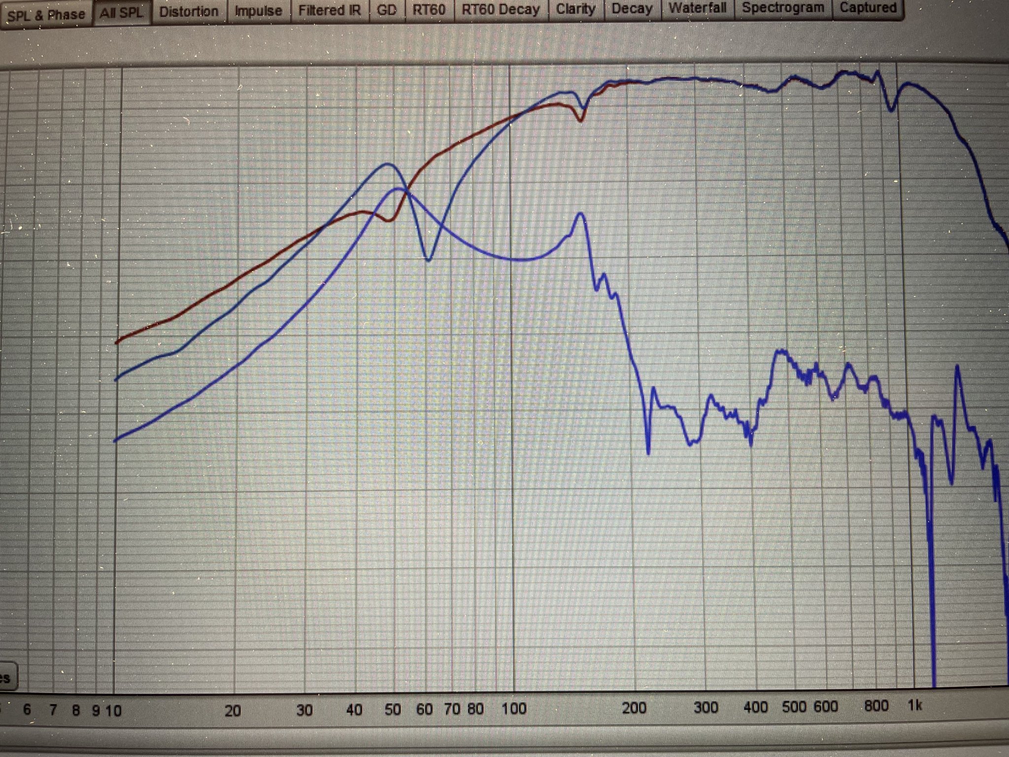

OK, so I went out and bought a piece of 4" ABS to play with port tuning, and I also played with some fill in the cabinet to tame that 150hz resonance. I took sweeps at 34hz, 38, 40, and 42, with and without the extra damping. Below is a graph showing the NFwoofer and the port tuned to 34hz with damping, and the summed response using trace arithmetic in REW. I'm shocked at the difference, and that the 70 hz null has disappeared. I think what might have happened is that in the earlier measurements I used the Alignment Tool and summed the two there after reducing the port by 6.4db. I think Trace Arithmetic is the correct way to do it, as I was advised. I'm nervous about the 8db rolloff from 200hz down to 34, but hopefully I can compensate later with some baffle step work? Here's the graph:
