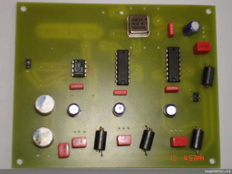

I have realized a CI for the CD/DVD drive with a SPDIF output .
Have a look at the three fotos .
The CD on the foto is an ASUS CD 520 and the CI is a "low cost" version.
7805 regulators .
Standard oscillator,
Standard capacitors.
The 12v is connected on the CD connector .
A best version would be :
low noise regulator ( AUDIOCOM ....)
TENT oscillator
OSCON capacitors
An independant 12 v
A custom version ....
You put what you want and what you have the CI is very large ....
If you have any questions ...
Serge
75 Ohms ?
You have different solutions on the CI .
The RS 422 drivers has TX+ and TX- outputs so you can have a differential link .
You can put a resistor between TX+ and TX - ( on the CI ) .
I use only the TX + with a resistor connected to the GND .
:bigeyes:
On my DAC i have the same RS 422 Drivers .The shema is the same than
this circuit ,The TX + and TX - outputs are directly connected to the CS 8414
Serge
