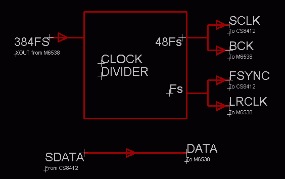

Tekko said:
You men that i connest SCLK on the 8412 to the clock on the dac M6538 ans pcm67 and use FSYNC as spdif input ?
No.
