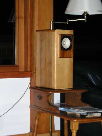

I have made similar mistakes on projects in the past. You could cut a port in the side by plunging a saw into the cabinet. Make the correction. The baffle pannel will now be a bit too small due to the saw cut. Find a nice piece of contrasting wood to make a patch out of and glue over to top.
Here is a picture of an accent design i did a few years ago.
