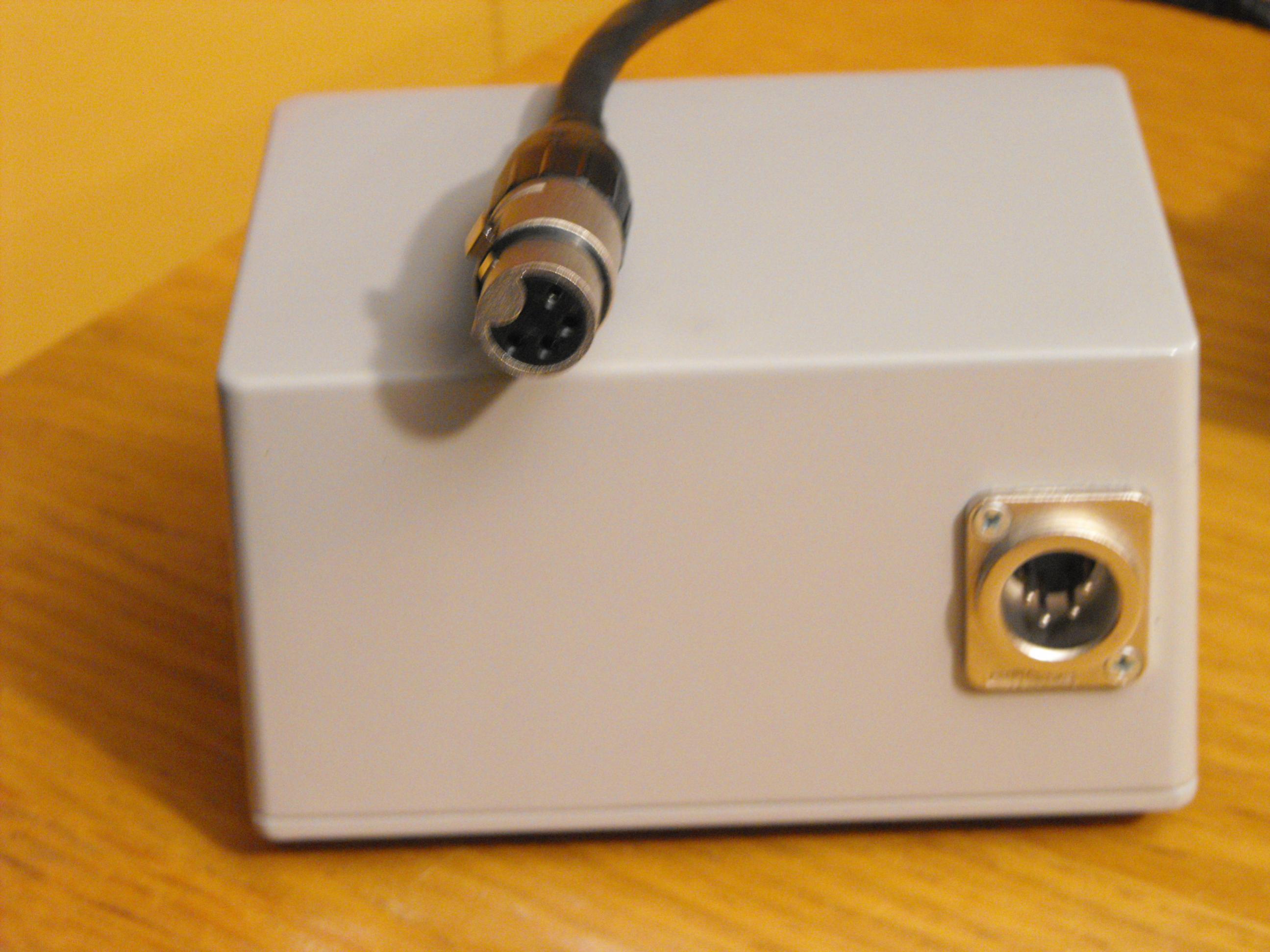

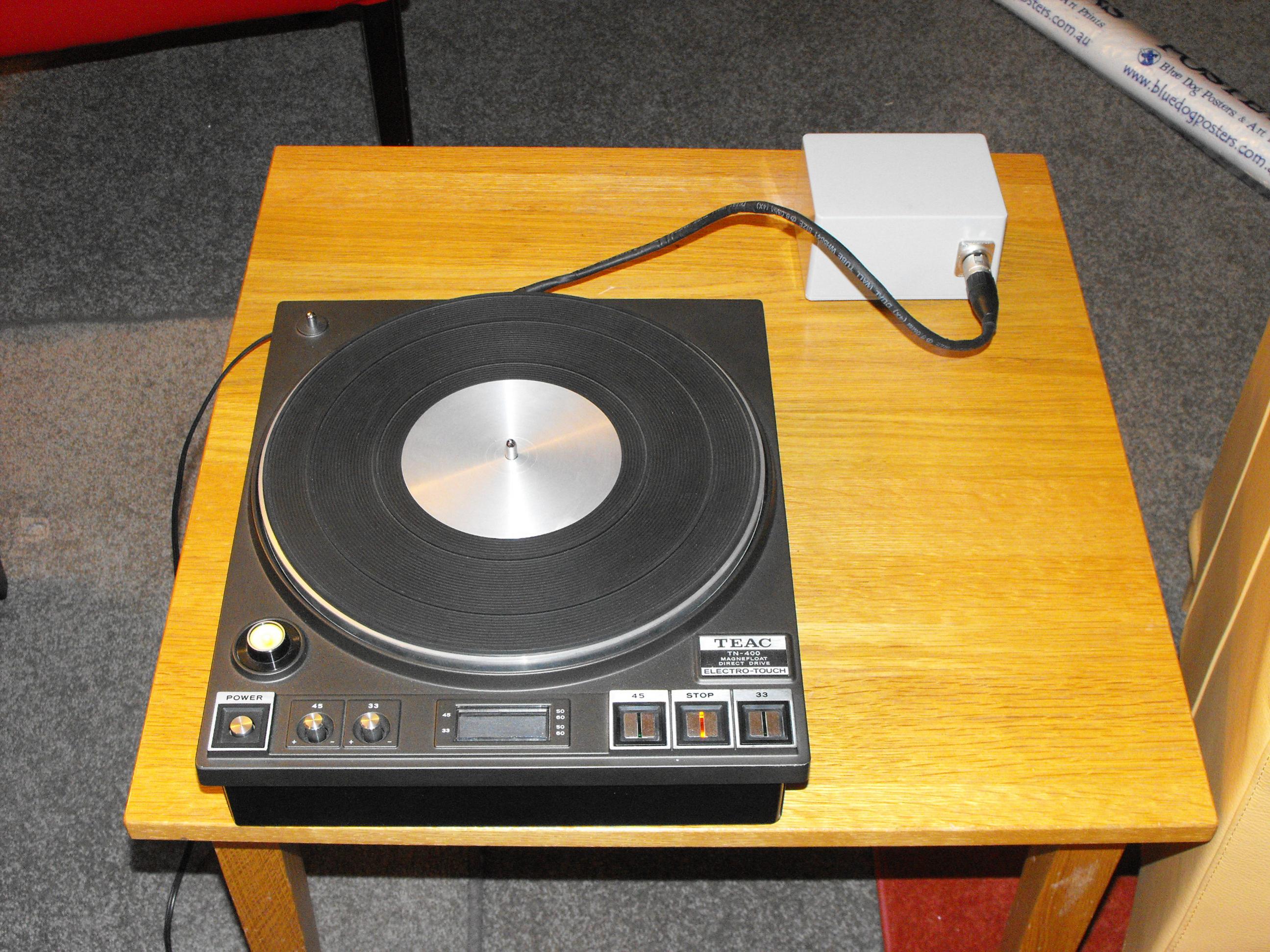

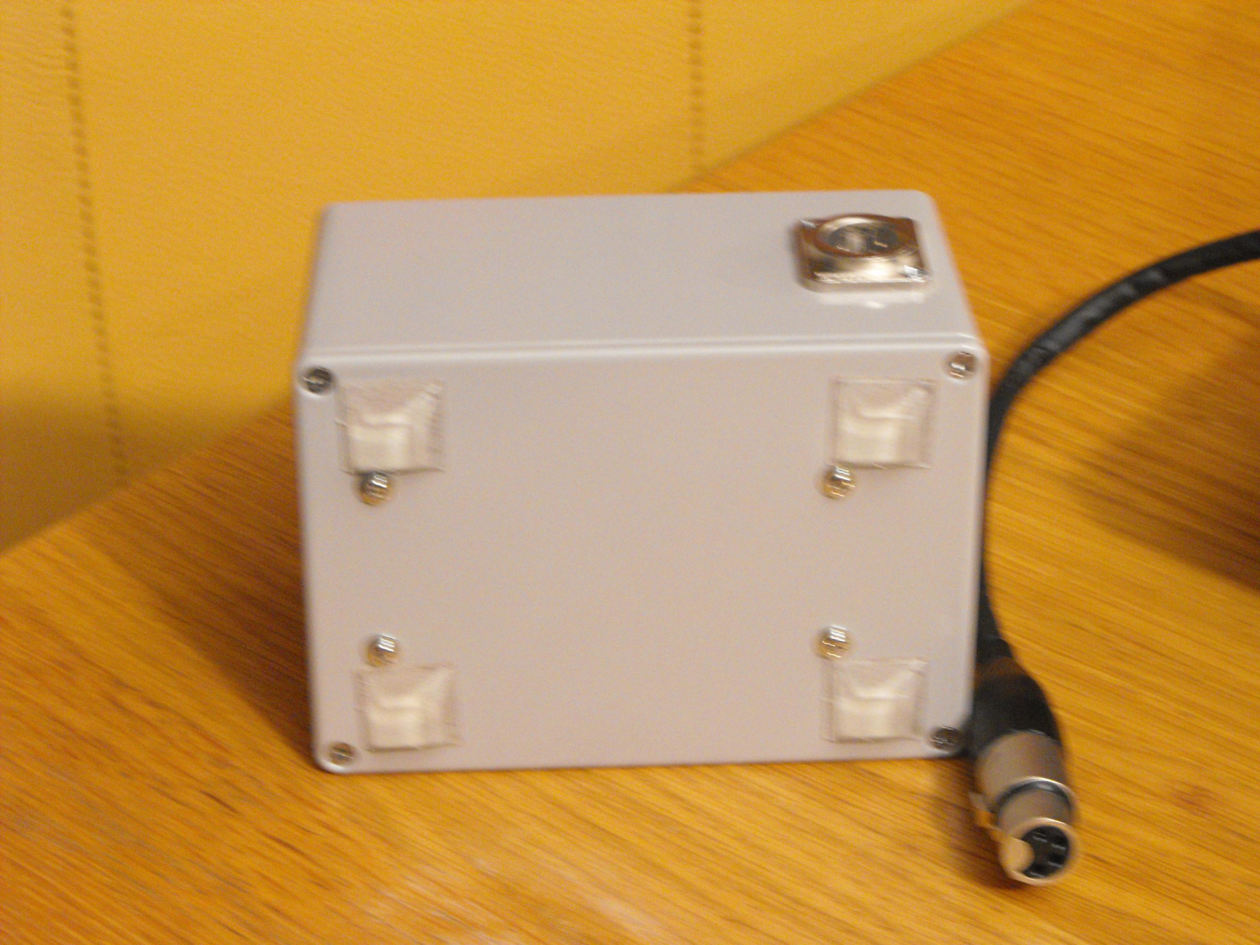

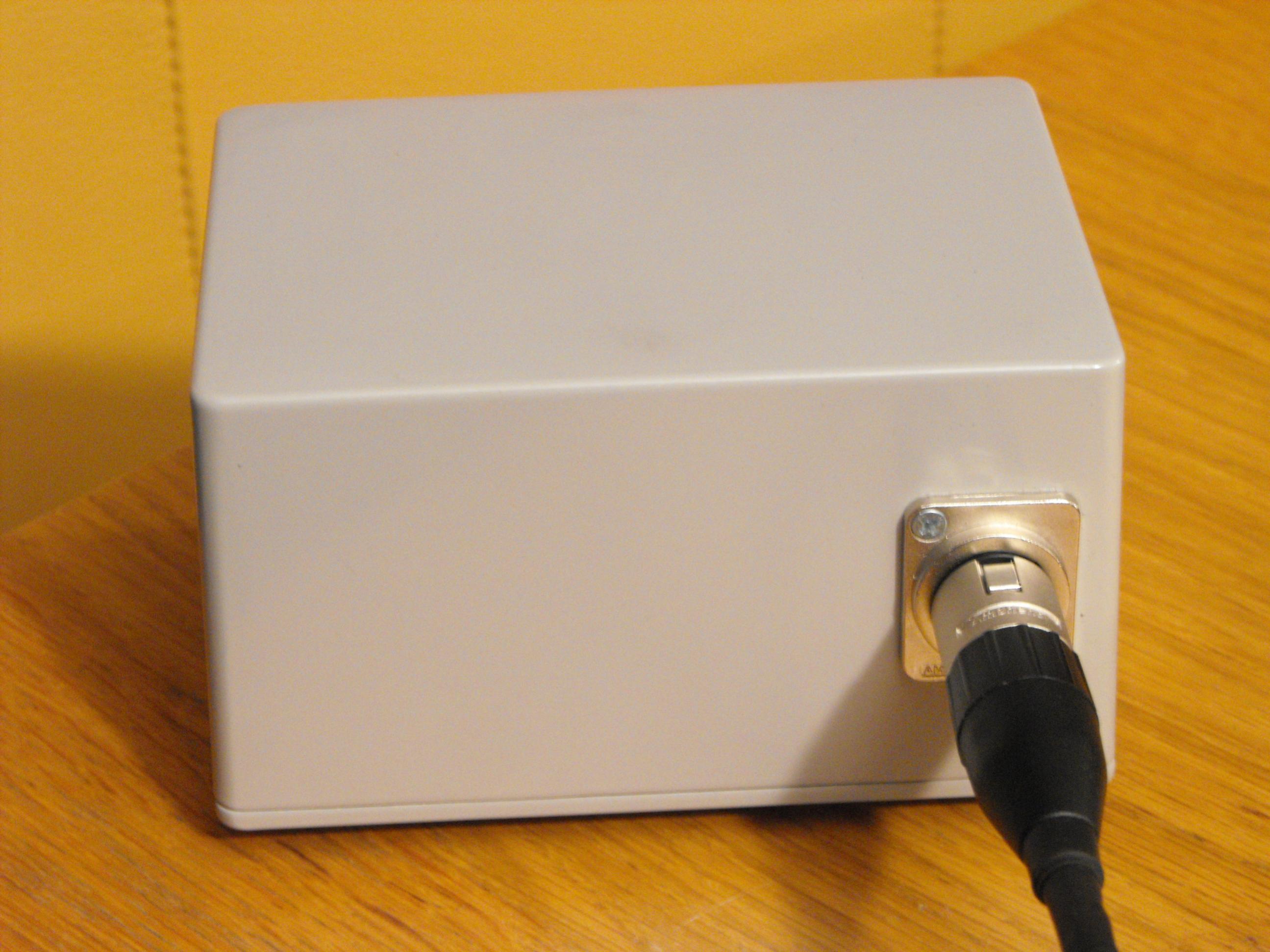

You might want to remove the transformer from under the Teac chassis. It removes a source of electrical hum and mechanical vibration and further, allows the chassis to sit flush on the base of the plinth for improved damping. The transformer is placed in a screened metal case and triple decoupled by the existing internal grommets and rubber feet.
Buy General Purpose Enclosures Enclosure,metal,aluminium,diecast,black,125x125x75mm Hammond 1590KBK online from RS for next day delivery.
A 4-wire umbilical connects the transformer primary and secondary to the turntable through a 4-pin xlr. I made the umbilical long enough for the transformer case to sit on a seperate shelf. The existing mains cable is left in place.
Sounds like a great idea. For the minor amount of work and parts, I'm sure it provides a reasonable improvement.
