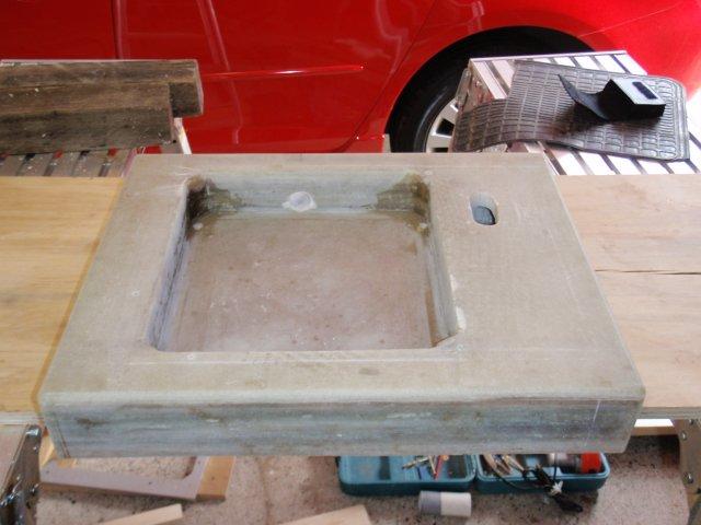

Revive the SP10 mkII plinth thread. My experience.

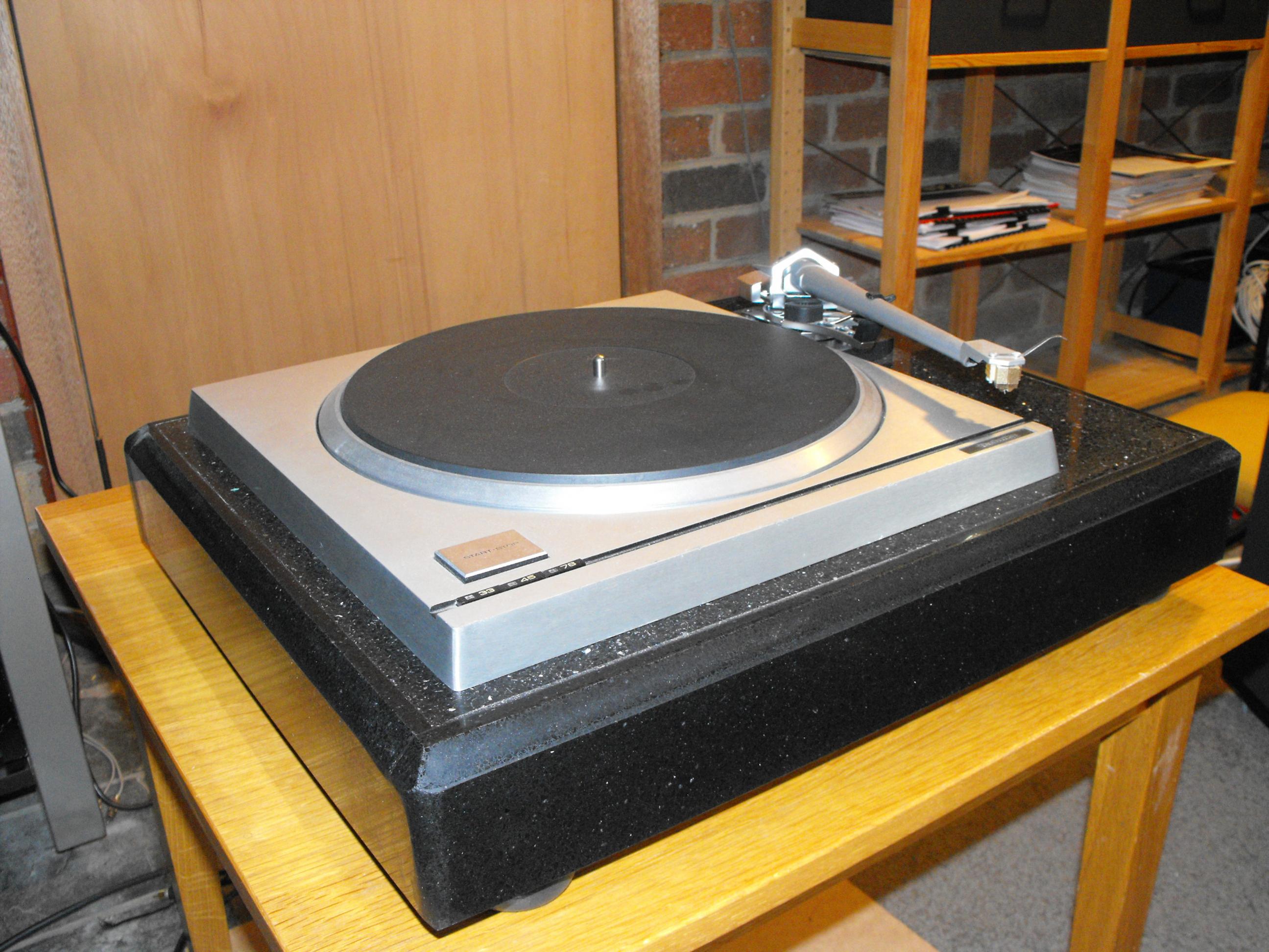

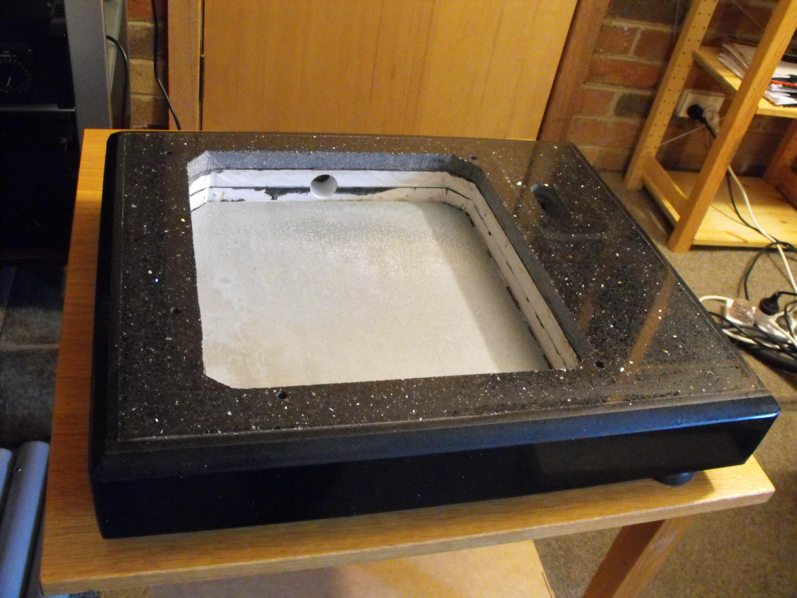

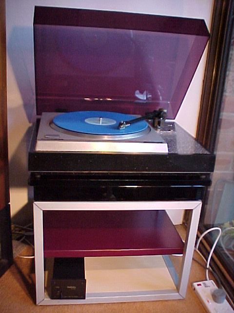

I recently found this thread and thought I might contribute my experience. I have an extensive background in vinyl replay systems. I owned 2 Garrard 401's in the early '70's and a Linn LP12 from 1975-2003. In between I have owned various Thorens, and currently I am re-plinthing a TD125 mk1. I have owned various tonearms including Decca International unipivots, SME 3009's, Stax UA7, Rega 250, 300, Michell Special 250, and currently 2 SME IV.
Since 1999, my table of choice has been the SP10 mk2. All of my previous tables have been plinthed by me and I feel I have learned a fair bit of useful information about materials applied to plinth systems. To cut to the chase, the three important parameters for a plinth are mass, stiffness and damping. Of these the hardest to get right is damping.
http://qualia.webs.com/dampingfactor.htm
It is best to use materials inherently well damped rather than apply a damping treatment. Densified wood (Panzerholz etc) measure well for all three parameters but it is almost unobtainiun in my neck of the woods and incredibly expensive. I have built SP10 plinths from timber products, engineered stone, Corian and finally, isopthalic fibre-reinforced polyester resin.
http://qualia.webs.com/apps/profile/71866842/
The resin plinth is the best so far but is extremely time and labour intensive to produce. The ply fibre layers are laid down in resin over days. The curing process generates considerable heat, so cannot be rushed.
http://qualia.webs.com/apps/forums/topics/show/3538558-polyester-resin-and-bentonite?page=1
Regarding some of the comments from previous posts, in my experience, for mechanical systems (cartridges, tonearms, plinths, loudspeakers), the better the damping, the more natural is the reproduction. Less well damped components can sound exciting, snappy and vivid, but long term critical listening usually reveals an unnatural quality. For example the SME V/IV tonearms are sometimes criticised as boring, but they are just accurate in my experience.

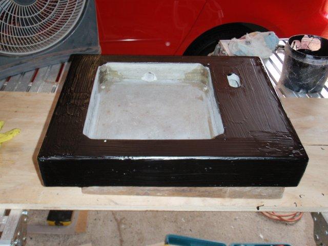

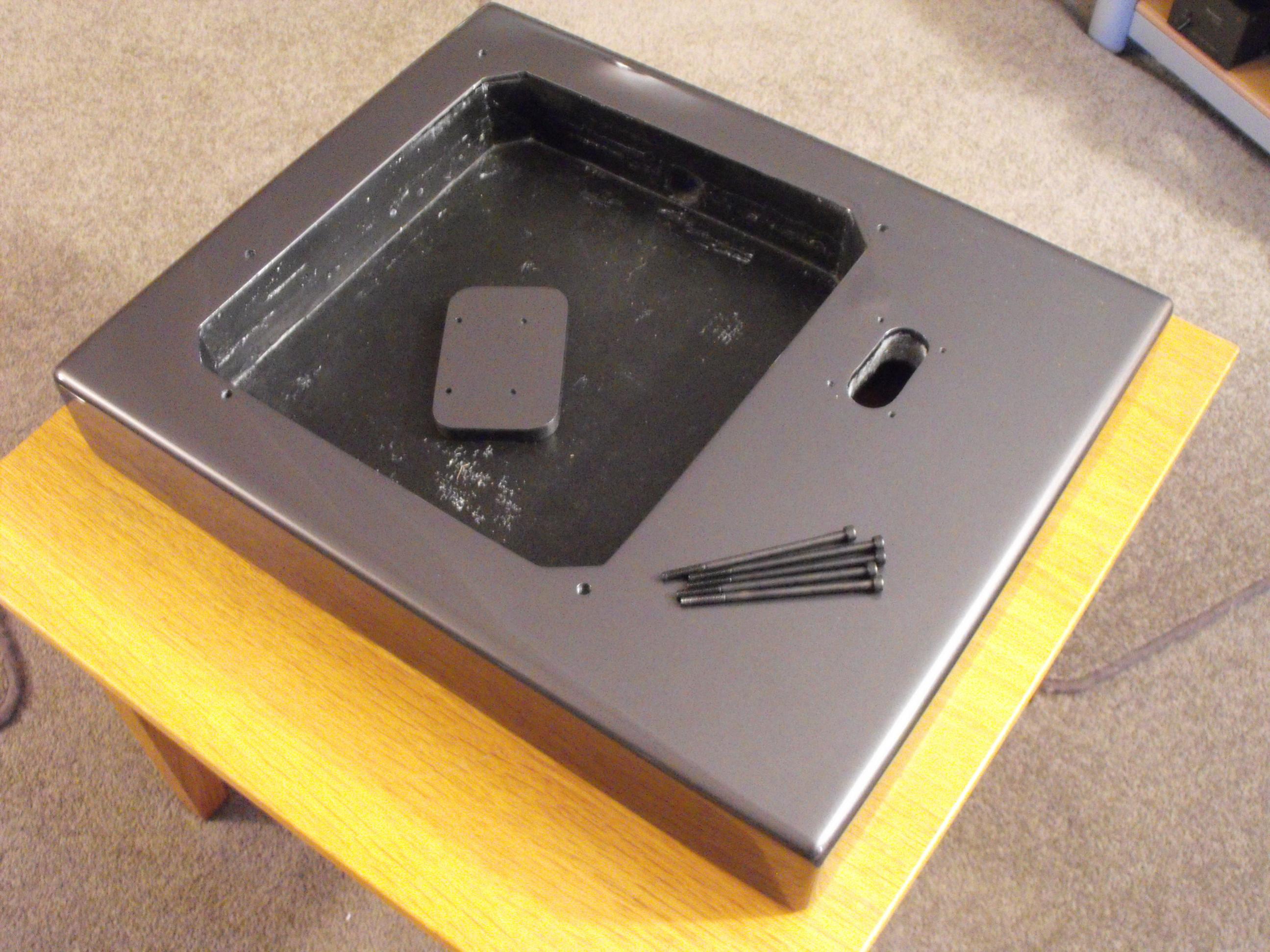

Hi Steve. My first serious SP10 mkII plinth was the Corian one in around 2000. I discovered the "bearing drain" back then and the TT is bolted through the full thickness and pulled down so that the main bearing is clamped down onto 2 layers of 3 mm lead sheet lining sandwiched with the plinth base. This lasted for ten years when I acquired an SME IV to replace the souped up Rega RB300. The higher resolution of the SME lead me to construct a new plinth from an engineered stone "Caesarstone" commonly used for kitchen benchtops. The resulting plinth was massive (34 kg), stiff but poorly damped by empirical tests. I managed to tame the 20 mm thick base by applying constrained layer damping to both surfaces of the base, with two 3 mm aluminium sheets sandwiching the engineered stone with a polyurethane damping layer on each side. This was an improvement. I discovered the audio qualia site and have a good friend and fellow SP10 mkII owner, who happens to be an expert with fiberglass resins. We did some empirical tests and were very impressed with the results. We went forward with the resin/fiber SP10 plinths, which required mold construction and working with quite toxic materials. A surface filler compound is applied and then sanded to very flat finish. Then a high quality auto spray coat is applied. The results justified the effort. The mass is approx 18 kg. Total thickness is 90 mm. Stiffness is beyond reproach and damping excellent. Where I notice the improvement is firstly in human voice reproduction. It just sounds so natural with the SME IV and various moving coils. All frequency bands are as good as I have experienced in my system and listening room.
As for removing the parts from the chassis, I have always removed the brake. I have three SP10's, two in use and one spare. I have been toying with removing the chassis from the spare and installing the parts in a resin/fiber plinth. Just an idea at the moment. If I carry through results will get reported here.

Concrete does not work, though I accept that experiment with various strength of mix, sand types and sizes and interleaves of varying types may just find a golden mix!
I have found that solid welsh slate interleaved with alloy sheet does an excellent job. But I stripped my SP 10 of its electronics and placed them out-board so that only the motor is plinth mounted. I also use a bearing sink and got rid of all brakes etc back when I ran the motor with backplate in the official Technics all-Obsidian plinth.
The fiber/resin is more than just a cosmetic finish. Go to the audio qualia link in my original post where damping is extensively discussed. In fact I have tried concrete plinths when I knew much less than now, way back in the early 1970's on a pair of Garrard 401's I bought new. The plinths were very heavy and stiff but again poorly damped. The 401's sounded terrible in these plinths. It put me off idler drives. My experience has convinced me that concrete is a very poor material for plinths.
Just think of how sound transmits through a bare concrete floor or wall.
The engineered stone has a significant resin content (5-10%) but this still needed double constrained layer damping.
To kick this thread along some more, here are some of my thoughts on plinth construction and materials. These comments are addressed to the SP10 mkII, which is the DD I know best. My best effort over a 15 year span, is the fiber/resin plinth. Approximately 60 layers of chopped glass fiber are laid down in resin as 90 degree ply layers, a few layers at a time, and left to cure between layers. The curing process generates considerable heat, and there is a risk of heat damage and even fire if too much resin is used at one time. It takes about 2 days to lay down a complete plinth in a mold with the recesses built in (you don't want to cut or grind fiber glass, believe me. The fibers are very hard on tools and the dust horrendous). I came on the polyester resin when I noticed that the dried residue in the bottom of tins, was very hard yet did not ring when chiseled it out for test. This got me thinking and an ... aha moment. With the fiber re-inforcing, it is a very good material, though slow to work with.
Now here is some speculation as to why this type of plinth (laminated layers in a damping matrix) works well with good high torque DD. As has been pointed out earlier in this thread and elsewhere, torque reaction has to be dealt with. Assuming perfect motor and bearing for the moment, with the concentric motor. all turntable induced motion should be in a horizontal plane, including the torque reaction. A layered plinth is perfectly configured to dissipate the torque reaction as shear in the damping layers. This may have some bearing on the popularity of layered baltic pine plywood and certain slates. I have never used these materials for plinths or listened to them so I have no first hand experience of their performance. However, my comments do rely on effective damping layers and in the baltic ply, this is the glue. I'm not sure what natural adhesive is involved in the slate. An added bonus is that a layered material also acts as constrained damping, and will convert vertical vibration from non-perfect bearing and motor, to shear in the damping layer and be dissipated.
Getting back to the SP10 mkII and the effect of different platter masses. Now Technics warn severely against using the motor without the platter. Any observations about the motor behaviour without the platter, are to be discounted IMO. However, Technics do discuss the SP10 mkII performance under an extreme overload, which implies the SP10 mkII is perfectly happy with platters of greater mass than the stock 2.9 kg. One of the photos in my first post shows the SP10 mkII in use with a copper/carbon fiber mat. I use this in conjunction with a peripheral ring and a 850 gm record weight. The total extra weight of these is exactly 5 kg by my scale. Total platter plus extras is 8.9 kg. Since I have 2 SP10 mkII in use, I connected a splitter for the wired remote control switch I possess, so I could synchronise switch on and observe the time to visual stabilisation for the 8.9 kg mass versus the standard 2.9 kg plus rubber mat and clamp.
There was a minor difference to speed stabilisation (about 15% from my recollection) which is not surprising given the much increased moment of inertia), but an increase from 25% of a revolution to 30% is not an issue for me. Not all DD's are equal though. The same test on an SL1210 showed a much longer time to speed stabilisation. The SL1210 motor has noticeably less torque. I think Technics got the control system for the SP10 mkII pretty right. A well designed control system is insensitive to a wide range of parameter variation. For example, a large passenger airline must behave approximately the same in controlled flight when fully loaded with fuel, passengers, and cargo, as when unloaded and low on fuel. This is part of the design and is quantifiable.

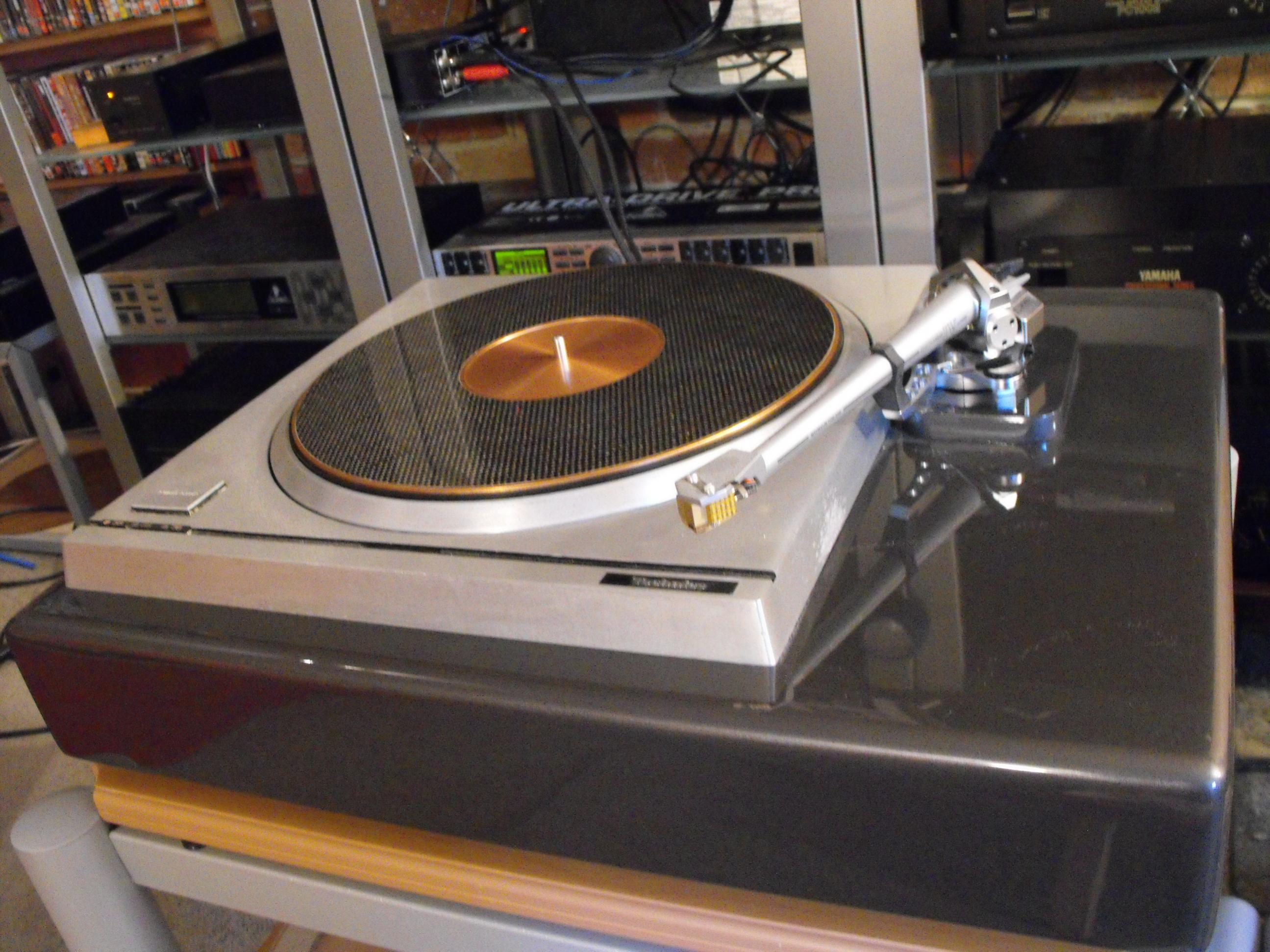

It has been a while since I took the SP10 mkII down from its perch amidst the other audio gear and parked it into a shelf on a rack in my study/computer room. In that mean time I have been enjoying the TD124.
Above photo: #2729 standing in slate. Zeta tonearm with vdh silver wire in an Incognito made harness. A Denon DL-103R mounted within a Uwe Panzerholz body...and with SoundSmith Ruby cantilever/fine line stylus. Sends signal into a pair of Sowter 1:10 step up trannies. Then into a Wright WPP100C phono preamp (with adjustable gain pots).
At this point I consider the TD124 a more enjoyable deck to spin vinyl on than I did the SP10 mkII.
It may not be fair to describe the SP10 mkII as being audibly inferior to the Thorens. All I did with the SP10 mkII is observe that it appeared to be 100% operational and then build a stacked-layer baltic birch ply plinth for it to mount into. Stuck it in the plinth. Mounted the same arm/cartridge I'd been using on my Thorens to the Technics. I used the same step up trannies and phono stage as with the Thorens. With that much in place I simply began listening to vinyl for a couple hundred records or so. A few months worth.
