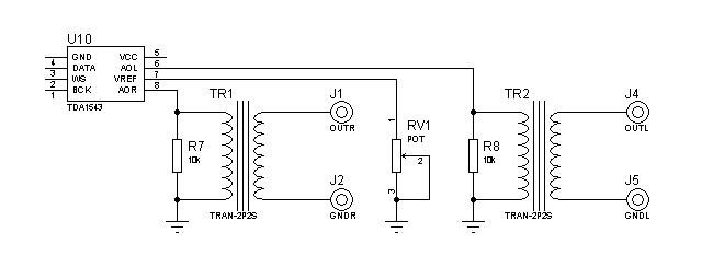

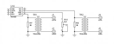

Hello all.
I've built a DAC based on a CS8412 and a tower of TDA1545 (8).
I was planning to put a transformer I/V stage with a Sowter 8347.
All is working when I put just one transformer on one of the TDA1545 output but no sound when I put the two transformer on the two channels !
Is somebody have tried this before ?
I think that Audionote have made the same thing.

Thank you for your replies all.
The thing I do not understand is that when I just connect one channel output of the TDA1543, all is working. Tight bass, clear high, really sound great ! But, with the two channels output connected (so the two transformer connected at tht two TDA output) no sound at all ! Just noise ...
The Sowter site says you should use a 25Ohm I/V resistor. Mu metal trafos are very sensitive to DC, which should explain the noise. But it doesn't explain why it works when only one channel is connected.

Eight TDA1543s are 200mA. That's quite a lot.
If you are going to use DC blocking caps, try use 2k2 as I/V and 220k or more after the caps.

I was wrong about the 200mA. Should be 20mA!
Anyway, I don't think the transformers can handle more than one TDA1543.
Sowter says:
PEAK SIGNAL CURRENT (with 25 ohm resistor): +/- 2.0 mA
The Burr-Brown PCM67 (one of the DACs the transformers were designed for) datasheet says:
ANALOG OUTPUT: Output Range (±3%) 1.2 mA
The TDA1543 has about twice that.
Sowter says:

I'm sure you have wired the transformers...
in the correct way???

Transformers wired in correct Phase???
I wired mine out of phase and got noise as you did.
It was a simple error on my part but everything worked well once I got it right.
