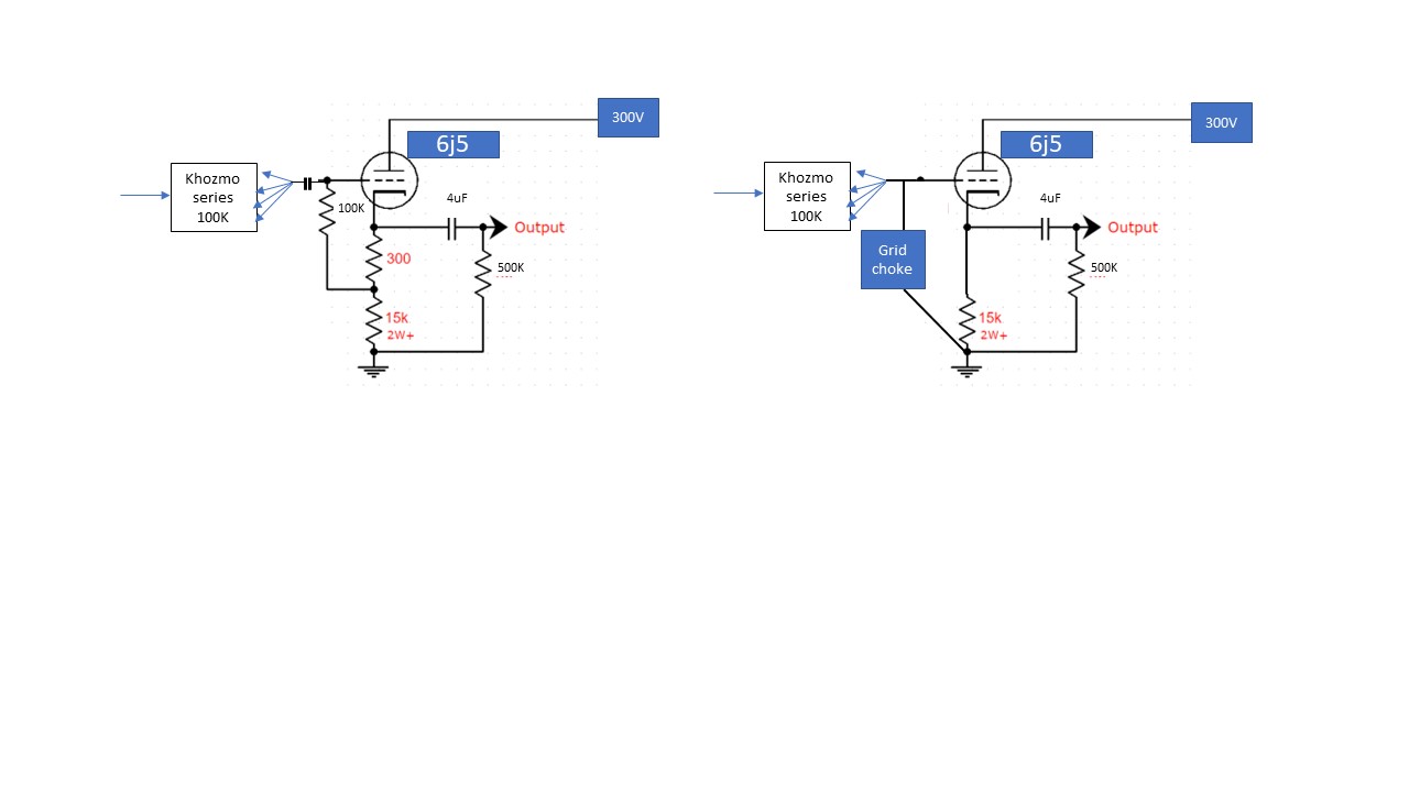

1. Disconnect the bottom of the 100k resistor from the junction of the 300 Ohm resistor and 15k resistor.
2. Connect the bottom of the 100k grid resistor to ground (the bottom of the 15k resistor).
The clicking should be much quieter.
Right?
Not sure what you mean?
The resistor values I still have to determine further but the schema is as I build
The stage pictured will have 50-100V DC (depends on the B+) at the input, and you're basically short-circuiting those volts to the ground with the TVC secondary.
You either need to add DC blocking capacitor to the input of this stage, or leave out the 15k resistor and connect cathode and grid resistors directly to the ground.
Need to finetune the resistor value but these are the variants I will try (already have grid chokes lying around) Khozmo I have ordered

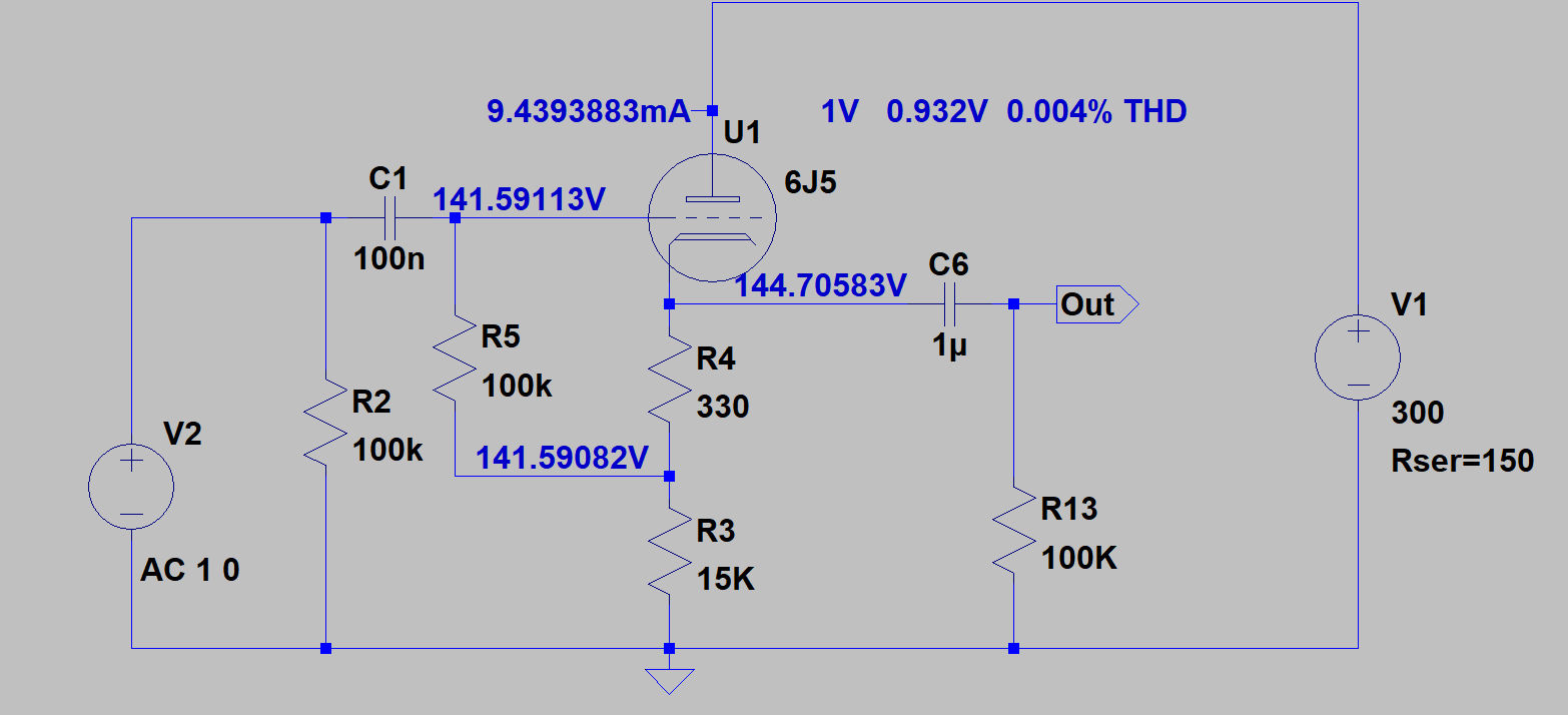

If the transformer can not drive a 100k grid leak resistor, then it probably can not drive the capacitance of the 6SN7 grid either.
The coupling cap to the grid needs to be picked according to the grid leak resistance.
And, yes, the effective grid leak resistance is multiplied by the bootstrapping effect.
The slightly different voltage across R5 is due to either one of 2 things:
A. The grid of the 6SN7 is leaky / or has contact potential.
Or
B. The non-repeatable variance of the measurement (too many places is like too many cooks spoiling the broth).
Some averaging may be in order.
I have just changed the setup the 100K is now 1 meg and the C1 is indeed 0.1 uF
