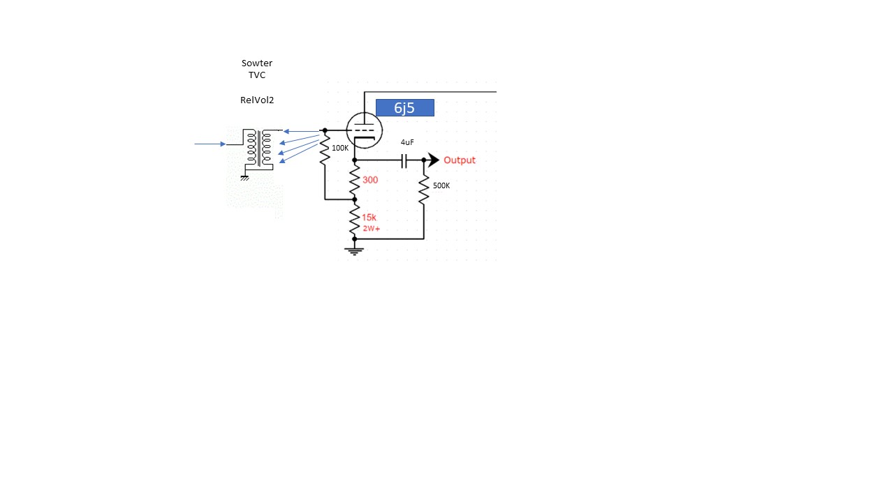

My recent build is a SRPP pre-amp which has too much gain for me so I will probably rebuild it into something like this Muchedumbre Buffer Preamp – wauwatosa tube factory
But I think with two halves of the 6sn7 I am using in the SRPP
Now my question is as follows:
- I use Sowter 9335 as volume control
- Switching is by relays kit from Dantimax, this works fine
- However there is a lot of hard noise while switching, really annoying. Is this because of the high gain? Or because of the relays?
- Also do I still need a grid resistor after the Sowter?

With "grid resistor" do you mean grid stopper or grid leak resistor? Grid leak: yes.

Pretty sure the Dantimax kit does not use make before break. So what happens at the switching moment. Probably the + / live secondary of the TVC is in between the taps. The secondary common / grounded wire stays always connected to ground

Inductors (including TVC) don't like to suddenly became open-circuited, just like capacitors don't like to suddenly became short-circuited. Hence you do need make-before-break switching with TVC.
RelVol2 doesn't provide that indeed - there is a thread here on diyAudio with people angry for that reason, even with resistive attenuators.
What you can try though is putting another resistor of several hundred kOhm across the whole TVC secondary (between the "max volume" and "ground" taps).
BTW, where is you grid leak resistor located exactly - "after the Sowter" as stated or after the relays close to the tube grid, where it should be?

Is it possible that your signal source(s) that drives the Sowter 9335 has a DC offset voltage?
Even a small DC offset voltage into a transformer volume control, may cause noticeable transients whenever you switch to different attenuation levels.
Some sources of DC offset voltages are direct coupled IC op-amp outputs, leaky coupling caps, etc.
Measure the signal source output without a load.
Any DC offset will become a current into the transformer input.

I just checked and the same tick is there without a source connected. So I guess this is not the issue
Yes sorry for the confusion I meant after the RelVol2 and just before the tube gridsBTW, where is you grid leak resistor located exactly - "after the Sowter" as stated or after the relays close to the tube grid, where it should be?
Would the value of the grid resistor change anything? I will may be experiment a little

Erm...
If your schematics is correct and complete, I wonder why clicks bother you and smoke doesn't 😎
The input of the stage pictured is waaaay above ground.
