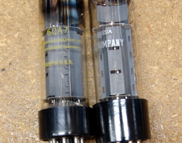

Recently I purchased a bunch of different brands of EL34's from a major US tube and component supplier. I tested and evaluated them for use in an upcomming amplifier project. I got 4 "Winged C" tubes, one was sick out of the box (several screen grid wires glowed at 300 volts) and one has since developed a runaway condition. None of these tubes were subjected to my stress testing, because they misbehaved at 300 to 350 volts. I don't know where or who actually made these tubes, but I don't want to buy any more of them.
Below is a picture of two tubes. On the left is a Penta Labs 6CA7 (I thought they were EL34's until I dug one out of a box) It is labeled "The Penta Laboratories Inc Santa Barbara, California MADE IN USA". I bought about 10 of these several years ago, all blew up! On a different note this is a 6CA7 and it is a true pentode, not a beam tetrode. That has been debated here several times, but the only beam tetrode 6CA7's that I have ever seen came from Mr. Mathews! (EH 6CA7)
On the right is an "Orion" EL34. It is "Made in Russia" I have seen the same "stuff" with several brands on them including "Star" I bought a bunch from a prominent Ebay seller in Hong Kong. The 6L6GC's (6n3C) work good, but the EL34's were so poorly assembled that I never tried them in anything that would tax their abilities. It is not obvious in a reduced resolution photo (to fit the file size limits) but the grid support rods are all bent, in different directions. The G3 rod has an "S" shape to it with several mm of curvature. All 3 grid rods and the cathode can be seen through the holes in the plate. They should all be in the same plane and G3 should be the only one visible. Would you want to crank 500 volts through one of these? I may try it just to see what happens.
I have always regarded Penta Labs to be nothing more than a glorified relabeler despite their claims otherwise.. Perhaps that is a bit narrow minded. 😉 My experience with their tubes has been disappointing.

I found this on Pentas web site. I guess that this means that they either have "their own" plant in Shuguang, or they ues the same one that makes the Sino and Valve Art tubes.
"Penta / Shuguang is our brand of Vacuum Tubes Manufactured at our plant in Shuguang, China"
The 6CA7's that I got are at least 10 years old (I have had them that long) and they were surplus when I got them.
