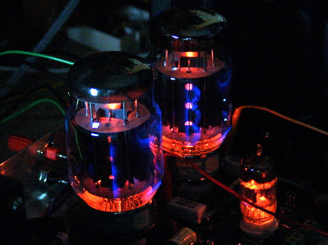

Below is a picture of two EH KT88's operating at 45 watts of dissipation. Yes, that sounded like a lot in my earlier posts. It may not be evident in this photo, but there is No glow on the plate or screen grid at this power level. There is a lot of harmless blue glow. This happens in all of the EH 6550's and KT88's. The blue pulsates with the music and puts on quite a show in a darkened room. In fact, I have modified the front panel in my latest amp to include a Lexan window to view the show. It is better than reality TV.

Quick update:
I wired the big Antek toroid into a SimpleSE in place of the original Allied power transformer. I wanted maximum voltage (and there is no 5 volt winding) so I selected the solid state rectifier. B+ is 530 volts under 200 mA load and 565 volts unloaded (not healthy on my 500 volt electrolytics). There is 470 volts across the tubes (EH KT88's). With the 560 ohm cathode resistor the current is 90 mA. No smoke, no sparks, no glowing tubes, just loud clean music. A lot of headroom with this much voltage (and a 5K load) but I haven't measured power yet.
I ran the amp for about 1 hour. The transformer made no buzz, and did not even get warm. The tubes remained calm, did not glow or arc, the blue glow danced around the glass in time to the music. I even flipped the triode - UL switch at full power several times , with no ill effects. I will test again at a higher current tomorrow, and "test" the 6L6WXT's.

sounds excelent, I am for sure going to get a pair of those in a few weeks (EH KT88s), any Power output readings for the KT88 in Triode or Ul mode? if not, what do you predict?
keep on rockin'
-Moose
Running KT88's at 500V odd at 90mA per bottle at 5K load should give 50W+. These conditions are close to those used in the orig GEC 88-50Watt amp. SHould be a breeze.
Except that this is a SE amp, 50W+ in SE requires an 833A. I will measure it sometime this weekend. 530 volts is really too much for this amp since I have 500 volt caps soldered into the PC board already, and that is about the highest voltage caps that will fit. Even still, I have been listening to it all morning (it is raining again).
