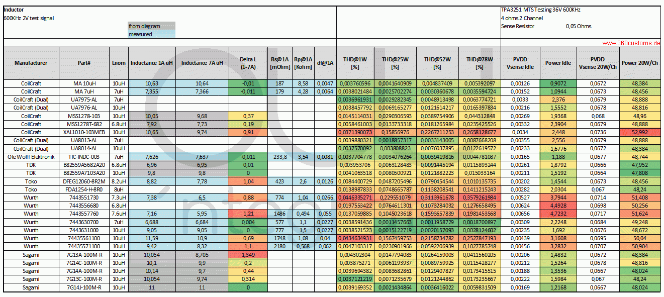

Nonsense again. No need to recommend Lloyd Dixon to me, I know and appreciate his contributions for ages. A simple physics textbook will tell you that you are wrong. Following your logic, by reducing the size of a core we get the smallest losses. Brilliant! You are really funny!
For TPA32XX amps, inductors make a difference...
Flat wire inductors perform better.
Allo has spent a lot of time in their R&D to develop new air core type inductors for the next TPA3255
The Topping PA5 is using great inductors, you can see the ASR review so you can understand how it performs so good.
For any Class-D amplifier the inductors make a (huge) difference.
In fact, it's one of the most significant distortion factors inside a Class-D amplifier.
Sadly enough a lot of developers don't seem to realize this and use either inductors that are to small (read: saturate to soon), or even use iron powder inductors, which saturate very soft, but very early.
