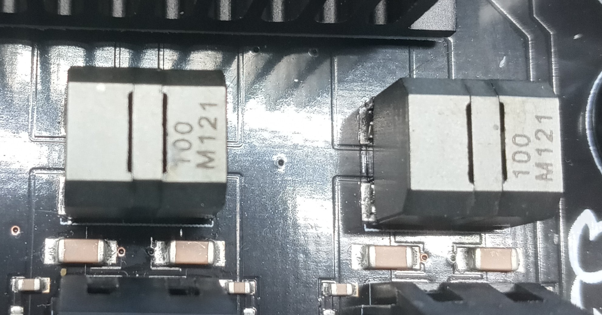

Anyone know the source of these "no name" inductors? I'd like to upgrade them, but need the pad footprint dimensions. These are from a 3116 based TinySine TSA7800B amplifier (LINK). They're dual coil inductors and have approximate dimensions of 10 mm X 9 mm. It's hard to get an accurate measurement due to the nearby components. Any information appreciared.

Bingo! I looked up Sagami and my inductors look like their 7G09B/H inductors. Or perhaps a knock-off of the Sagami. ThanksThey look like Sagami?
Could also be Murata. But what do you want to upgrade?
When testing this amp I noticed the 3116 goes into fault mode when driving all channels at >25 W per channel using 4 ohm loads. After doing more testing and some reading it seems that the inductors going into saturation is a likely cause. I was hoping to find some information on the inductor's specs to see if that made sense. I highly doubt if I will change the inductors though: First, I don't like to drive a 3116 beyond 25 W per channel due to increasing distortion. Second, it would be a real challenge for me to remove the inductors without damaging the board. I'll concentrate on the "low hanging fruit": replacing the SMD output caps with MKS poly caps. I'm capable of that. 🙂
With a saturation current about 5 amps these inductors are working at the bleeding edge with 4 Ohms load - for 8 Ohms they would be suitable imho.

I not shure, if these fruits are very sweet 🙂 . The MKS poly caps have lower series resonant frequencies than the 1206 X7R capacitors (if I have identified them correctly in the picture). Are you shure, that the inductances areg oing into saturation? If so, their effective inductance would be lowered and their filter function would be partially lost. How does the amp detect inductance saturation to show you a fault?When testing this amp I noticed the 3116 goes into fault mode when driving all channels at >25 W per channel using 4 ohm loads. After doing more testing and some reading it seems that the inductors going into saturation is a likely cause. I was hoping to find some information on the inductor's specs to see if that made sense. I highly doubt if I will change the inductors though: First, I don't like to drive a 3116 beyond 25 W per channel due to increasing distortion. Second, it would be a real challenge for me to remove the inductors without damaging the board. I'll concentrate on the "low hanging fruit": replacing the SMD output caps with MKS poly caps. I'm capable of that. 🙂
Which supply voltage do you use? They specify 18 to 50W with 10%(!) THD, depending on the supply voltage. If they are using the same coils for the 100W output, I would wonder how they managed to get 100W on 2R with 1% THD, assuming the coils already sature at 25W at 4R.
The chip detects the sharp rising current in case of saturation. MLCC output caps are poor design and will add distortion.How does the amp detect inductance saturation to show you a fault?

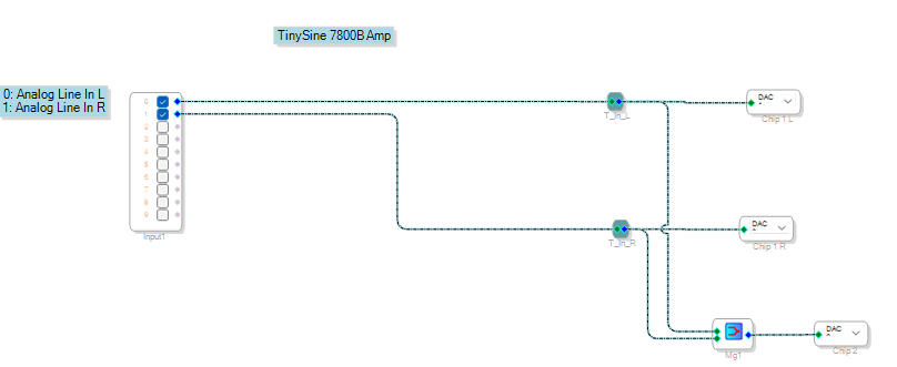

I should mention that the amp has an ADAU1701 DSP. I replaced the vendor's program with this "straight thru" program to remove any DSP signal shaping.
