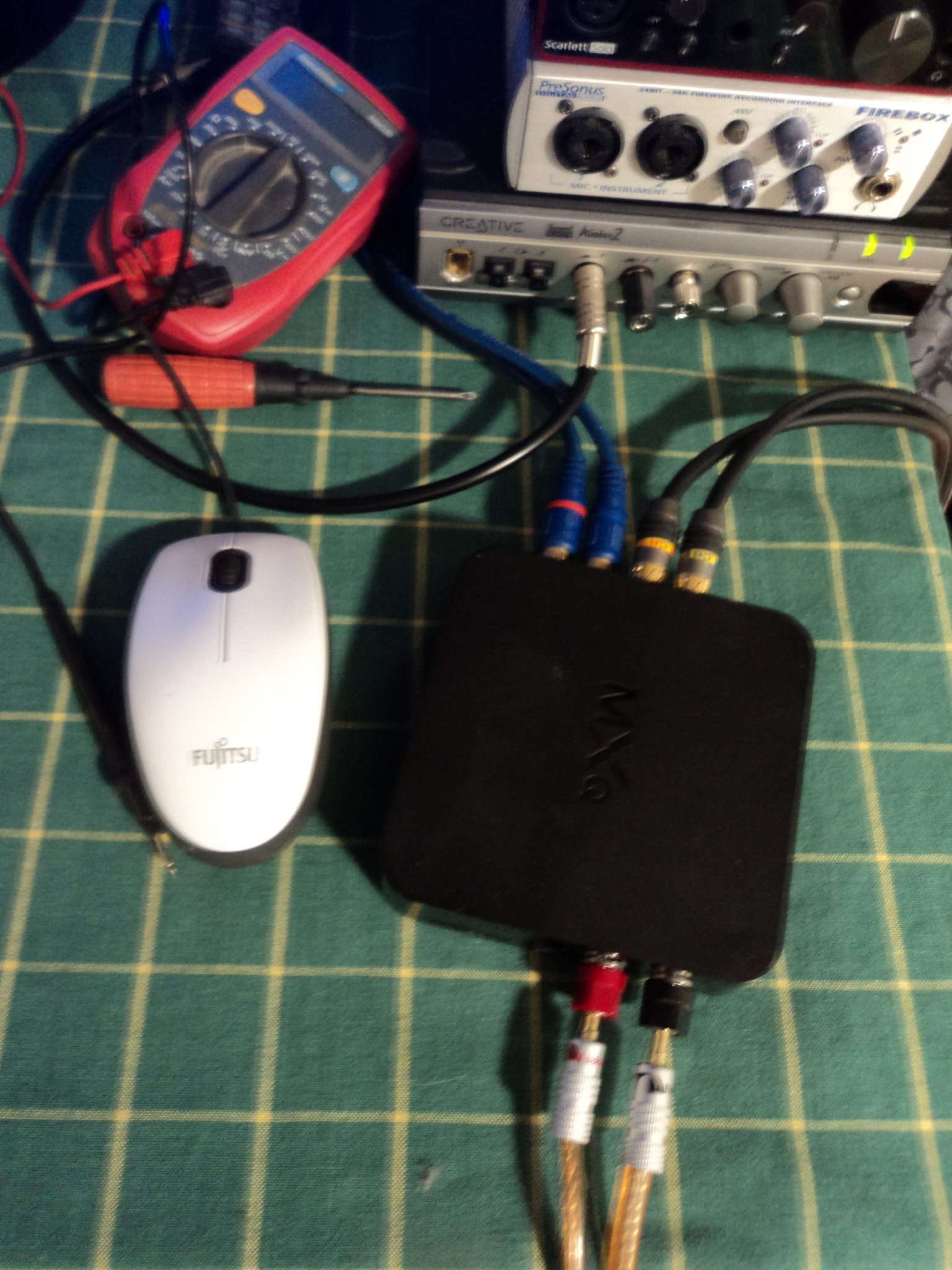

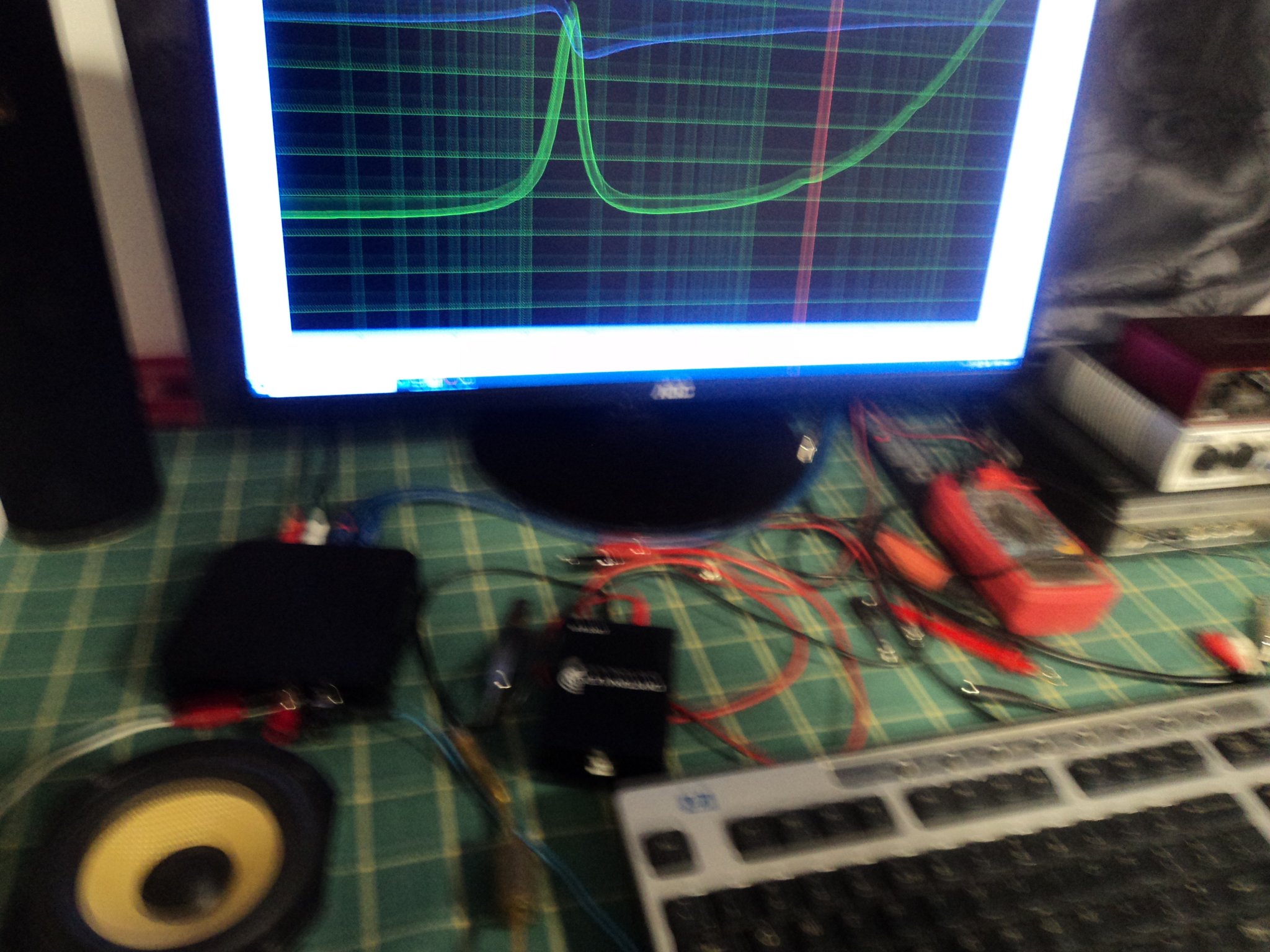

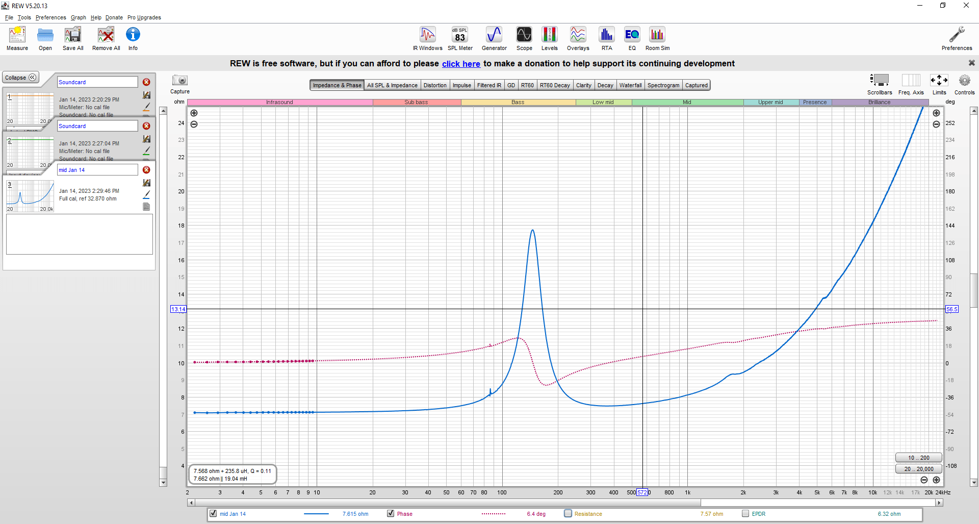

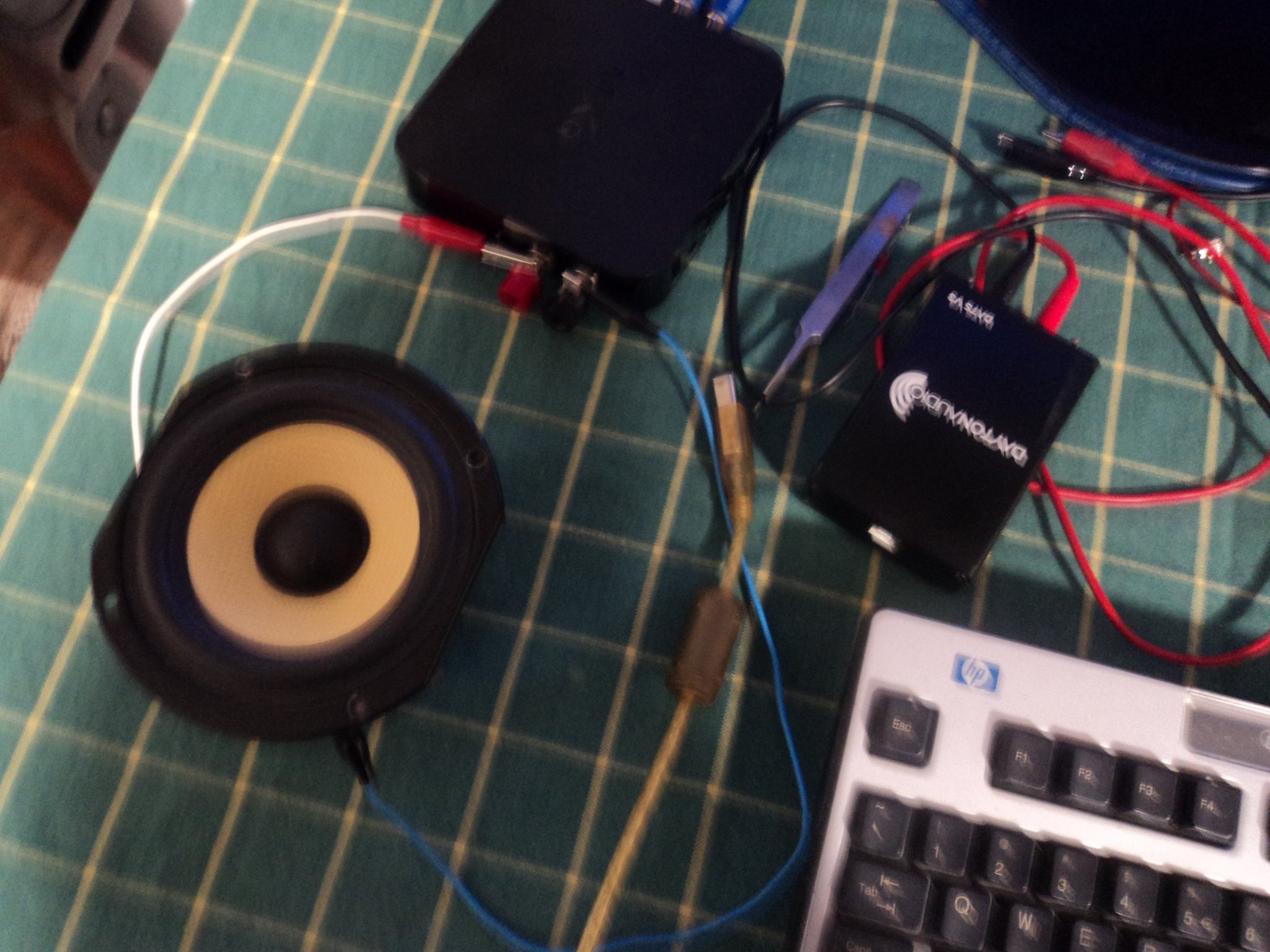

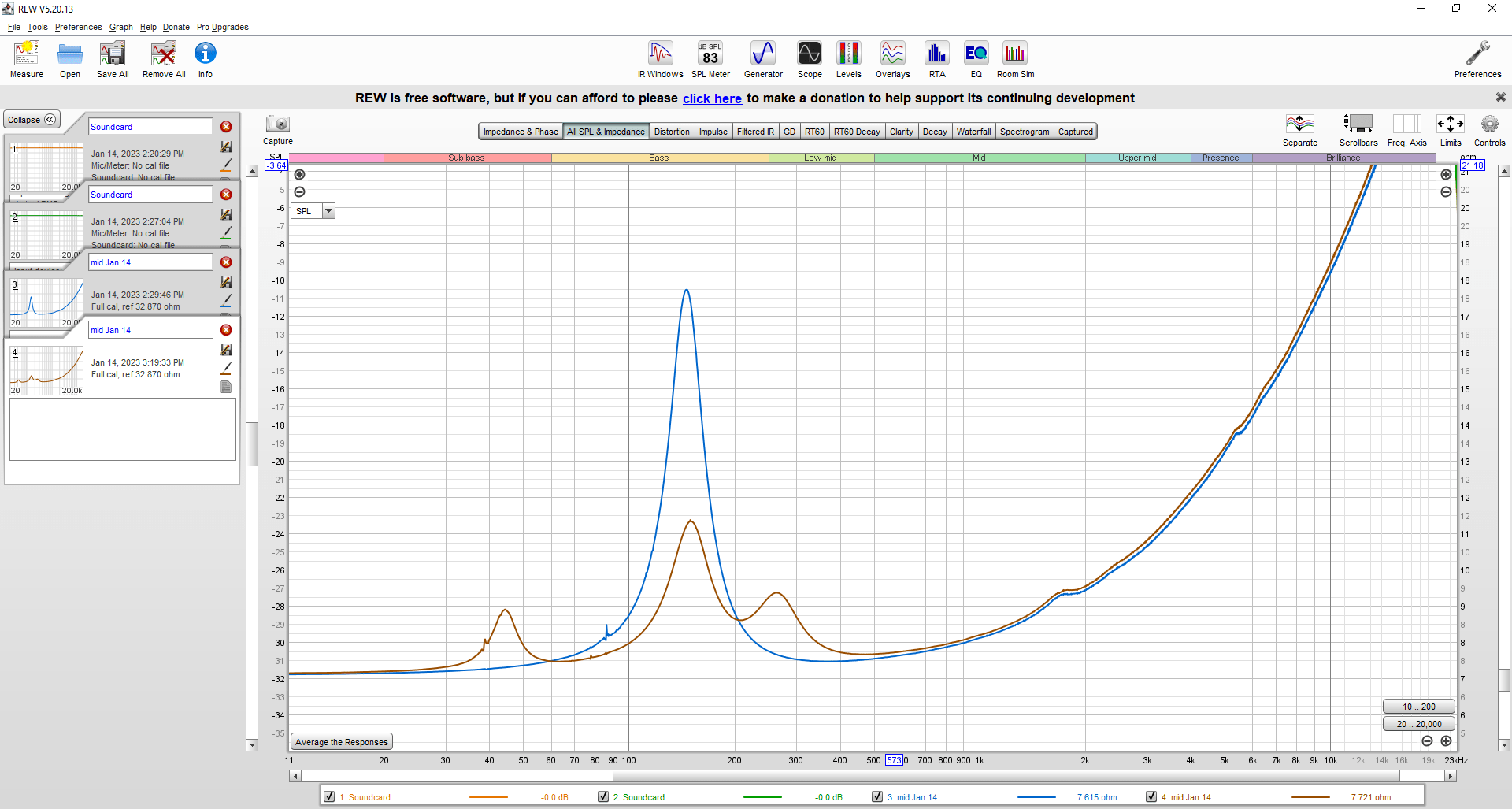

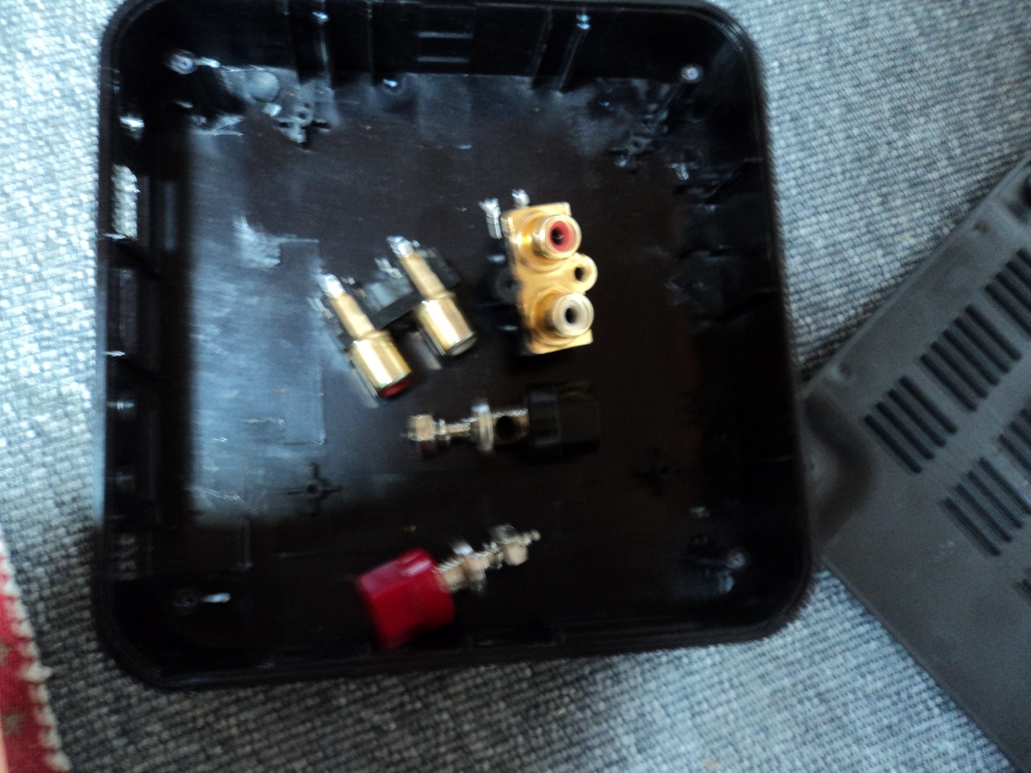

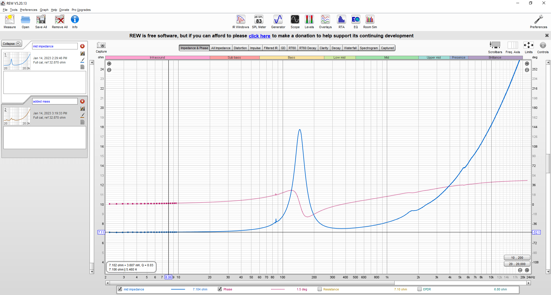

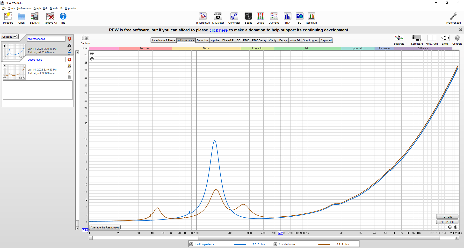

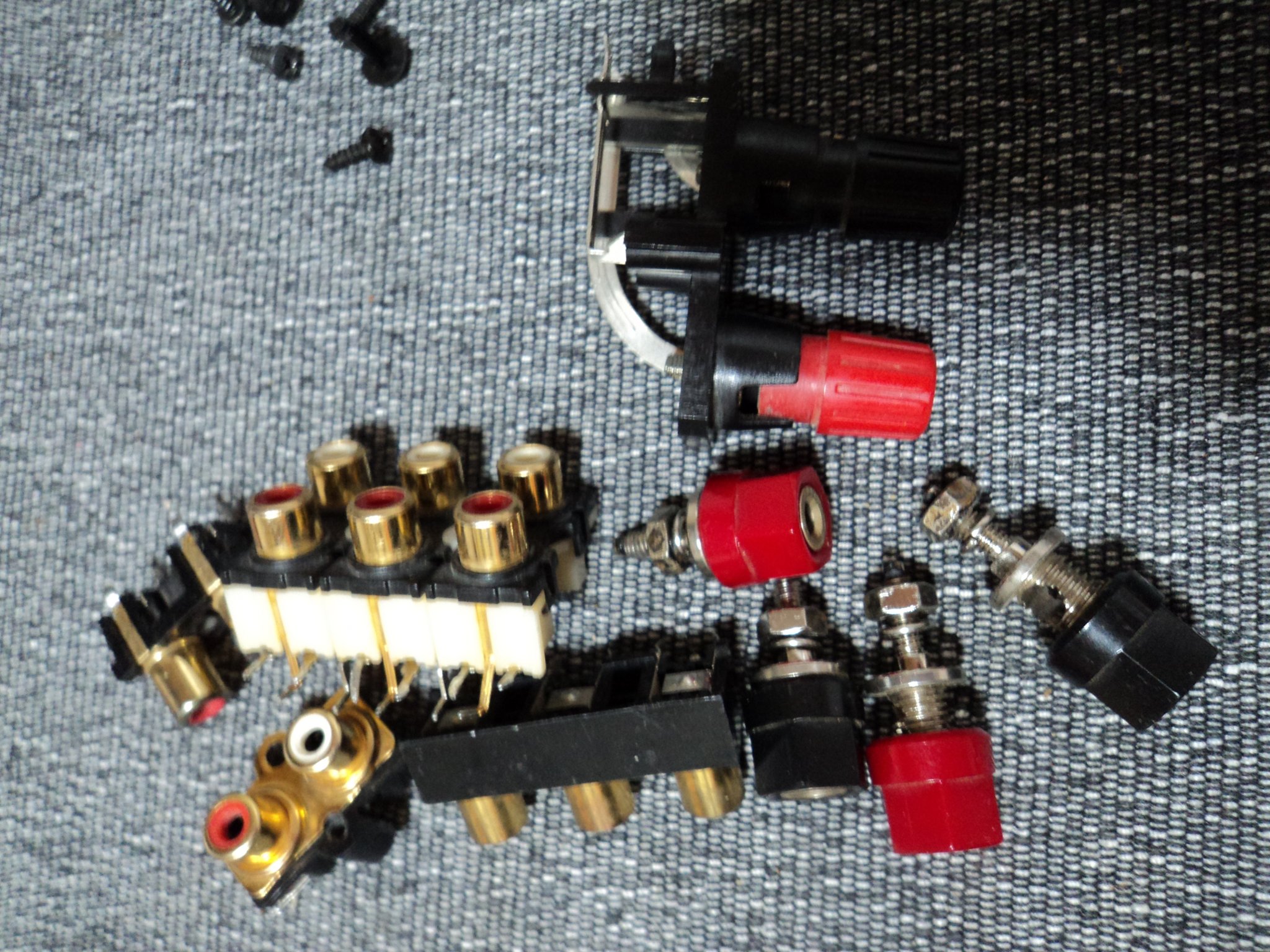

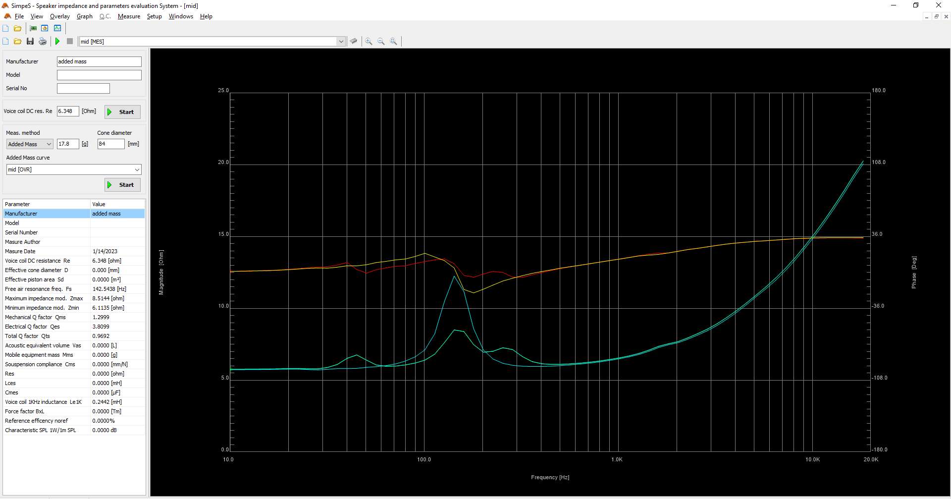

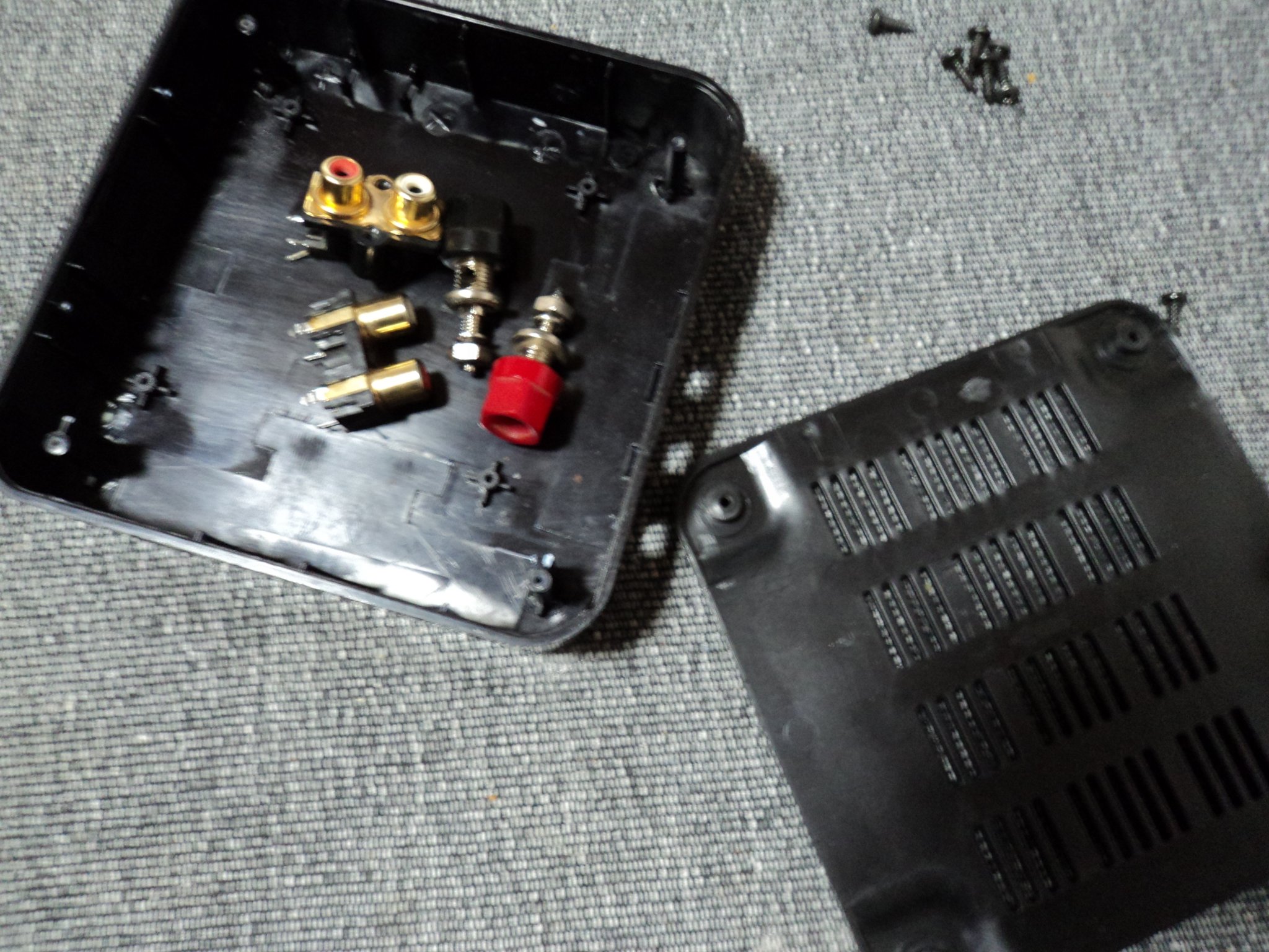

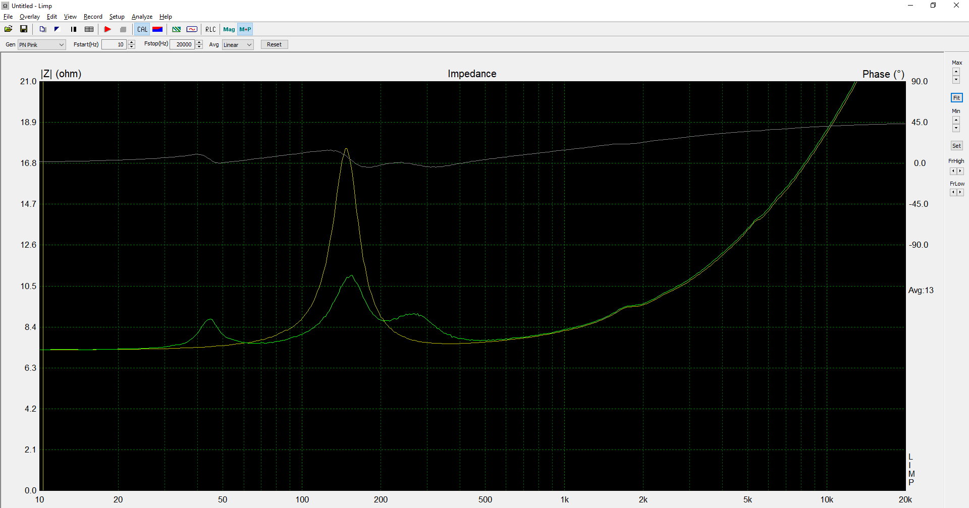

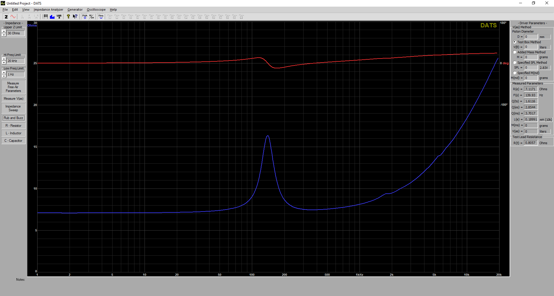

Who wants to make their own ZMA or TXT files, here is a good tutorial on how to build a jig, I made one from parts recovered from amplifiers, and I had the box from an android box, I also have DATS V3 but with the jig I make better measurements with different programs, Arta/Limp, Rew, Simpes. here are pictures of my jig. Here is a link how to build a jig yourself: https://midwestaudio.club/resources/easyzma/
