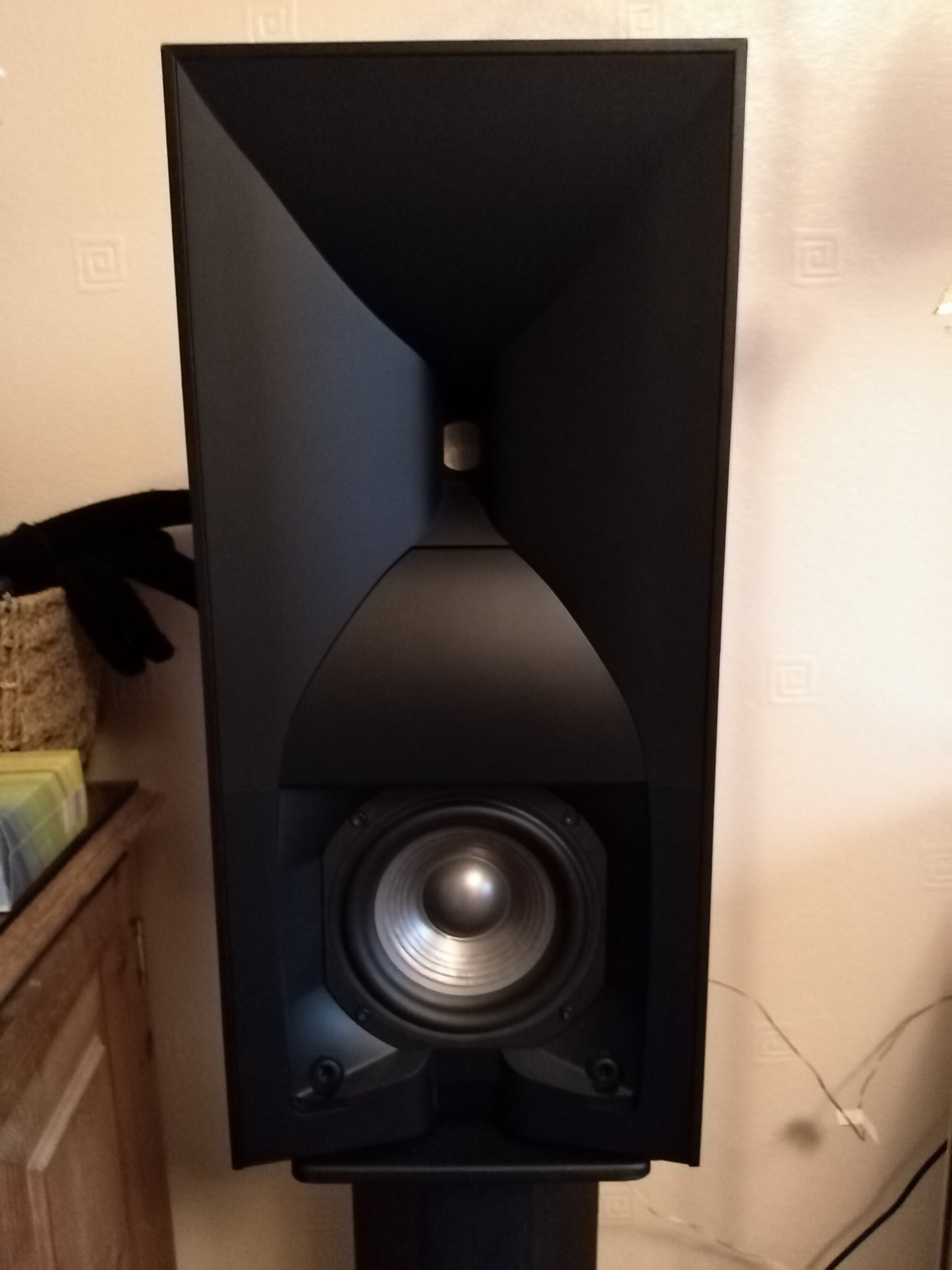

Hi Bare
Yes, i know, when bought them, I said to the seller I may have to bring them back because of this issue, It seems on paper really bad, but in practice, volume is not a problem. I think badass power supplies 2 x 300va toroids with Paul Hynes regs plus Charlise 2 ta2020 biamped with the Rel sub combine into something really special. Have you heard JBL 530's? they do some extraordinary things. Greg timbers (the designer) knocked it out the park with these puppies!
Regards
jono 2
Regards
jono 2
