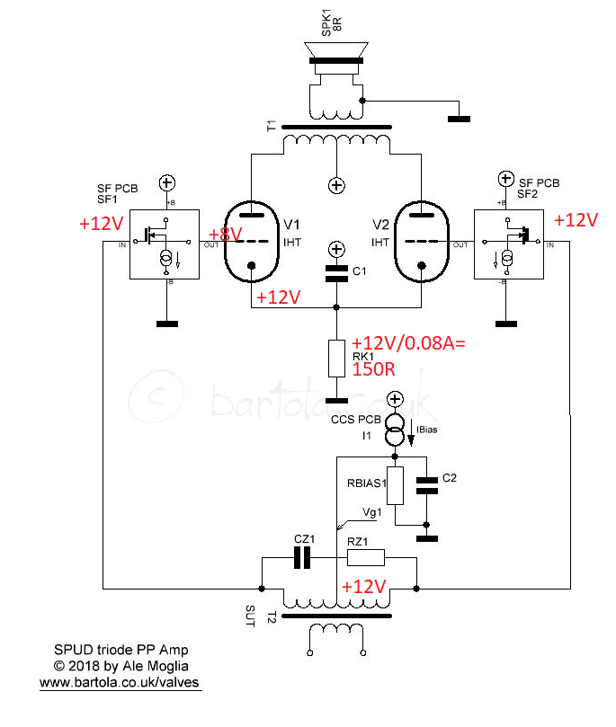

If Vg1 = -5VDC, the source follower will be Vg1 + 50 = -55VDC?
But normally SF must have + and - 40-50VDC.
It should have +50 and -55?

The author wants both tubes to stay in class A conducting all the time.
42 mA idle per tube means 84 mA through Rk1 which puts cathodes at +5 V.
Assuming also +5 V for Vg1 puts the grids at +1 V (as the mosfet drops about 4V) which means --5V for actual Vgk.
so +/- 4 V swing from the input transformer swing the grids up to + 5V and down to near zero limited not by input but by mosfet gnd.
Which corresponds to actual 0 V and -5 V for actual Vgk because of +5V cathode.
This way both tubes stay conducting all the time in class A as intended.
And negative voltages for mosfets are not needed.

At second thought, you were right, negative voltage is required for the SF bottom.
Otherwise gross distortion ...
But +/- 50 V is not necessary because 6e5p / 6e6p have high gain gm=30 and mu=30.
If you look closely the schematic probably says +/- 8V for the SF1 PCB which seems to have its own PS.

First I also thought: why the CCS go to gnd. But then I saw that the author uses a CCS into a resistor for Rbias. This creates a positive voltage at Vg1 and at the gates, allowing the CCS to return to gnd and still having enough headroom. I put some DC voltages in the drawing to exemplify (I choose 12V because this can be obtained from an A23 cell), just check how many volts the CCS needs for proper operation)
in the CCS I assume the use of enhancement mosfets, therefore 12V at the gate and circa 8V at the source.
Probably the author did this because of high capacitance of the triodes, increased by the step up of the input transformer?

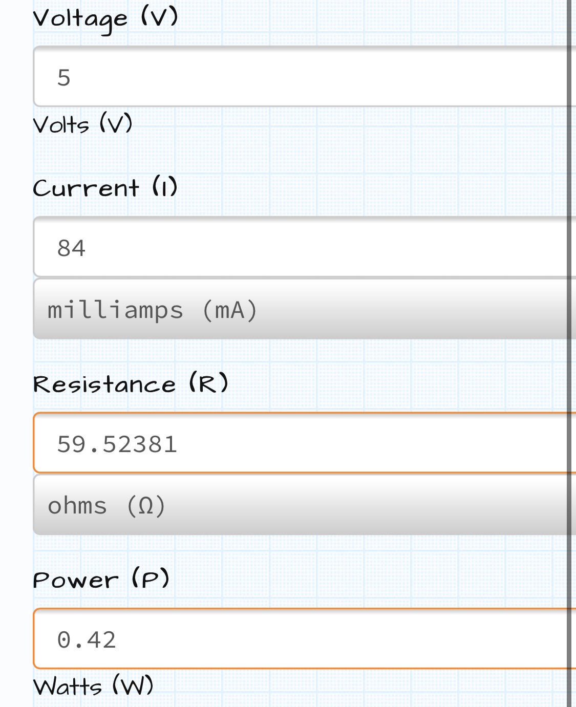

When G is at 0V, the cathode is at 5V, and indeed Rk is around 59R for 42mA. This is DC condition. For AC the grid needs to swing +-5V, this signal comes from the source follower. The source follower and the CCS needs to have the headroom that they can swing the +-5V and still have some voltage over them for proper operation. By biasing the input transformer with 12V, there will be about 8V at the source, consequently also 8V over the CCS. When AC is applied, in the valley of the sine, the source will go down to 3V (8V in DC state - 5V of applied AC), so there is now 3VDC over the CCS, which maybe is still enough for it to operate properly (a LM334 could do that).
You can also power the source follower from eg +-50VDC, one thing to note is that the 6E5P has high transconductance and that can cause runaway with too small or zero cathode resistors. So I actually like the idea of elevating the grids above 0V, this allows one to use a bigger cathode resistors which decreases the change of runaway.

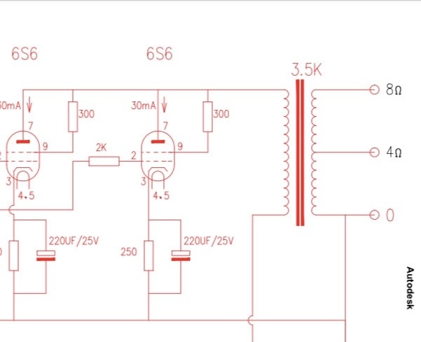

6J1 drive 6S6 in PSE, i will buy opt later. Thank you for your help. I got few knowledge about tube.
