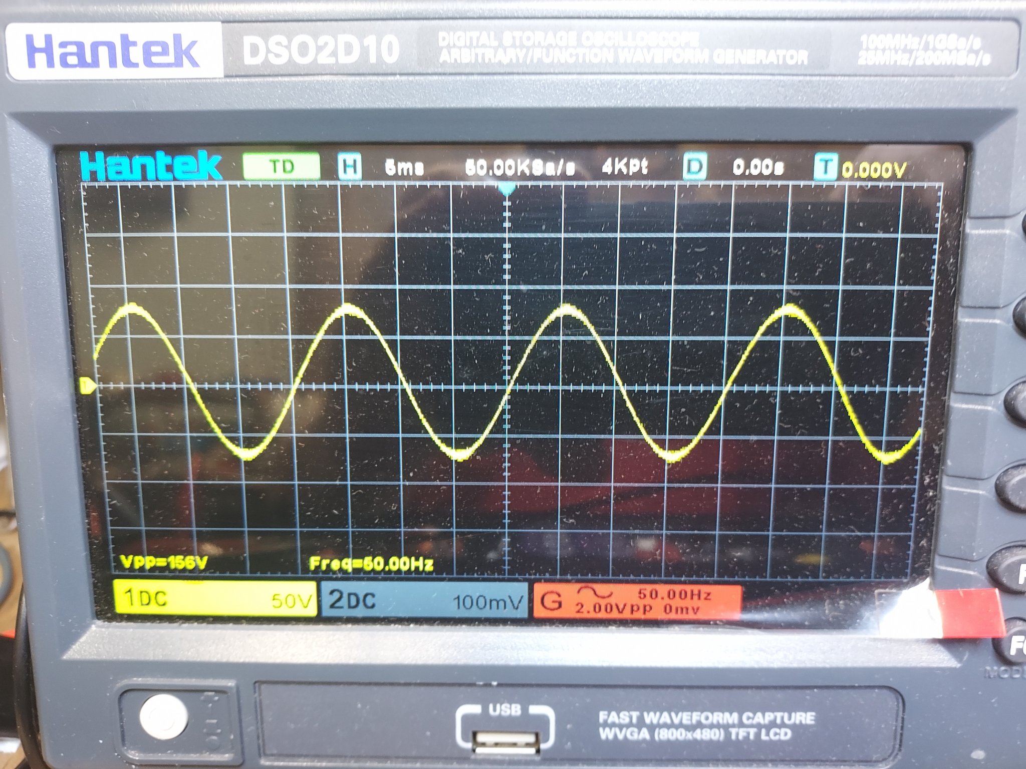

I input a 50Hz sine wave @2vpp and have a good output signal.

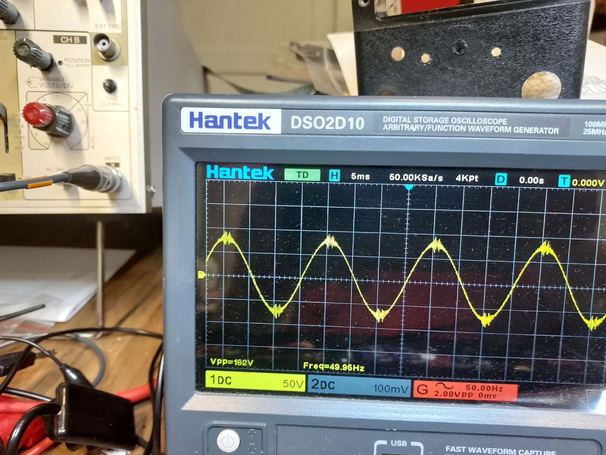

I started increasing the gain and as I got to 160vpp, just before clipping, on the outputs I can hear a "buzz" and the peaks of the sine wave get "squiggly".

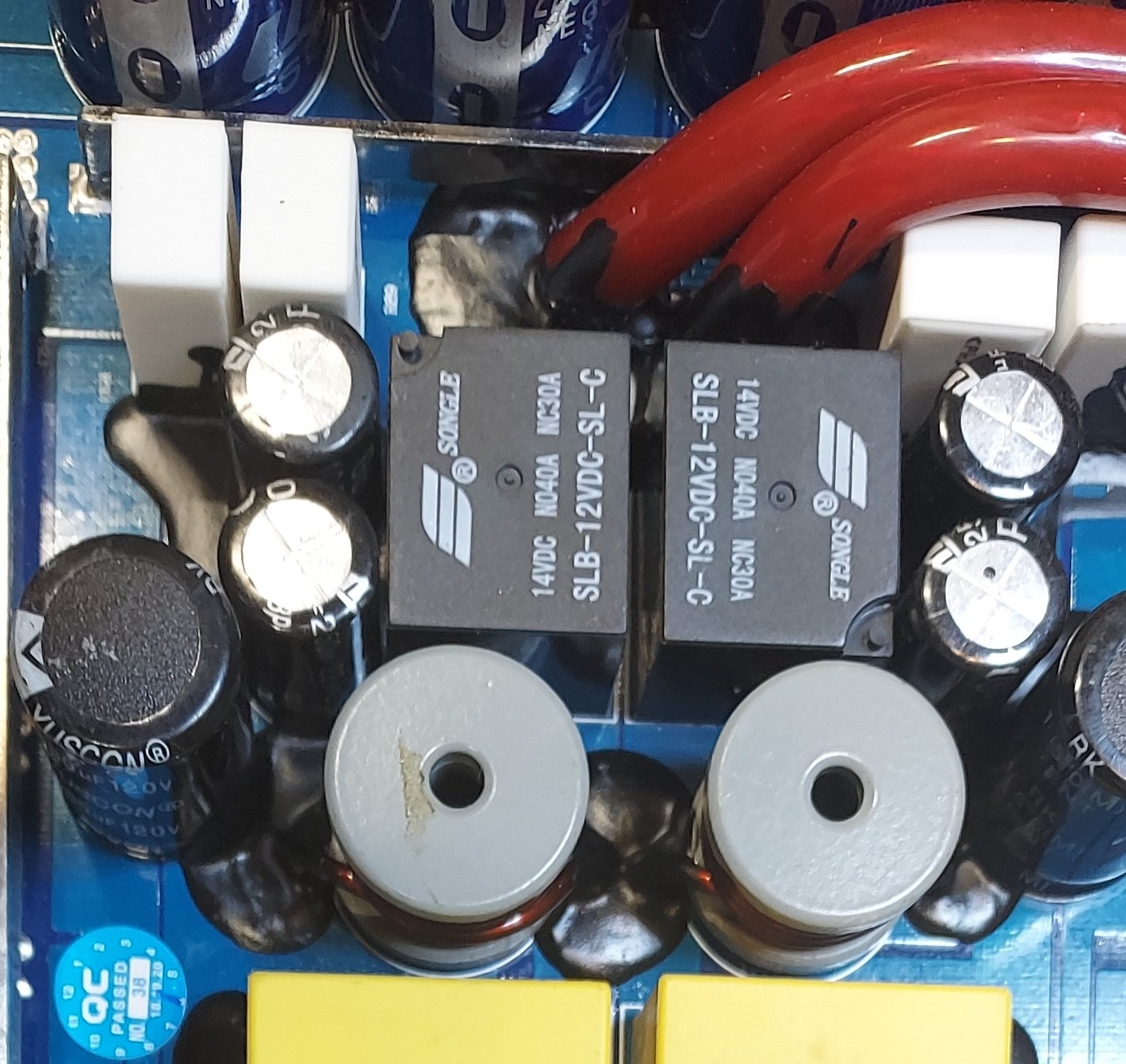

I can't pin down exactly where the buzz comes from, but it is in the area of the output filter caps and inductors.

Photo of waveform?

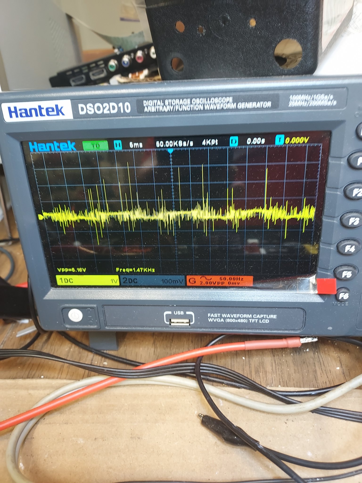

Do you see any significant noise on the heatsink at any time?

The output wave forms were with the scope set to 50v/div, 5mS and a 10x probe.
The "noise" on the heatsink was with the oscope set to 1v/div and 5mS. Scope ground on the speaker negative.

Those aren't ideal but probably nor far from normal.

With the 8 ohm loads in parallel, the amplifier started clipping at ~120vpp.
The "buzz" noise is still present just before clipping.

Is it possible that a capacitor could make that noise?
I can't really see a bulge on top of one, but it kind of feels as though one is ever so slightly bulged on top.
It's the one on the right in this pic with the black dot.
If you're still getting the noise at the top/bottom of the waveform that may be enough to induce noise in the filter components.
If the capacitors were bad, I'd expect to see a lot more noise on the entire waveform.
