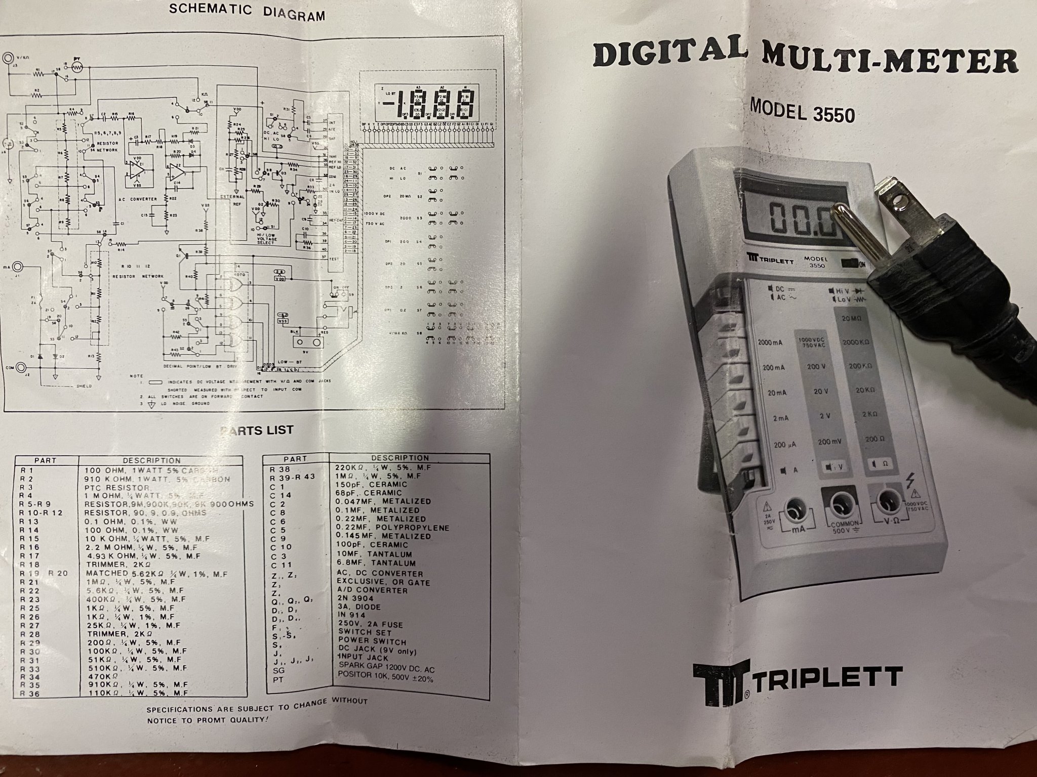

OK. Check the probes like you were trying to do with the other meter to confirm that it's working correctly.
So probe came in and tested the probe and it showed like 0.1 ohms.
