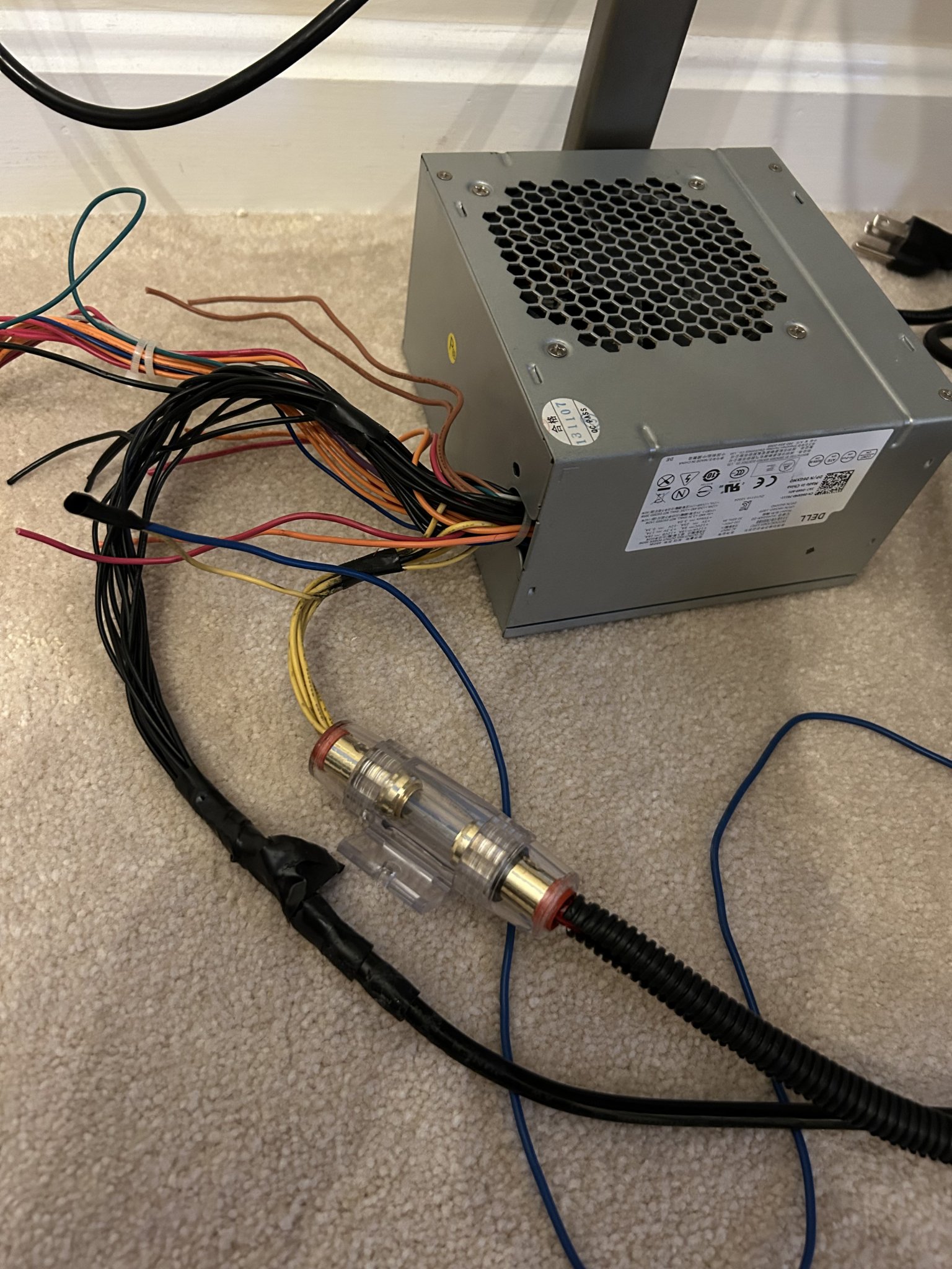

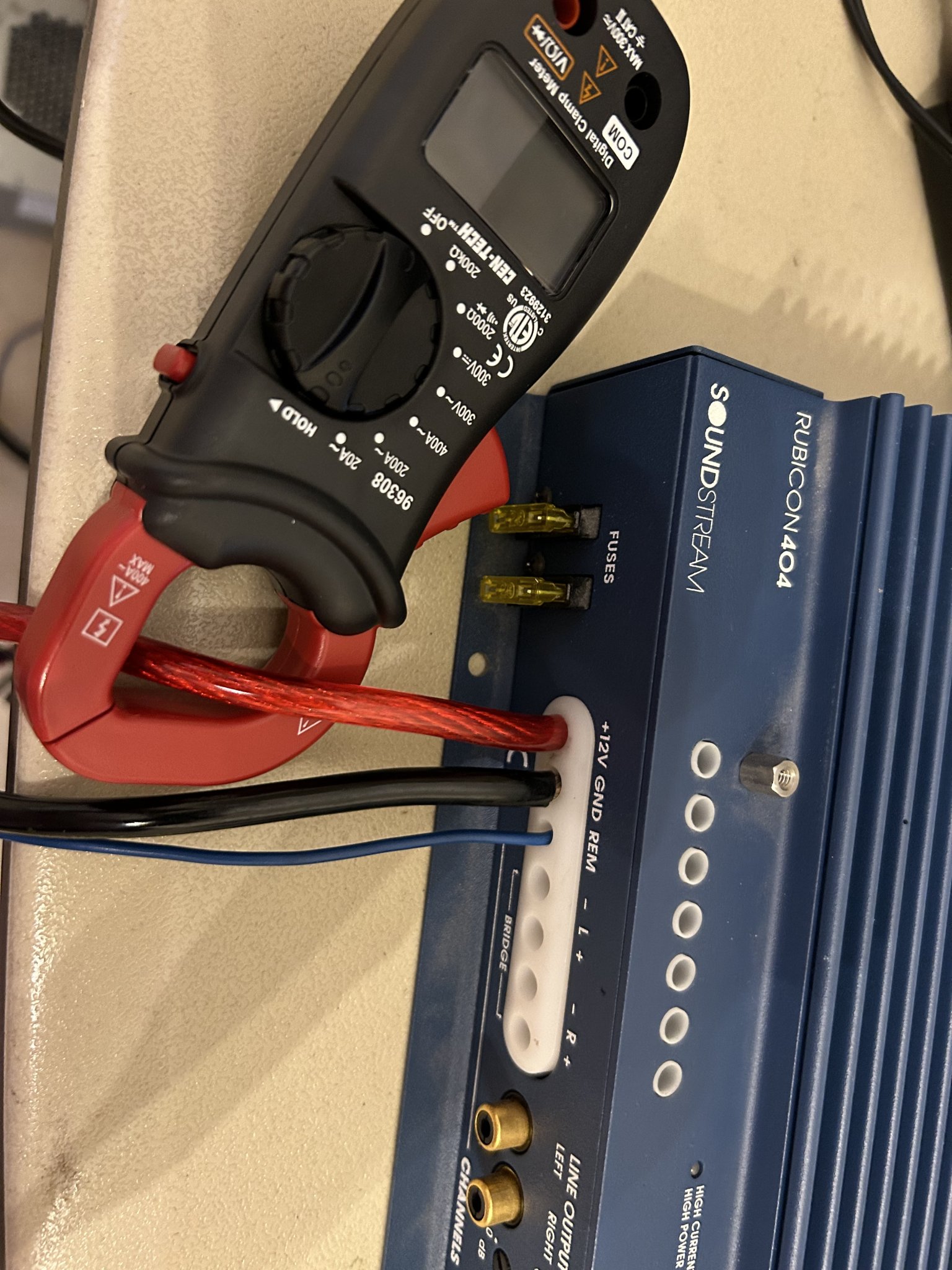

Good to know for next time. I tried turning the plastic while holding the metal shaft with a bit of force and the glue held strong. Here is my ATX power supply setup if anyone is curious. 12v (yellow cables) goes to fuse box and then to amp. Ground straight to amp. One 12v cable was used for the remote signal. I also put an ampmeter on the power line to keep an eye on it. Tomorrow once the fuses arrive I power this baby up.

Well initital testing complete. Channels 1 and 2 working fine but the pots need a little cleaning (didn’t clean them yet because I wasn’t sure if they were dirty). The pots on Channels 3 and 4 were fixed. No more noise when adjusting the levels. I touched all the switches and found the culprit. Its the input select switch that chooses if the input comes from channel 1-2 or channel 3-4 RCAs. Upon touching it it made the RIGHT channel of 3-4 cut out or muffle. I then ran all 4 channels simultaneously at medium volume for an hour. 10A inline fuse held up fine. Amp seems to be working perfect. I am worried that when installed in a car that bad switch might cause trouble given the bumps and vibrations that are normal in a car environment. Also would like to push the amp a little harder to test it. Is it ok to install the 15A inline fuse and push it. If it blows then I pushed it too hard. But I saved the ATX power supply that is rated at 18A.
Also to confirm so you don’t recommend AGU fuses for car installs?
The AGUs are OK for relatively low currents if the guidelines I gave are followed.
You can use the 15 amp fuse.
For the dirty switch, you can try using a couple of drops of contact cleaner into is and working it back and forth but the ones that are not giving a problem, I'd leave them as is.
Thanks for your fuse advice. I looked up and read your great articles on fuses and wiring. I was unaware of how slow fuses blow when the current is slightly over the rating. Knowing this has made me reassess my statement above about pushing my amp hard with the 15A fuse. I bought cheap no-name Chinese AGU fuses. I feel better using the 10A fuse as I hope it will blow faster if it reaches the ATX's limit of 18A.
