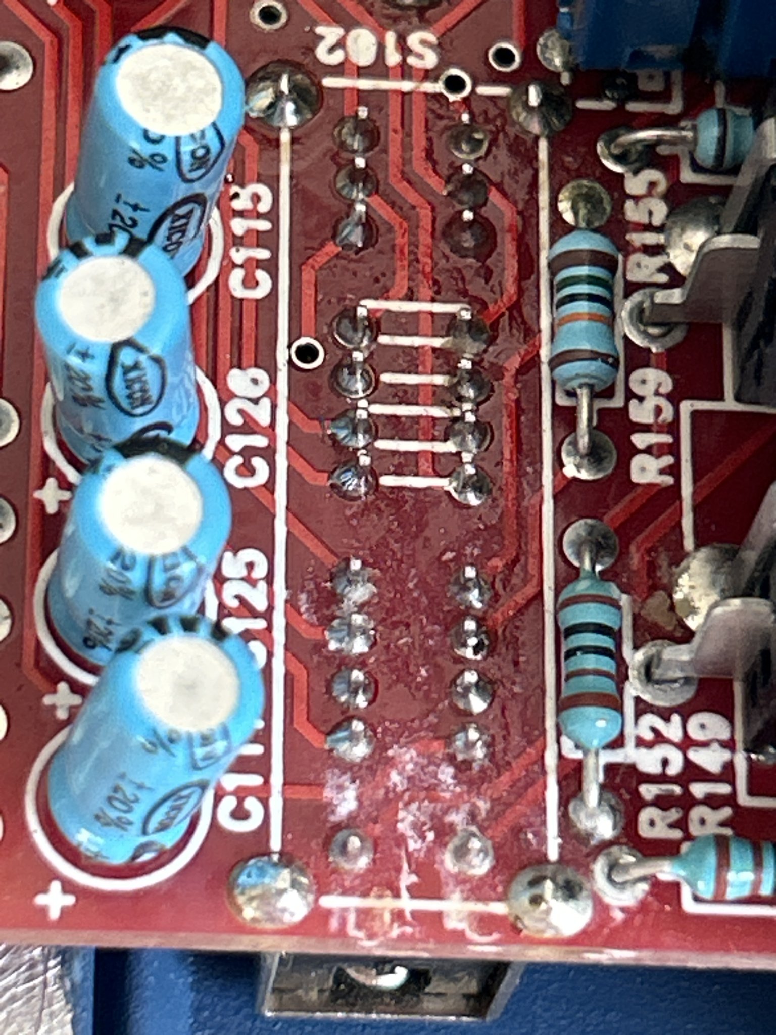

Lastly, during my inspection, I did notice some white marks or stains around the leads for the crossover switch for channels 3-4. See attached picture. Are these anything to be concerned about?

Thank you Perry. Will give your recommendations a try and report back. Also will investigate the marks around S102 a little further and/or try to take a better picture. I don't want to stress the amp because of the ATX supply while testing. Any way to know if I'm pushing it too hard? I checked the AC voltage while driving the speakers on the 12v screw (I believe this is the B+ terminal in your tutorial) and the ground screw. It read a constant 12v. Should I add a 10amp fuse between the ATX power and the amp like you mention in your tutorial?

Can you rub the white marks off of the board with your finger or a cotton swab?

Also regarding the white stains. Not sure what it is but it’s not a paste unless it’s dried or caked on because it would only come off by scraping it with my nail. I attached another photo.

For the white substance, I wouldn't be concerned about it. Heatsink compound can harden but I've never seen the compound in SS amps harden.
