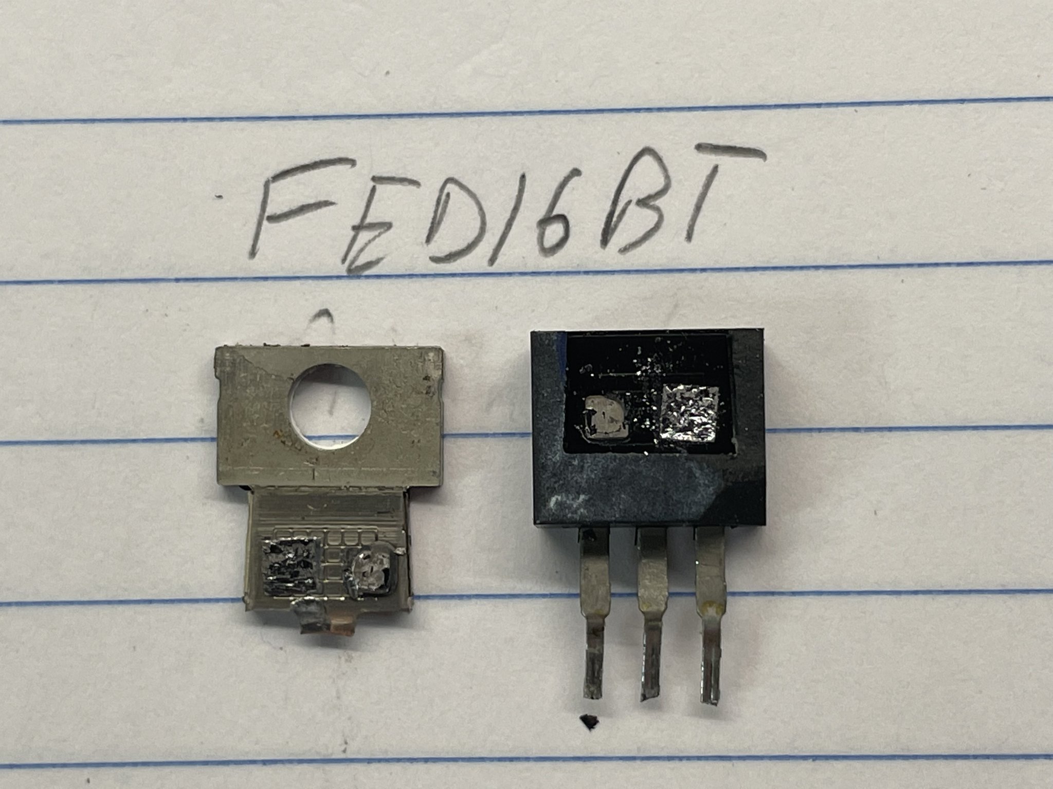

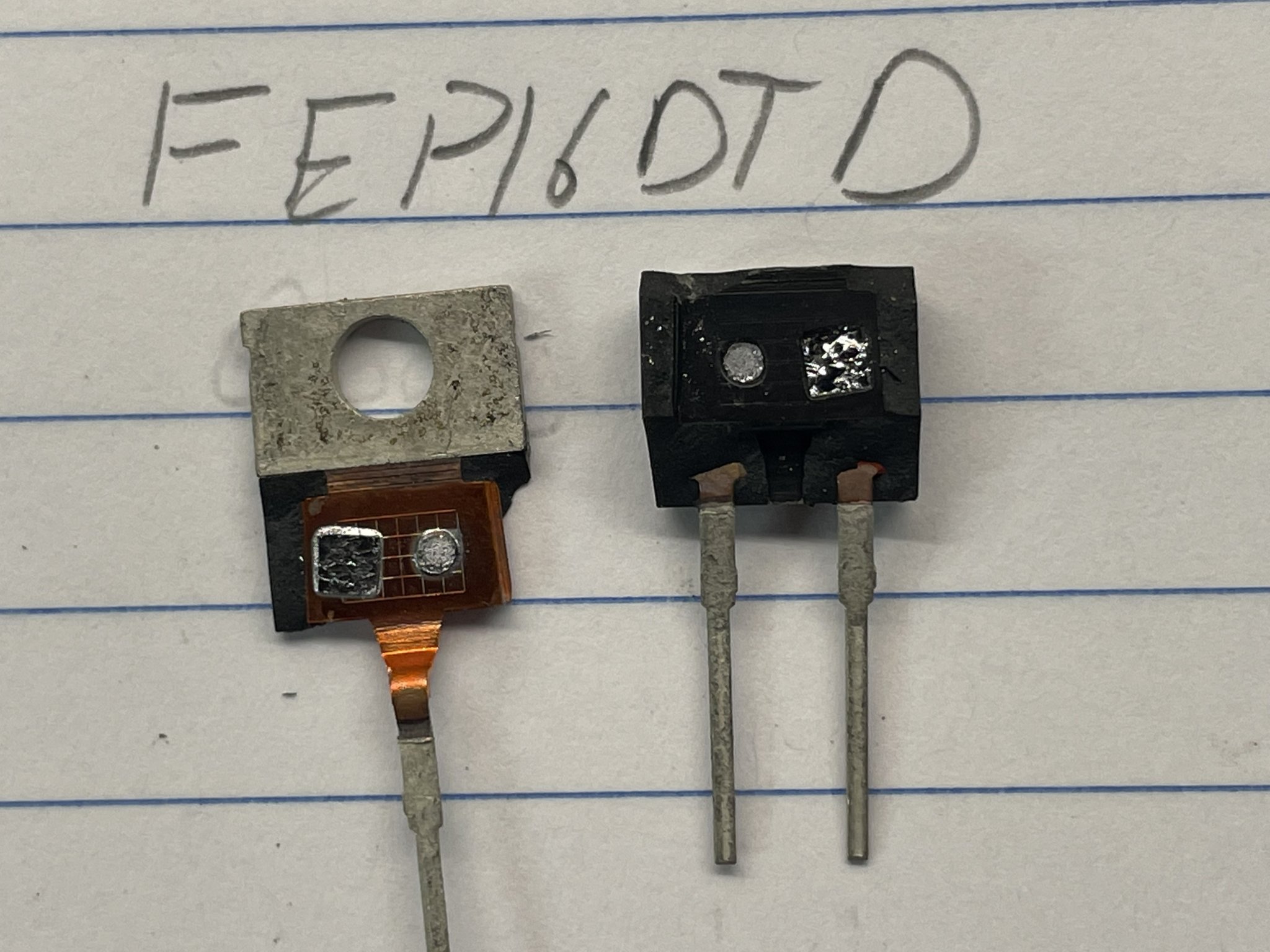

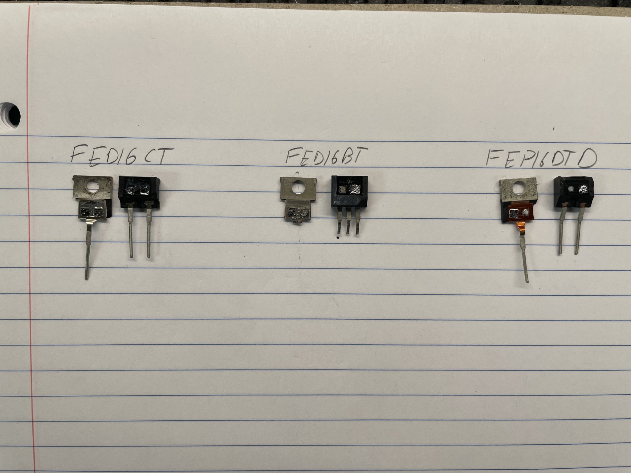

Are any of these fake counterfeits?
I can't say legit without seeing legit. Typically, the die size is much reduced for counterfeits. Genuine also typically have a much cleaner solder bond to the metal tab.
The third one could be a defect or counterfeit. I had some FETs that I bought that were actually dual diodes when I cracked one open.
