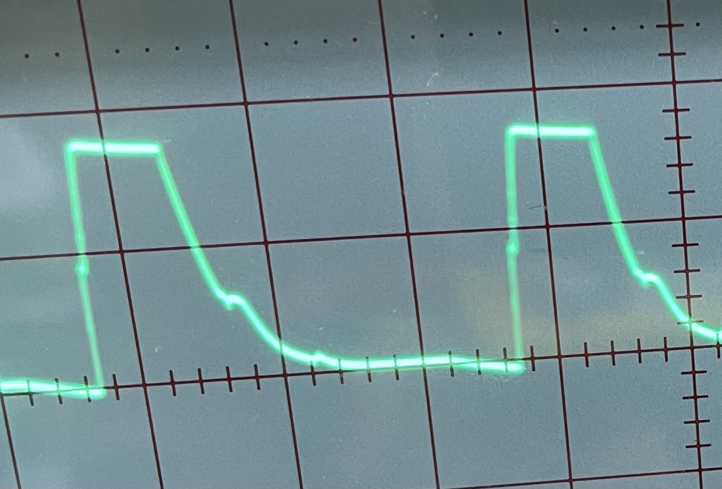

I think so. I did have the 1k pulldown resistors in there when I modified the PS drive circuit and they won't work without the drive circuit hence that is why I went back to 150ohm - Amp drew excessively with the 1k pulldowns.

Wasn't the drive waveform really bad and that's why you wanted to try the emitter follower pair, initially?
