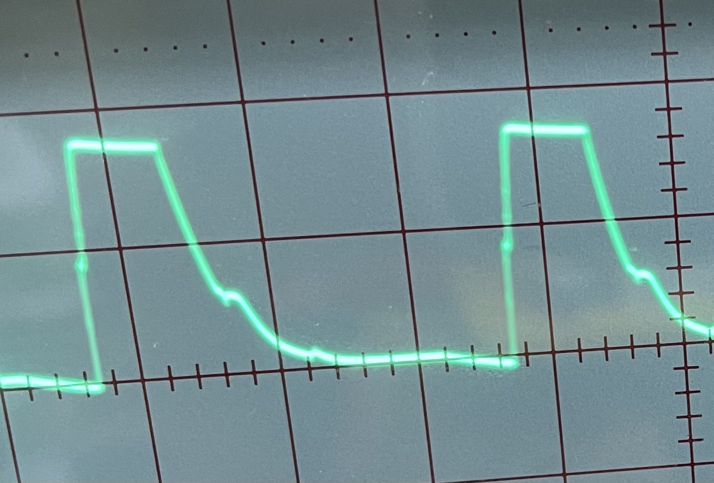

Today received my BK 2120 and just trying make sense of the scope and also this amplifier.
This one supposedly runs unregulated yet I’m measuring the following a 1v/div using a 10x probe as that’s all I have right now.
I was expecting a square wave. Pins 11 & 14 of the 3524 are the same. Amp is running 10ohm gate resistors and 3205 fets. The amp plays otherwise.
Anything wrong here?

Just a housekeeping note. The FETs and gate resistors were previously replaced, but the SG3524 is original. Also this amp was serviced by Ace Labs last.
Hmmm. Some upgrade then. I wonder... Now, the amp actually does work currently though I have not put it under high load yet to see what happens in the supply section...

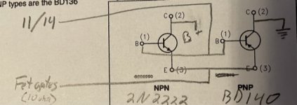

Would it be possible to incorporate a drive circuit into this amp I wonder? It may be too much to consider however looking at other SS amps it appears it would only take a few components per leg that of which I already have. (2n2222, 2SA1562, and a .47uf cap). Not very pretty I bet. I'm after making this reliable, but if it aint broken then maybe I'm barking up the wrong tree.

It's not difficult but may be easier with similar transistors.
For each drive pair:
The emitters are directly connected
The bases are directly connected
The collector of the NPN driver goes to B+
The collector of the PNP driver goes to ground.

Perry,
I have 2n2222-NPN and BD140-PNP. Are you saying that I could just use those two transistors only or do I need to mimic the drive circuit of say a larger Soundstream Reference amplifier; with caps and resistors etc?
This is a bit of un-charted territory for me honestly.
If all that is required are two drivers wired correctly PER SIDE, then this might be easy. However if I need to mimic exactly other SS circuits I'm probably going to get some prototype boards to do this.

Do I need the .47 cap? C71 & C72 on the 500 schematic.
Also, R154 & R161 on the SS500 are 1k, whereas on the SS300 are 150ohm R82 and R83. Change to 1ks?
The caps aren't likely necessary but if you see a problem with the drive, you may try them.
You have the 1k like the 500 and that's OK. The 150 is required because there is no PNP transistor to pull the drive back down.

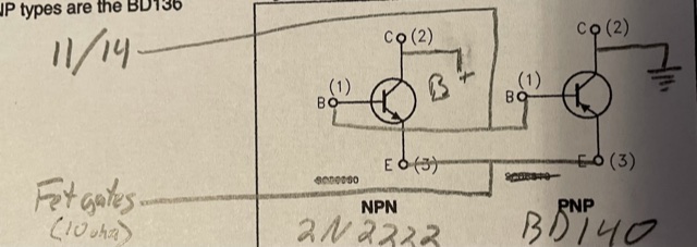

Here’s an updated draft schematic. One of these sets per side from pin 11 and pin 14.
Do you think the 10ohm gate resistors are ok here or is there a better value I should use? I need to REPLACE the 10s to fit this modification. New resistors will give me some lead room to wiggle this in.
The 10 ohms should be OK.
