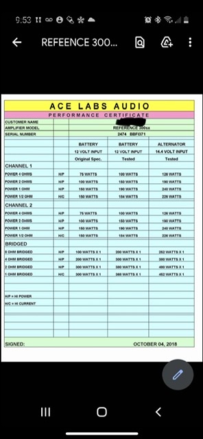

Hi picked up this very clean ss reference 300sx today. It’s got a modified power supply section, and came with a re-birth sheet attached. Does anybody have a schematic so I can just kind of check this one over parts comparison from original? This Amps seems to have different bridge/rect diodes possibly different fets different caps than original. And the rail voltage runs +\- 28 in high power, +-22.5 in high current mode. Otherwise it works thus far.

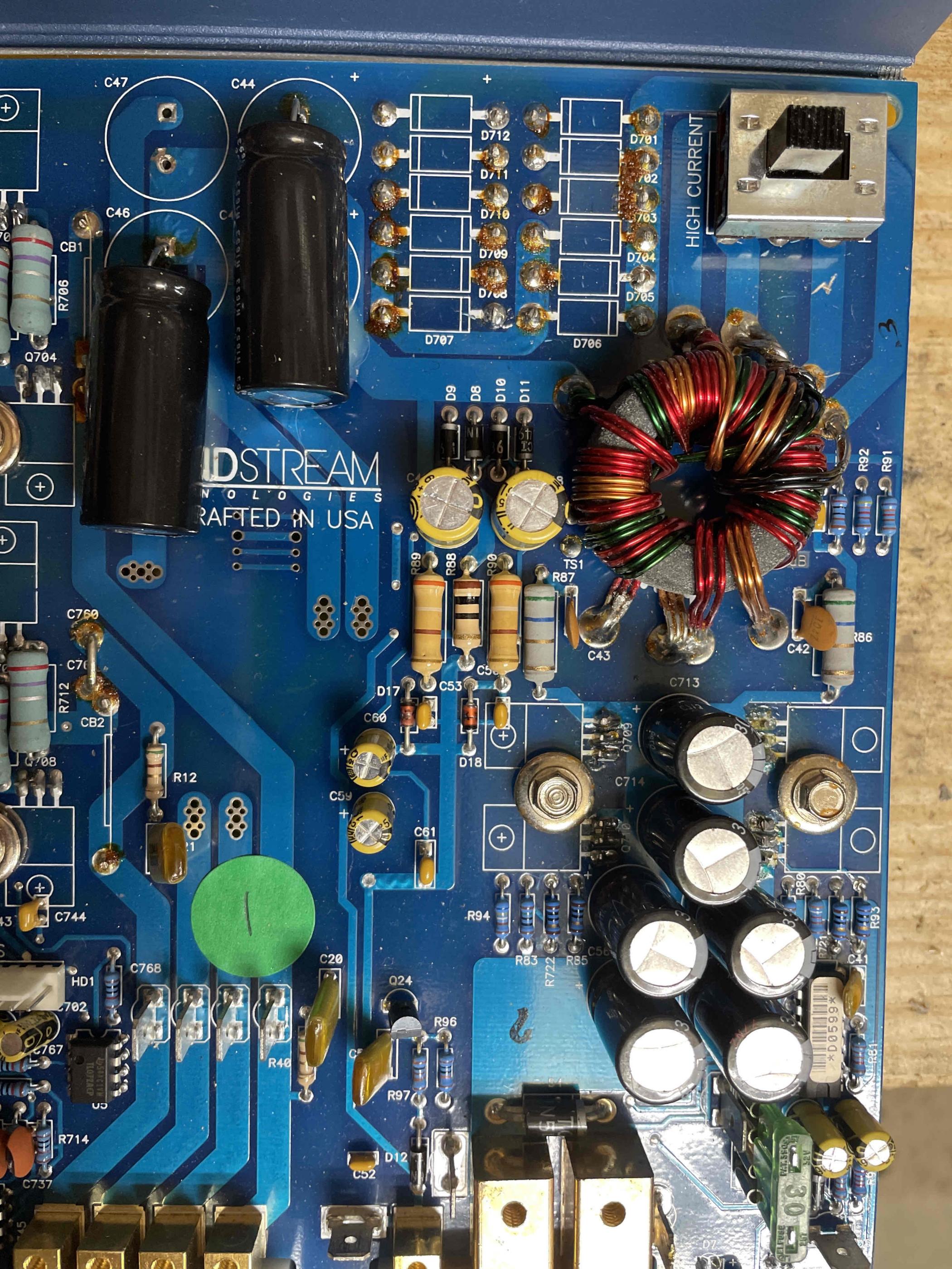

Without taking the board out of the sync; I've noticed the following differences from that schematic.
F1: 30A Fuse vs. original 20A
C45-C47: (2)35v3300uf vs. (4)25v1000uf
C34-C57+C713-C714: (6)16v3300uf vs. (6)16v2200uf
4xGate resistors are all 10ohm vs. original 47ohm
I don't know what the FETs are since its sandwiched in and a working amp, but I can tell those were replaced for sure. Same with the 12x Rectifier diodes.
Since the amp is getting to +-28vDC rail there may be other modifications here-in, since originally this amp was only every to be less than +-25vDC by the original rail cap ratings.
Amps x Volts x Efficiency
30A x 14v x 0.55 = about 230watts, assuming the 30A fuse blows at 31A...
So, does the re-birth sheet hold some truth or not?

The fuse tells you almost nothing. If you want to know the power output, drive the amp into a dummy load, measure the pre-clipping output voltage and calculate the power.
Fuses don't blow at 1 amp over their rating. You can have surges double their ratings and they won't blow. There are curves published for virtually every type of fuse that tells you what to expect time vs opening for various current levels.
I don't see any regulation so the rails likely vary with the 12v supply input voltage.
Unless they added turns to the transformer, the rail voltage will be about the same as OEM. The diodes they used may be slightly more efficient but that's not going to make much of a difference.
Increasing the value of the caps will do very little unless the designer was incompetent.
In situations where the caps are failing from excess ripple current, going to a higher voltage can reduce the ESR which can make them more reliable.

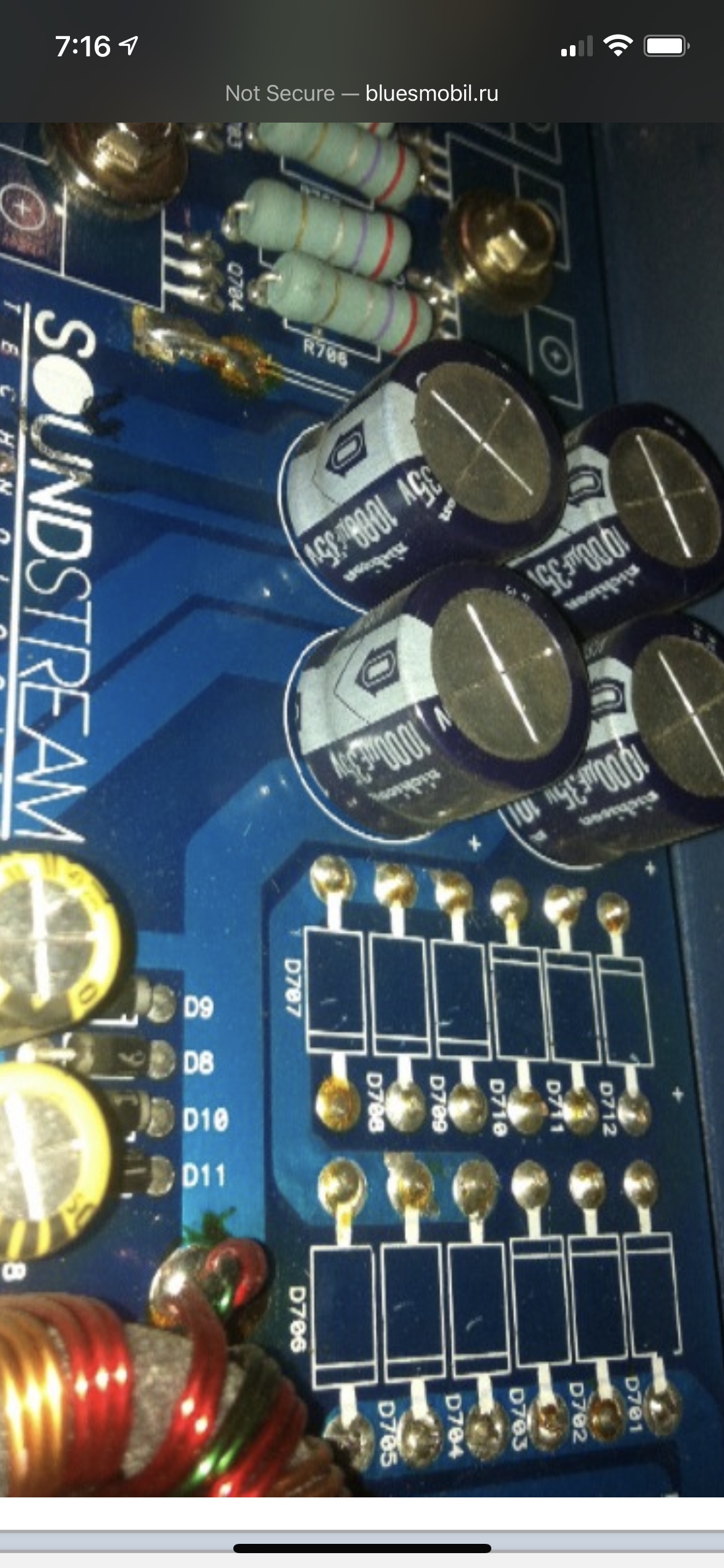

Question for you though on that schematic you posted... unless the 300/300s is different than this 300sx, shouldn’t c44-c47 be 35v originally? I saw a clear photo online of a similar 300sx and it had original 35v1000uf rail caps x 4. Also it had a 30a fuse.

Revisions don't make it onto diagrams that have already been distributed.
The voltage may have been borderline so they increased the voltage ratings on the caps. A 25v cap isn't going to explode at 26v. Most have a fair bit of tolerance for surge voltage. The following is a datasheet that shows surge voltage.

At anything over about 13vDC, the rail voltage exceeds 25v. I don't have the greatest of PS units here so I cant vary the supply very well. I can eigher supply 12.6v, 13.5v or 14.4v. At 14.4, the rail voltage is +-29v.

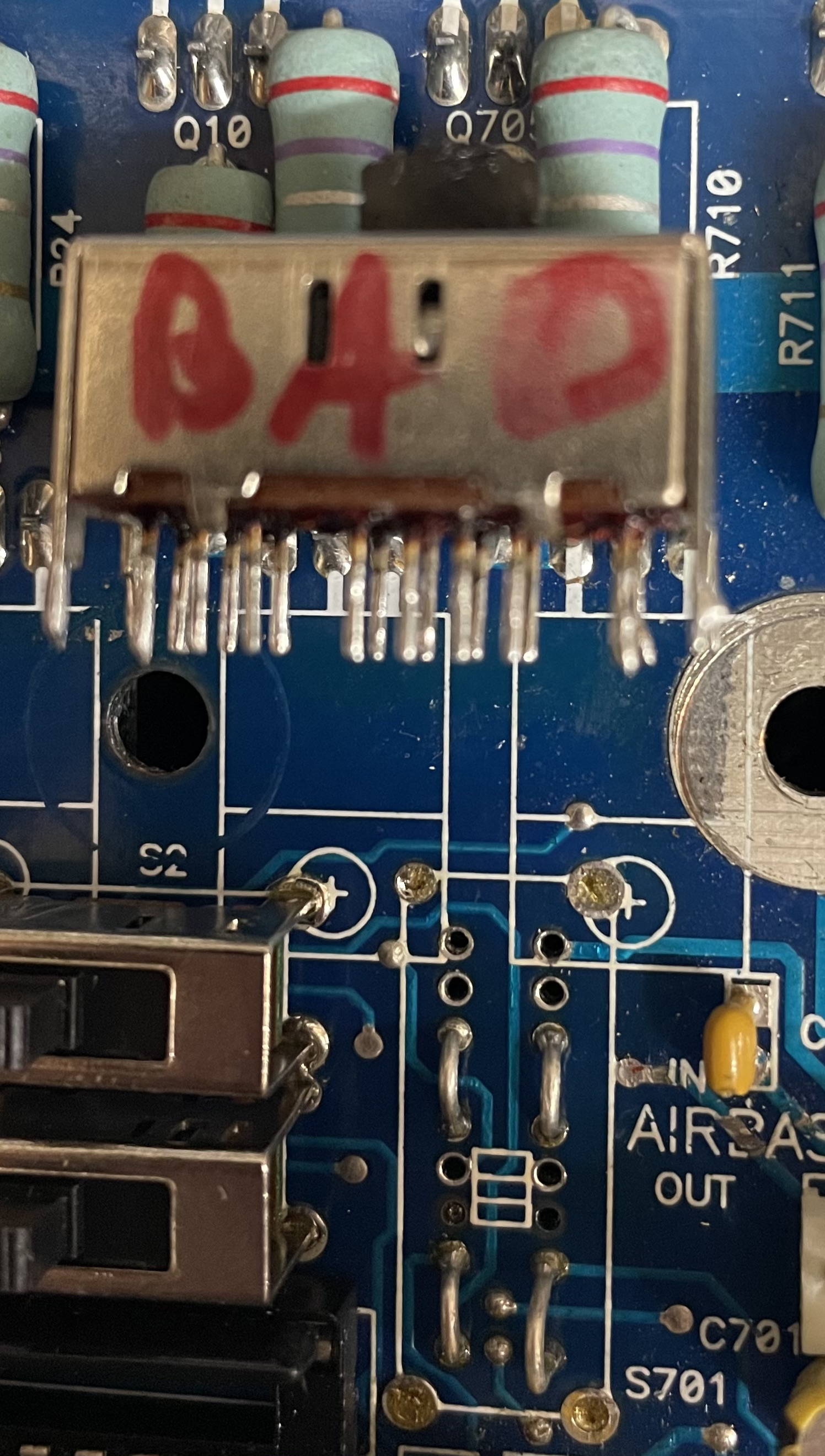

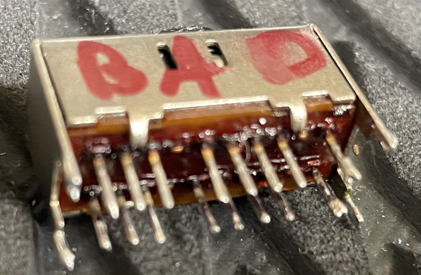

This is a 2-way soundstream switch from the depths of hell. Why this particular switch with so many little connections was chosen is beyond me. It’s 4 switches in one. Insane. On this 300sx it’s the on/off switch for AirBass.... what a waste. My 1000sx has a single little switch for AirBass. Like anyone ever used AirBass right? On a 300sx? Kidding?
This switch is junk and not replaceable from what I’ve found. Not really worth the time and so ive just bypassed it to permanently disable AirBass on the PCB.
