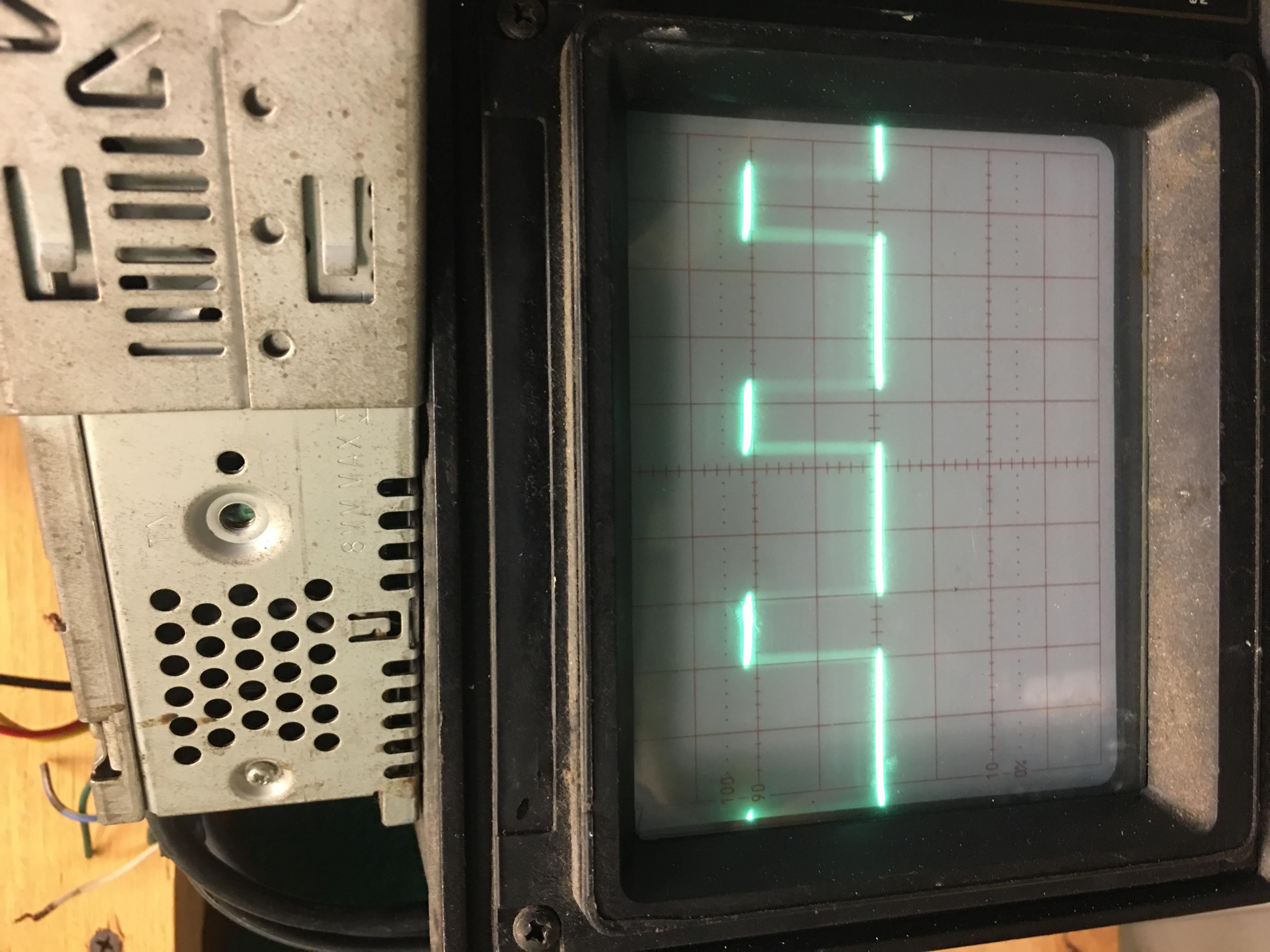

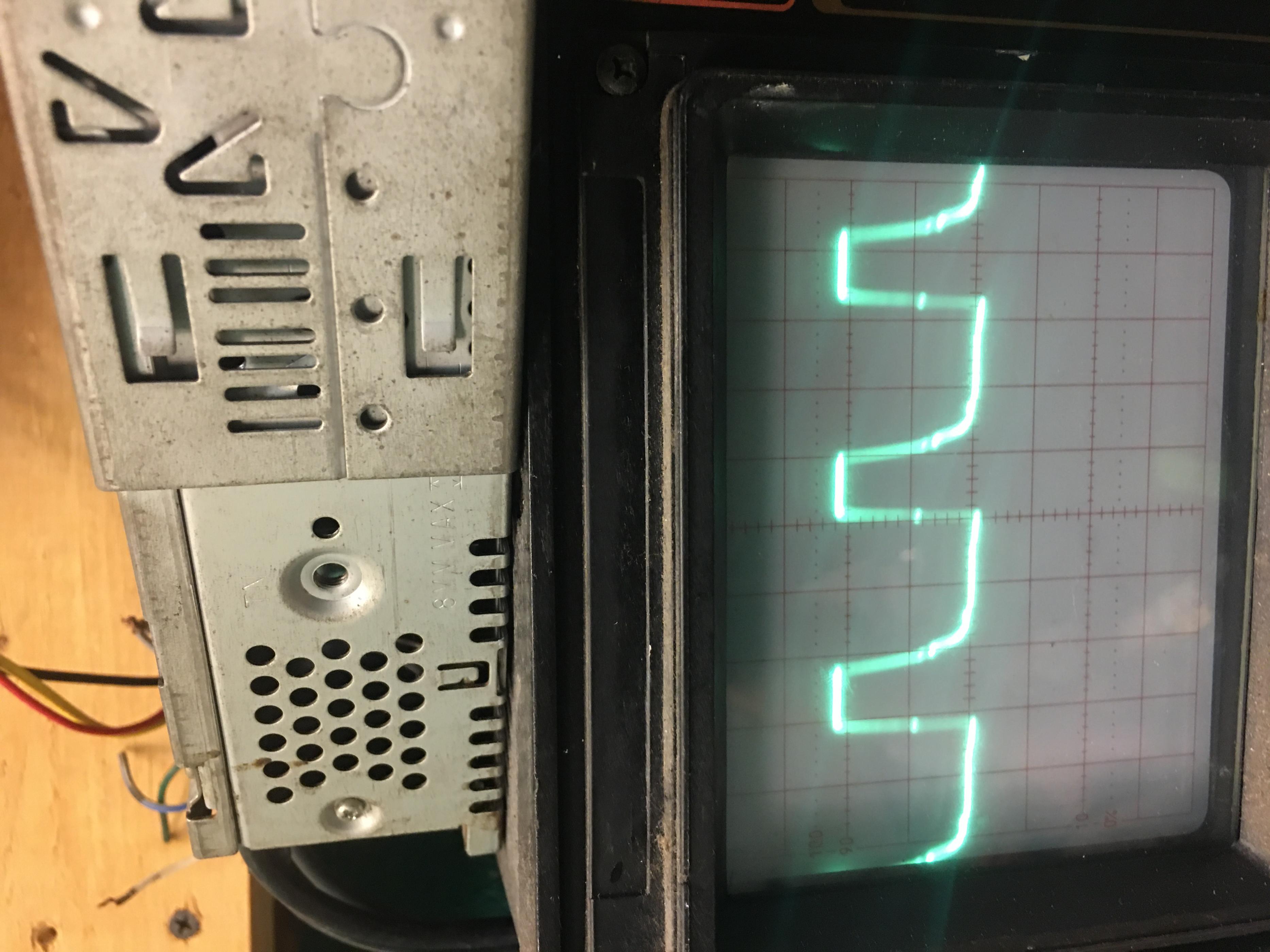

Here is what I get on the Gate pads for the power supply fets .
Does this appear to be ok or do I have driver issues ?
Wondering this since the power supply fets get red hot and the amp draws excessive current
Scope settings are 2us 5volts/div
Sorry not sure why my pics keep flipping sideways
Did you try loading the FET locations with a small capacitor (I use a 0.047 but anything close will work)?
Power supply checks fine .
Something in the output section is causing excessive current draw .
All outputs year good tho
I removed all of the outputs and the amp still draws excessive current .
If I remove the rectifiers the amp is fine but as soon as I put the rectifiers in the amp it draws excessive current .
The amp appears to have been worked on before .
Right now all the rectifiers are FED16CT is this correct ?
And if so what would make it draw excessive current with all of the outputs removed ?
Check the rectifiers. I have had several Soundstream amps from this era that had shorted rectifiers.
The drive is marginal. Is the scope setting actually 2us? If so, the frequency may be a bit high.
Yes. FED rectifiers are what's supposed to be in it.
I agree. One of the doubler rectifiers may be shorted.
You were both right the rectifiers test ok but are shorted .
I found some in a junk board and swapped them out and amp works fine .
