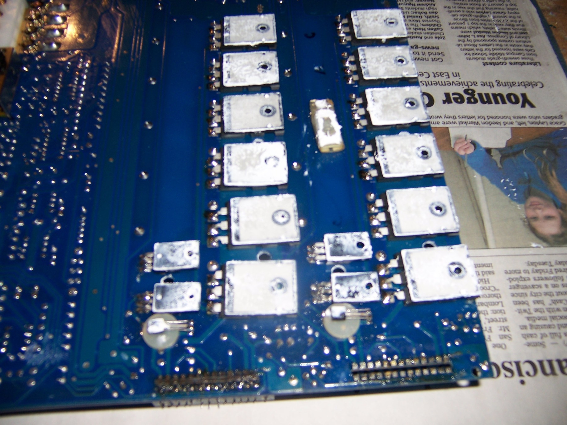

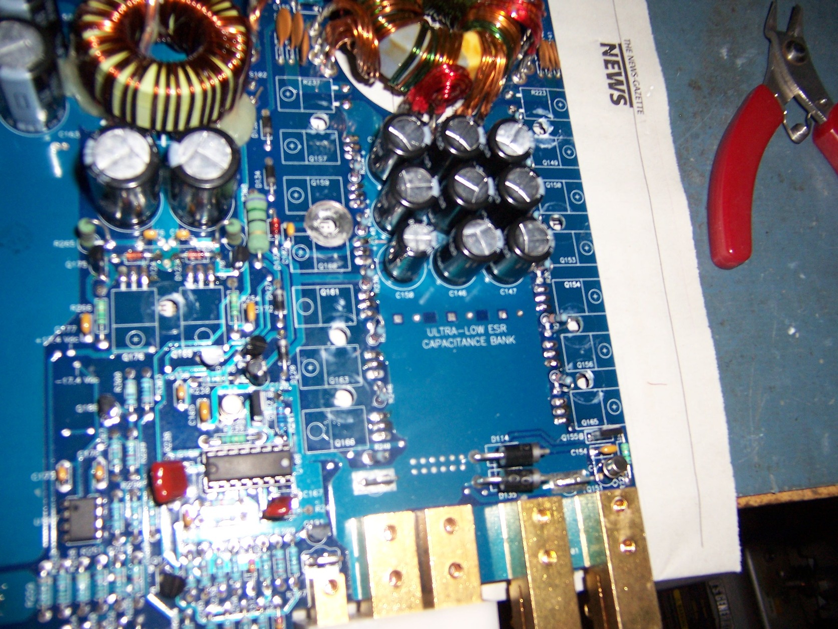

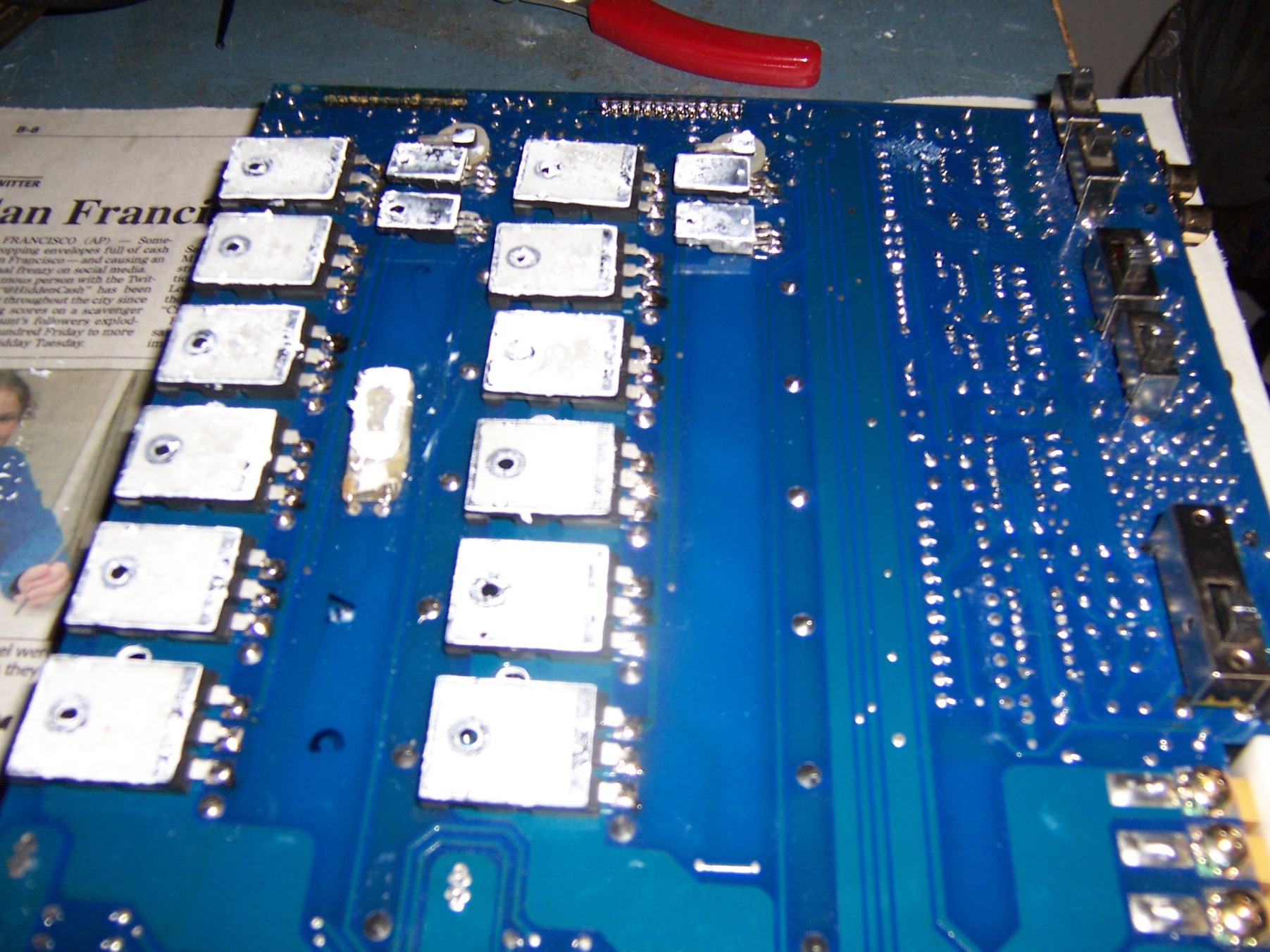

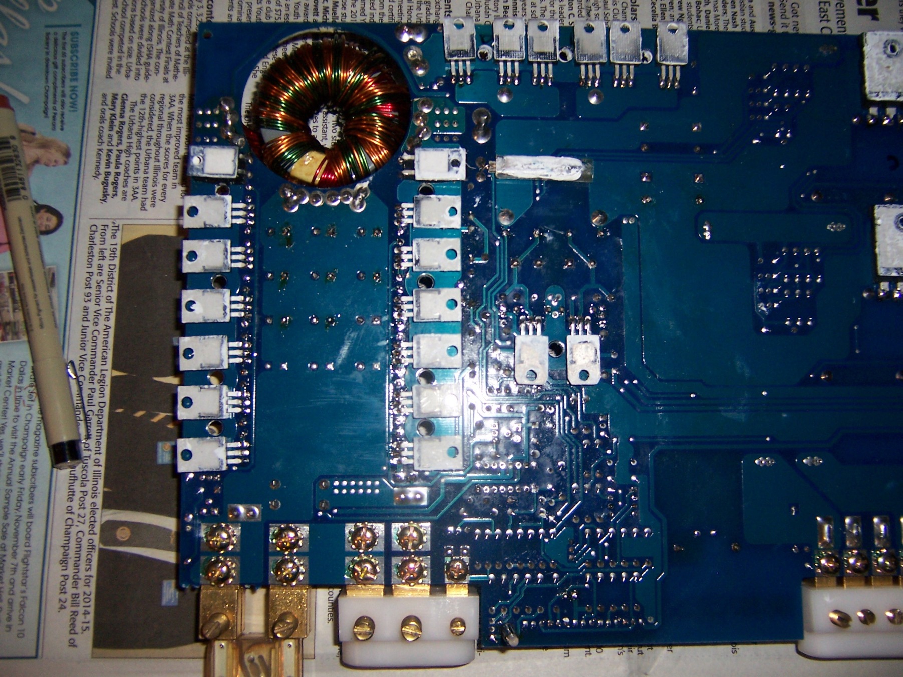

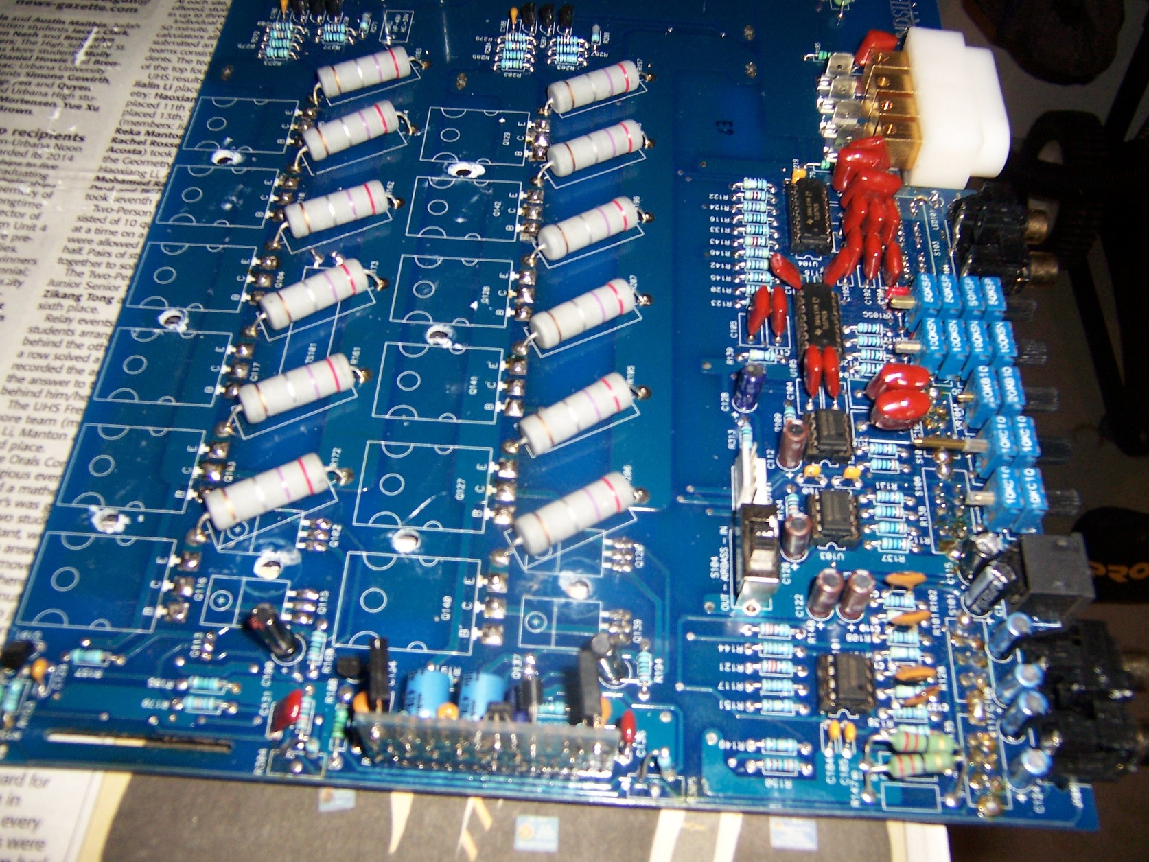

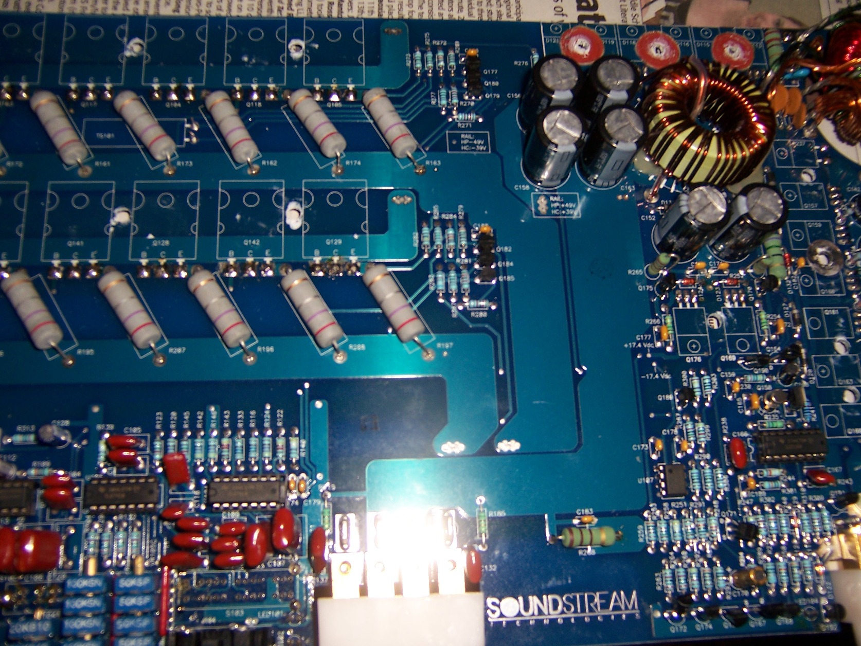

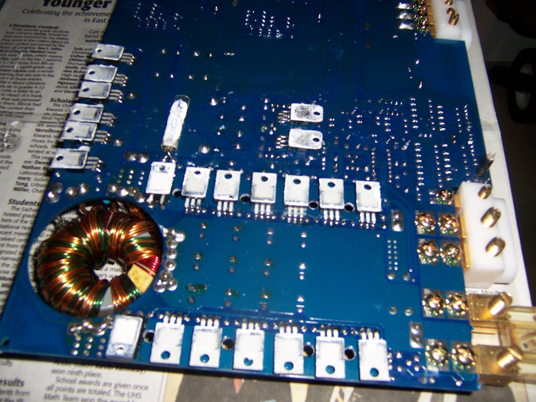

RUB1000-2
Here it is... Just wanted to show the extra mosfet's and how they laid it out... 😀

I checked the original devices and they check out OK so I might put them back in. This RUB1000-2 looked untouched and not blown for $55, not bad! But I may search for the stuff you listed and do the research 😀B&D seems to have the 1304 device for least cost.
