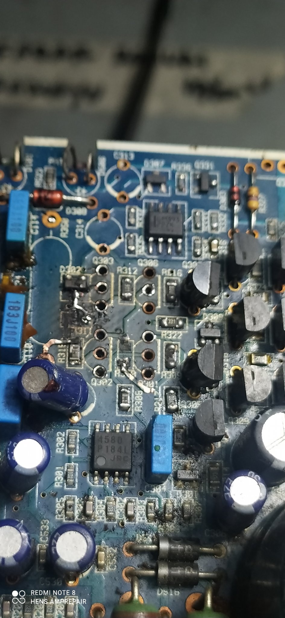

Hi everyone does have schematic soundstream reference micro RFM700.1D, or foto driver fet final audio classD area, i lose some part of resistor & transistor smd, thanks.

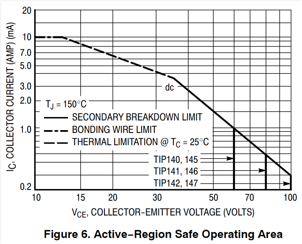

You mentioned that the SOA on the TIP102 at 30v is 2.7A it’s actually more like 2.8A, 😎 Call me a liar for 0.1A at 40v it’s 2A according to chart (pg. 1). Then you said that the SOA of the TIP142 at 30v is 4A it’s not, on the chart (pg. 2) I provided you will see its only 3A, you say at 40v its 2.8A but it’s actually 1.7A, that’s a 15% increase with the 102’s. If you look at the last chart (pg. 3) that shows the TIP102 at 100ms, you will see @ 100ms at 30v the tIP102 has a SOA of 3.8A. Chart 1 and 2 were downloaded yesterday from Fairchild. Chart 3 is from Motorola. I do not work with 100ms SOA charts, only DC.
To Wade. I am pasting the SOA curve of the TIP devices below.
At 30v VCE I see 4A and at 40v I see about 2.7A. Hope my eyesight is not playing tricks on me.
