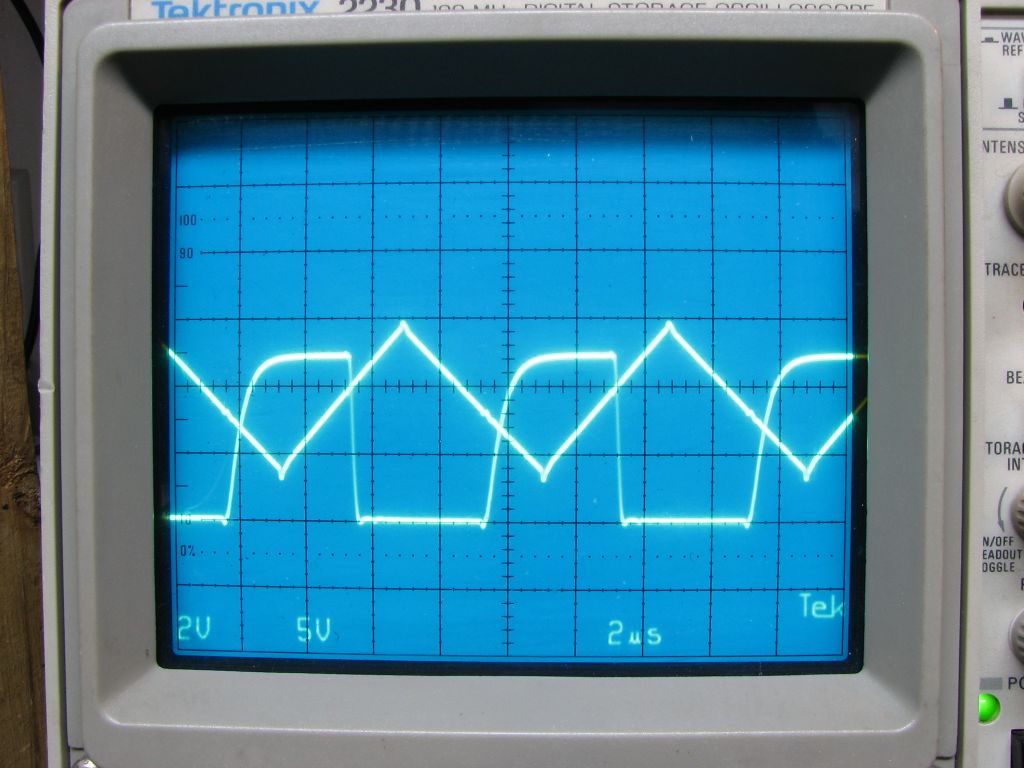

The first image is for reference to show where the traces are without input.

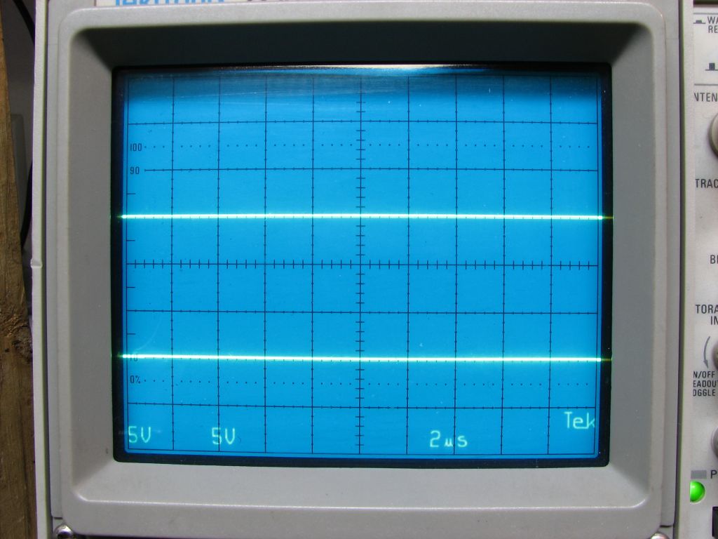

The second is the output of the 4560 and a reference I used for phase (bottom waveform).

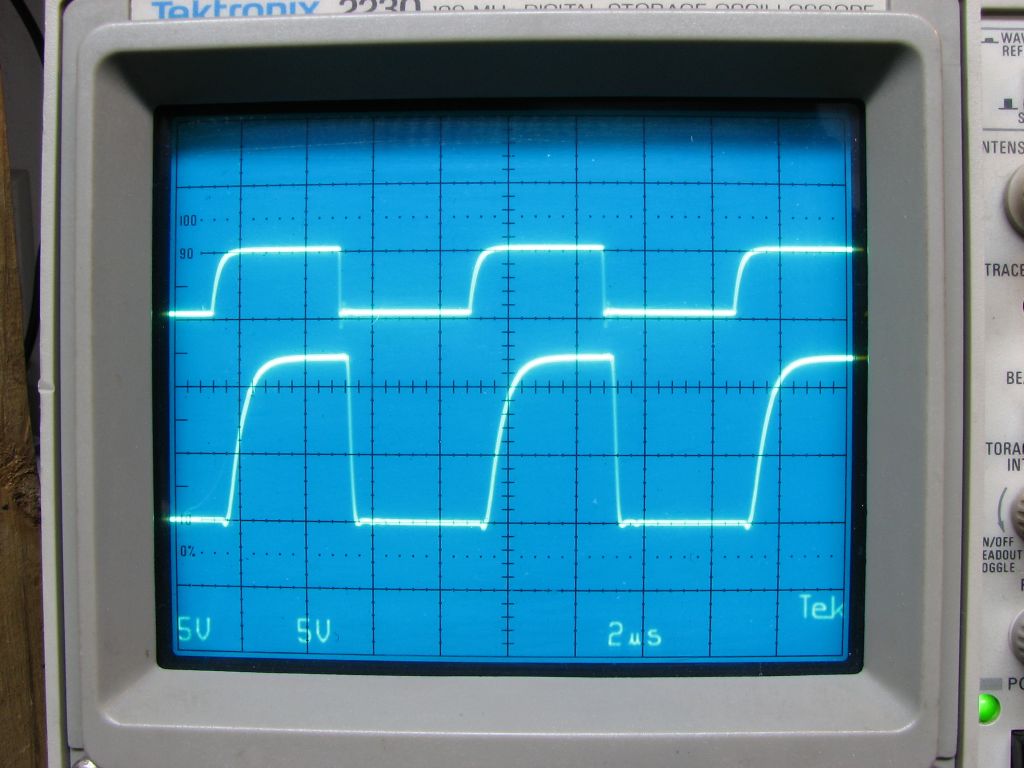

The third image is the output of the LM219 on pin 12 (same reference on the bottom).

Thanks for the waveforms.
It's hard for us old geezers to keep from telling occasional war stories.
As we both know, successful manufacturers won't allow their designers to use components that don't have pin-and-function-equivalent devices.
The free-running triangle generator is a variant of a well-worn circuit.
The integrator is the pin 1, 2 and 3 half of the 4560. Apparently the SS designers felt the pin 5, 6 and 7 half, normally used as a Schmidt trigger was too slow, so they disabled that half by connecting it as a follower and grounded its + input, pin 5. Like CMOS, you never want op amp input pins floating in an undefined state.
Instead, they used the pin 7, 8, 9,10 and 11 half of the 219 as the fast Schmidt.
