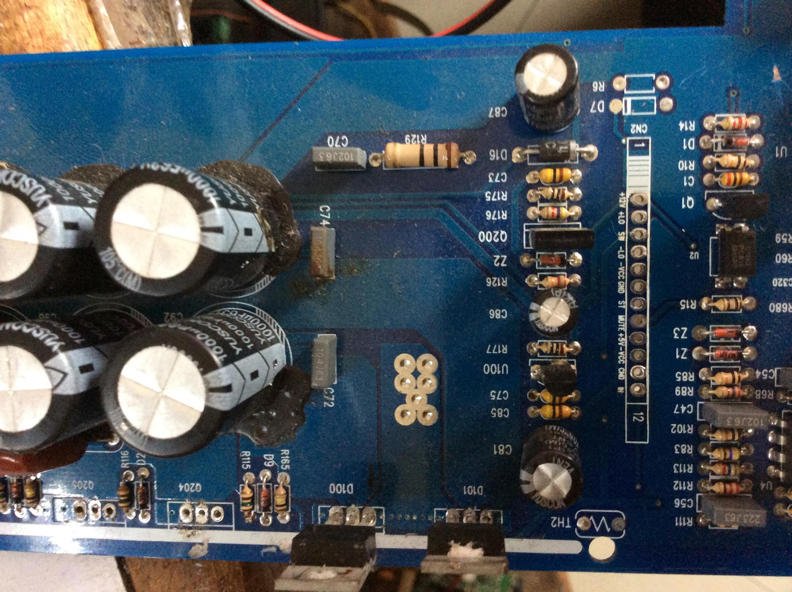

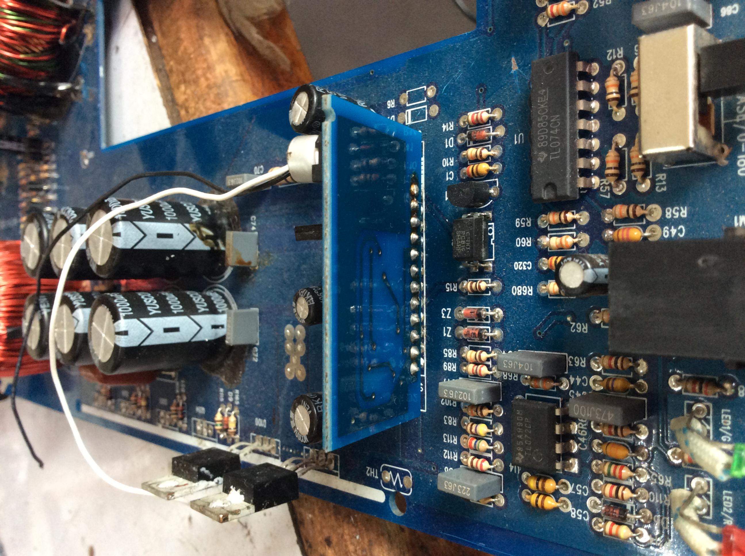

So pin 6 & 7 should get 9v from the 12+ which is present when I measure across the 12v pin and the driver card Vcc.
If I remove the IC or lift those two pins should I see the missing volts on the respective pads?
I’ve check and double check there’s no broken solder joint and all the vias are connected.
I’m thinking a bad chip as I’m not seeing any bad parts surrounding the high side supply defective. It’s just a simple arrangement two diodes, a cap and a 10ohm resistor to pin 6 and 7, which the 12volt is not missing but no volts on those pins.
Is it practical to lift the IC legs and see if it’s the ic which is clamping down the voltages?
The pin 1 on the driver card goes to a 12v source that I think would constantly power the Vb and Vs pins on the driver chip directly. As I said that circuitry around those pins are just a zener diode a cap a fast switching diode and a 10ohms resistor, I think 9volts should be present as long as the 12volt is on pin 1 of the card.
When I test there was 12v present put the 9v wasn’t present on the 6 and 7 pin of the ic.
