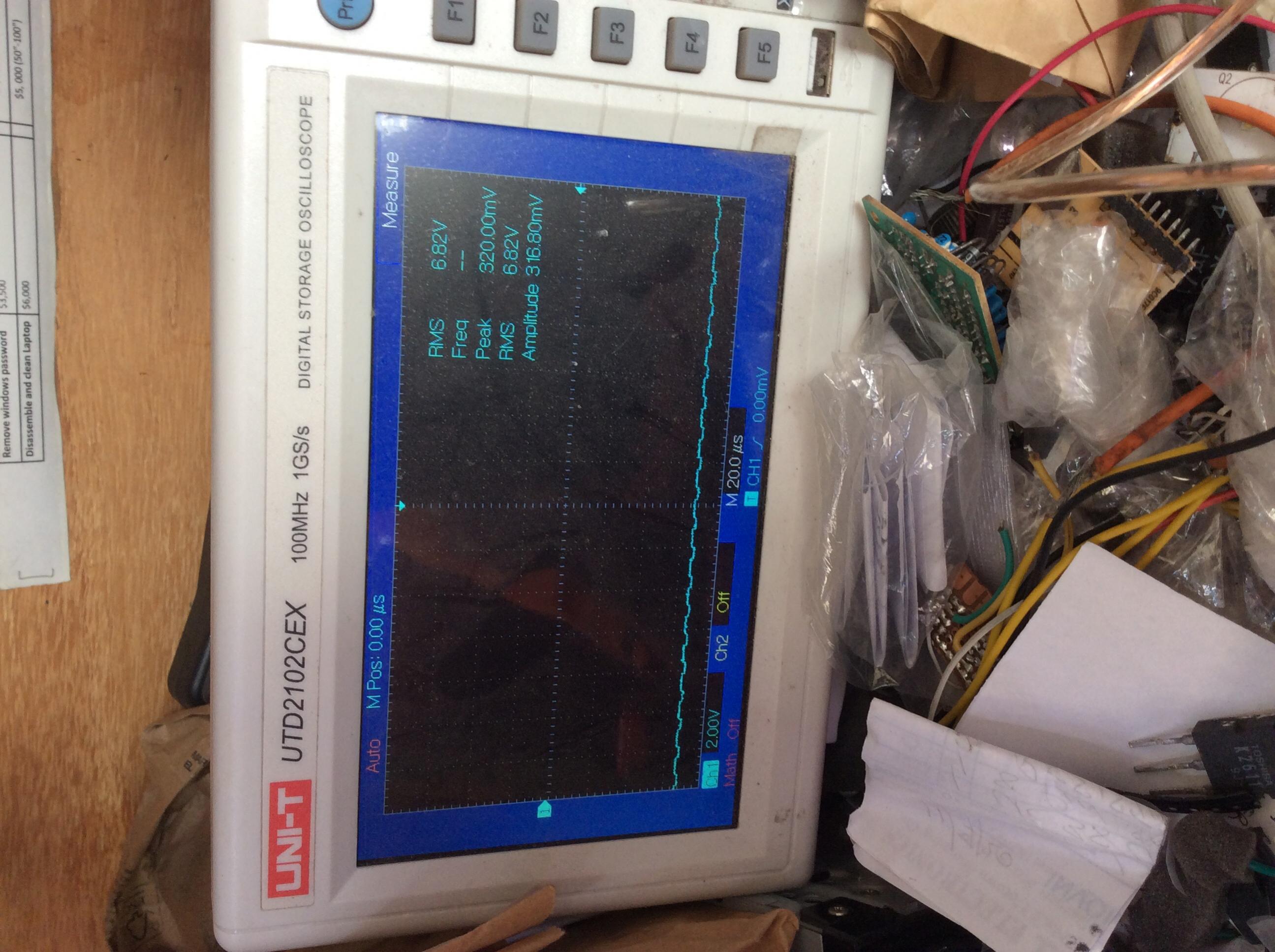

With no output FETs in the circuit, you shouldn't need a high-power load. If you use a speaker, use a woofer, not a fragile speaker. The load can't have a capacitor in series with it.
Power up and confirm that there is nothing more than a tiny fraction of a volt across it.
2 ohm current limiting resistors work well for this.

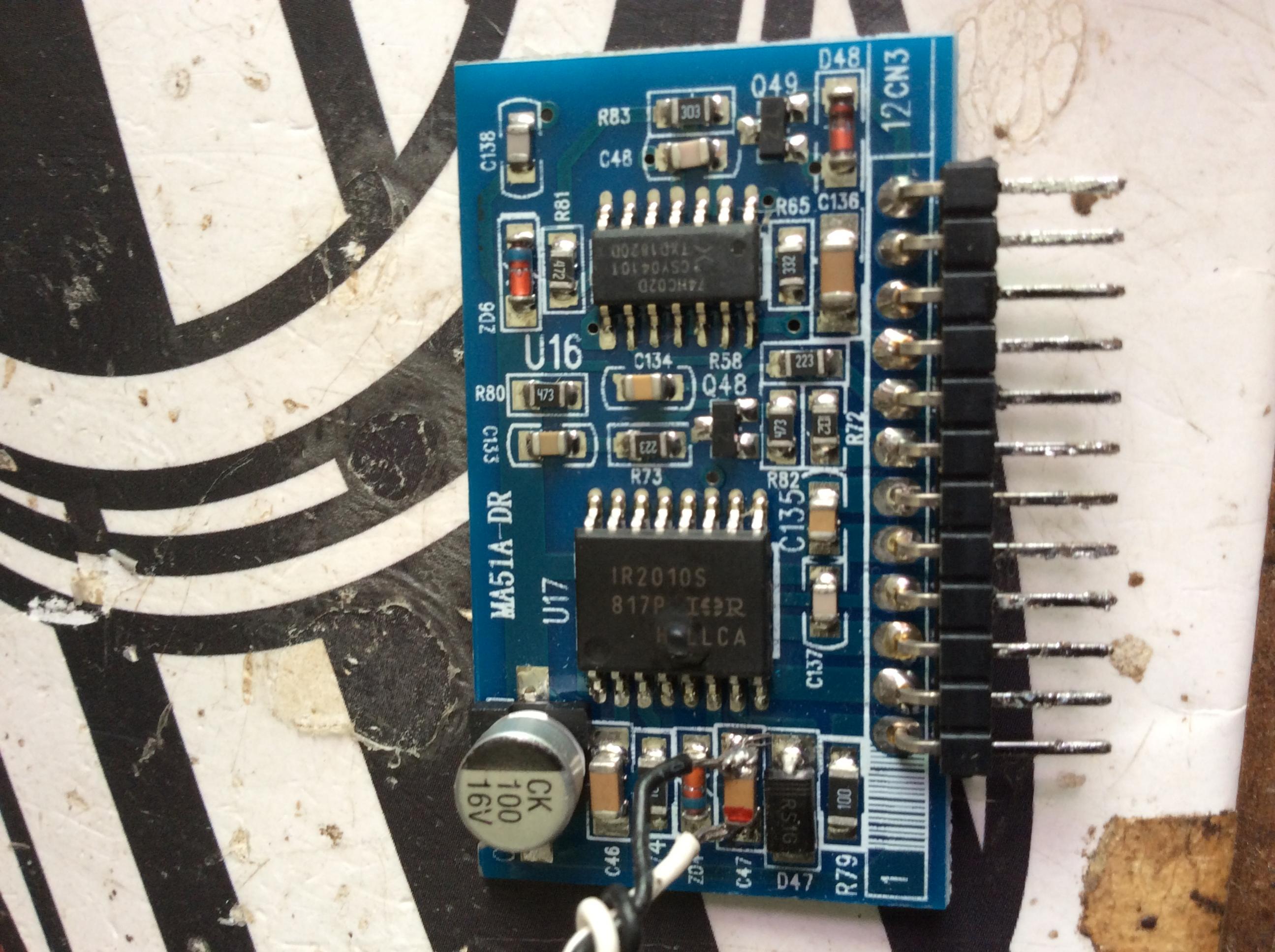

If this doesn't work, I need to see the components driving the driver board.
That didn’t work still a good low side drive nothing on the high side.

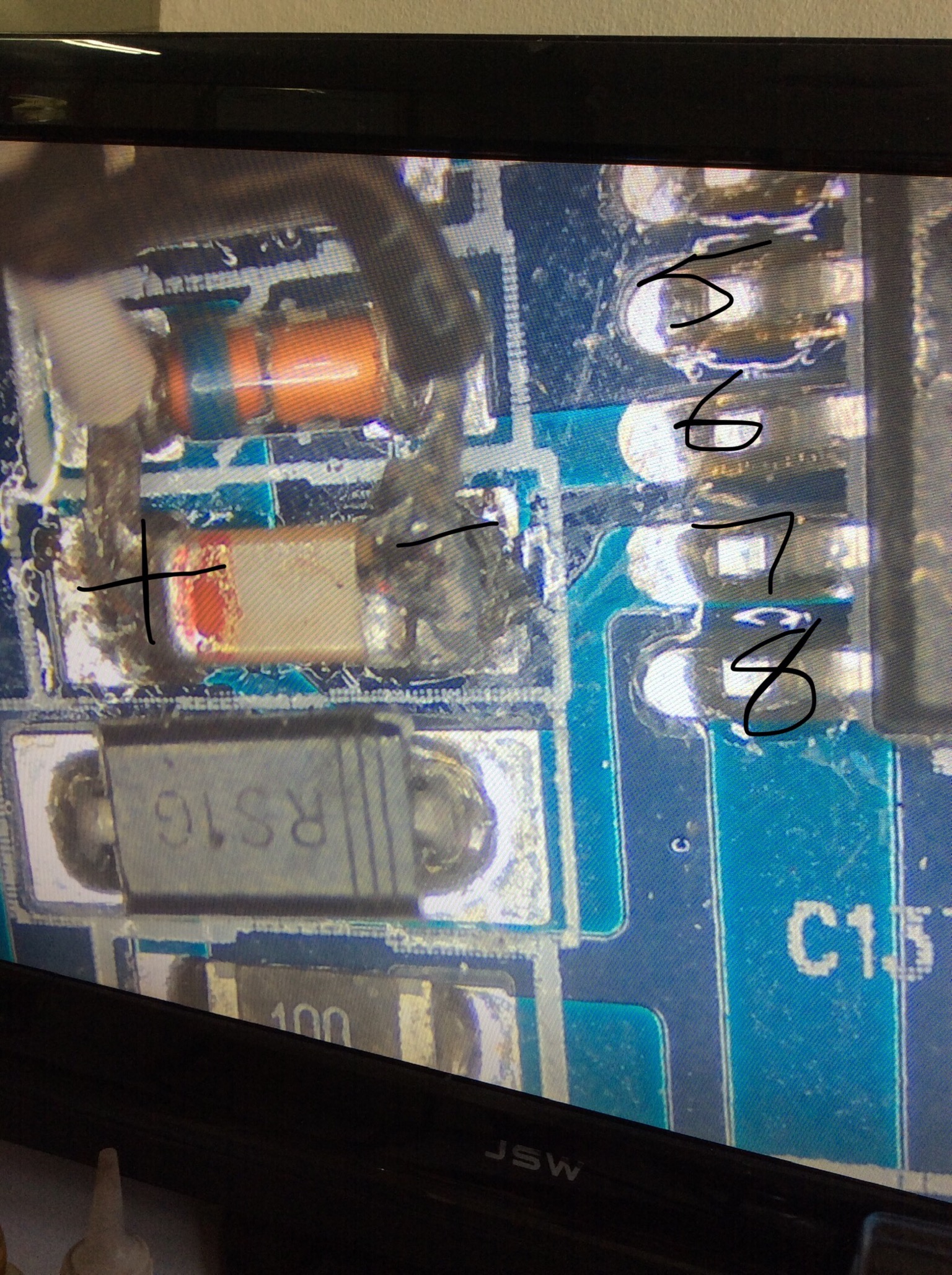

I did not leave the battery hooked up continuously to the circuit, and when I connected it I parallel my probes and the voltage was stable, I’m not getting a short across the cap so then the IC may be faulty, I’ll replace the IC and report back.
So pin 6 & 7 should get 9v from the 12+ which is present when I measure across the 12v pin and the driver card Vcc.
If I remove the IC or lift those two pins should I see the missing volts on the respective pads?
I’ve check and double check there’s no broken solder joint and all the vias are connected.
I’m thinking a bad chip as I’m not seeing any bad parts surrounding the high side supply defective. It’s just a simple arrangement two diodes, a cap and a 10ohm resistor to pin 6 and 7, which the 12volt is not missing but no volts on those pins.
Is it practical to lift the IC legs and see if it’s the ic which is clamping down the voltages?
The pin 1 on the driver card goes to a 12v source that I think would constantly power the Vb and Vs pins on the driver chip directly. As I said that circuitry around those pins are just a zener diode a cap a fast switching diode and a 10ohms resistor, I think 9volts should be present as long as the 12volt is on pin 1 of the card.
When I test there was 12v present put the 9v wasn’t present on the 6 and 7 pin of the ic.
