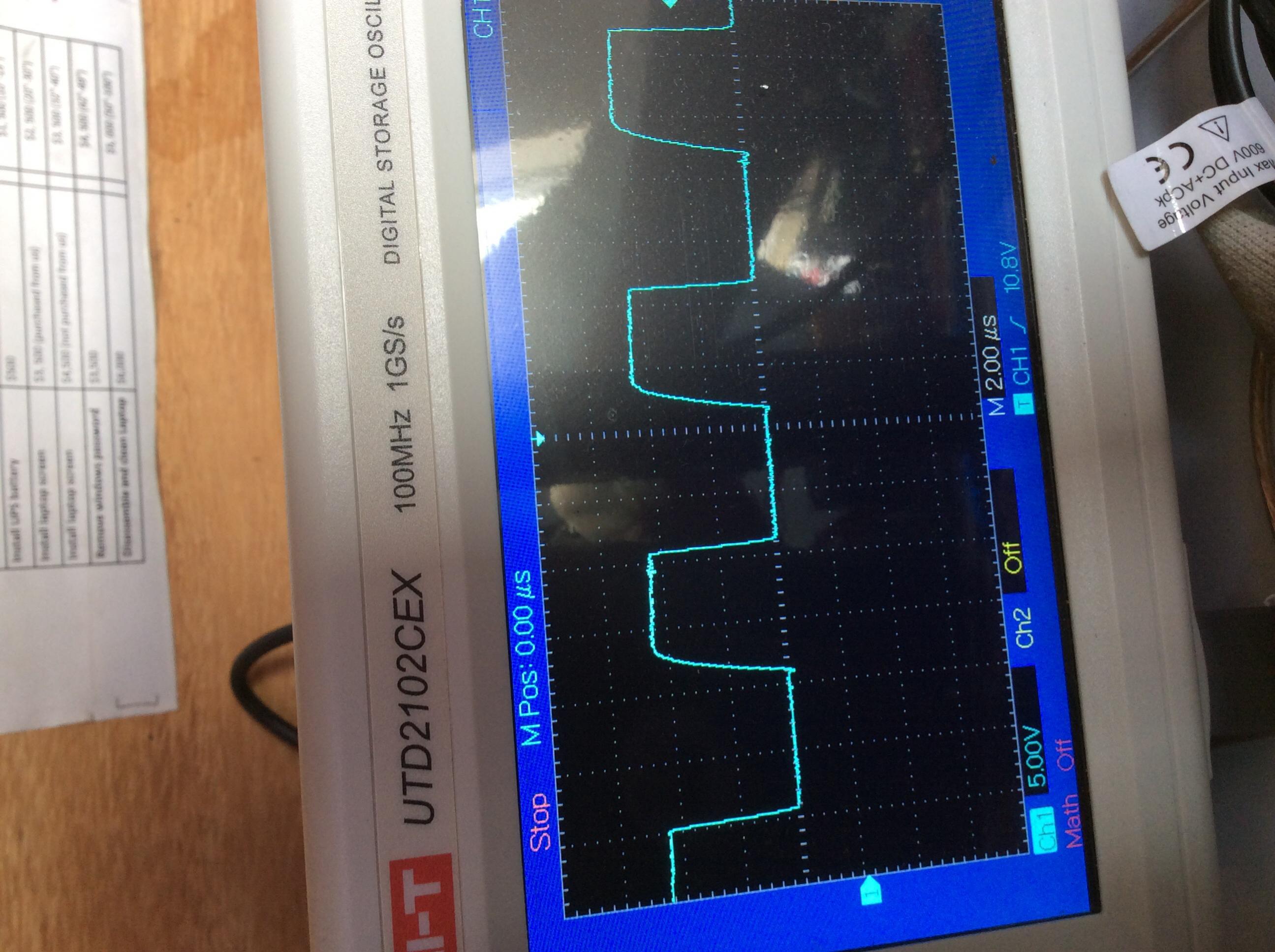

Yes I have square waves at the gates but I can’t calculate the frequency, I forget how to.🤔
The power light at times flicker (cycle) to protect at times back and fort randomly**

Well to be honest it only blew three fets out of six on one bank, and when that happen I was actually rocking the card in the socket that I mounted after you let me know the socket isn’t the best of practice as the OEM ones has parallel rows. Then after mounting the socket the unit start to display some erratic behavior so I think my soldering wasn’t thoroughly because of damage vias (even after the wiring there were two connections that failed the thru via continuity test)
So based on the gate drive waveform it would appears the card is working?
