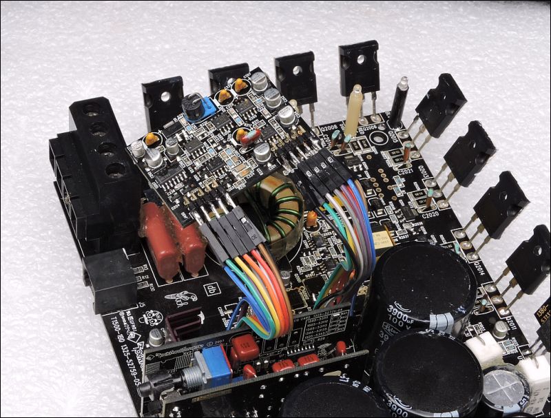

Some people use sockets and it's sometimes done in amps but those OEM sockets are generally double-row with parallel connections. A pin losing its connection for even a fraction of a second (oxidation, contamination, vibration...) can cause the amp to fail catastrophically.
If the socket was installed to allow easier troubleshooting, I'd recommend using wire jumpers instead. You can have complete access to the driver board and the driver board will be functional.

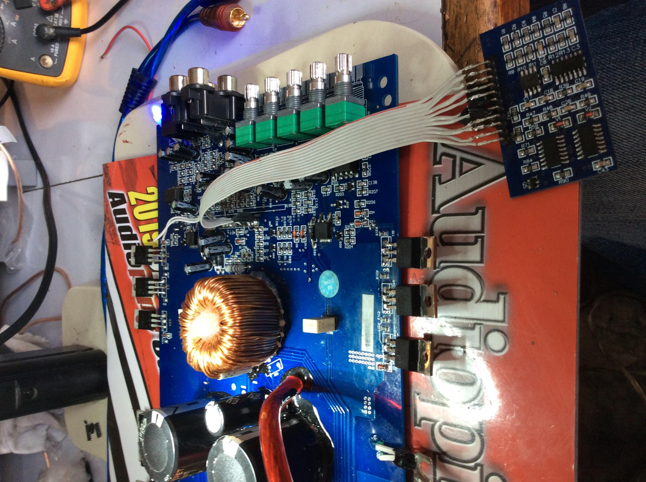

I’m going to remove the header and solder the driver board to the main amp board since it can be catastrophic. Do you have a sample of your wiring method using the jumper wires, length of wires, insulation and positioning can post here?
You can use Arduino breadboard jumper wires (search ebay for that). or simply use old computer ribbon cable stripped (time consuming).

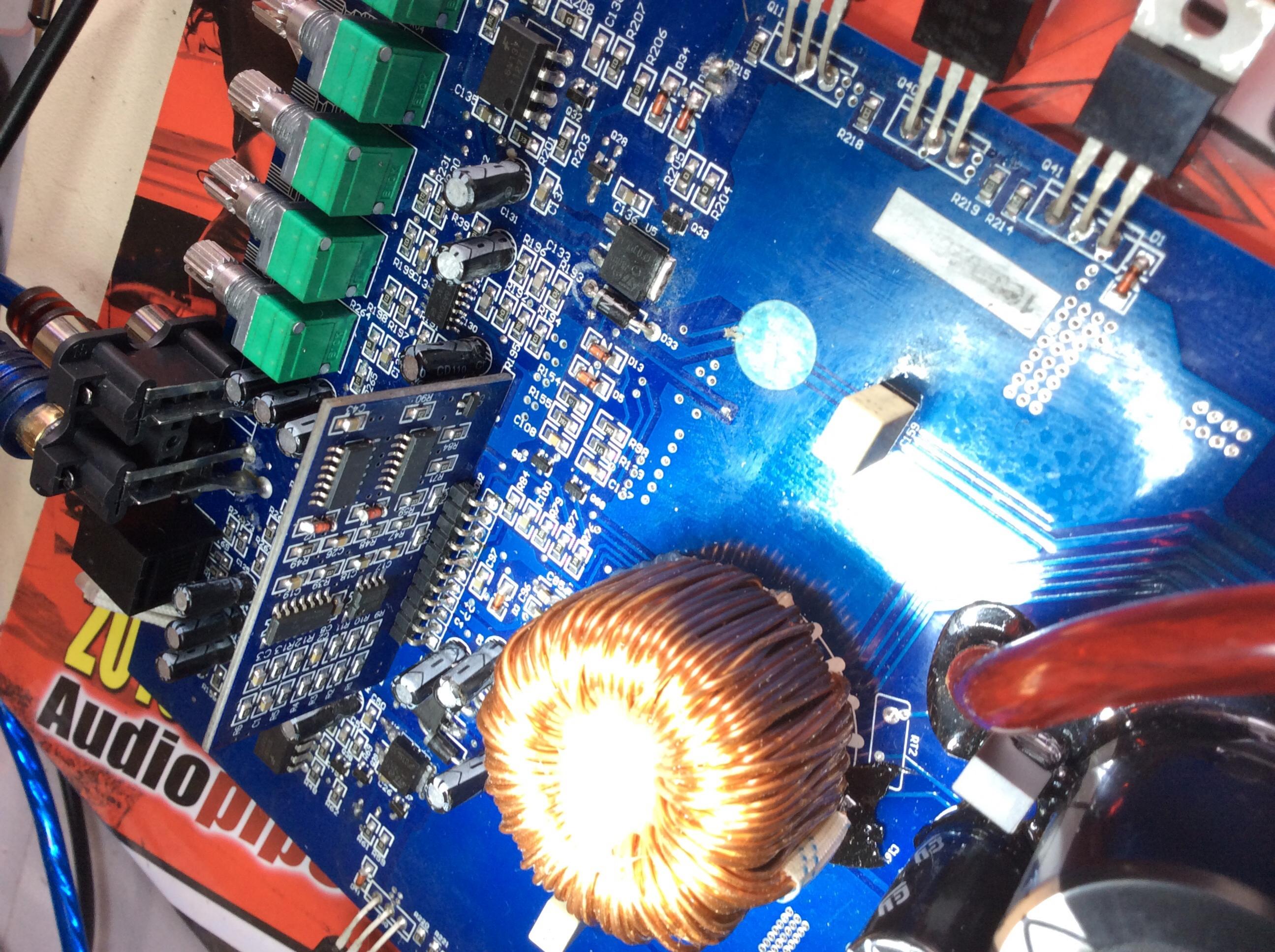

I’m at the stage now where no output install, I’ve wired up the driver board ready to take some instructions for a proper test so I can achieve the best results to have the amp running again.

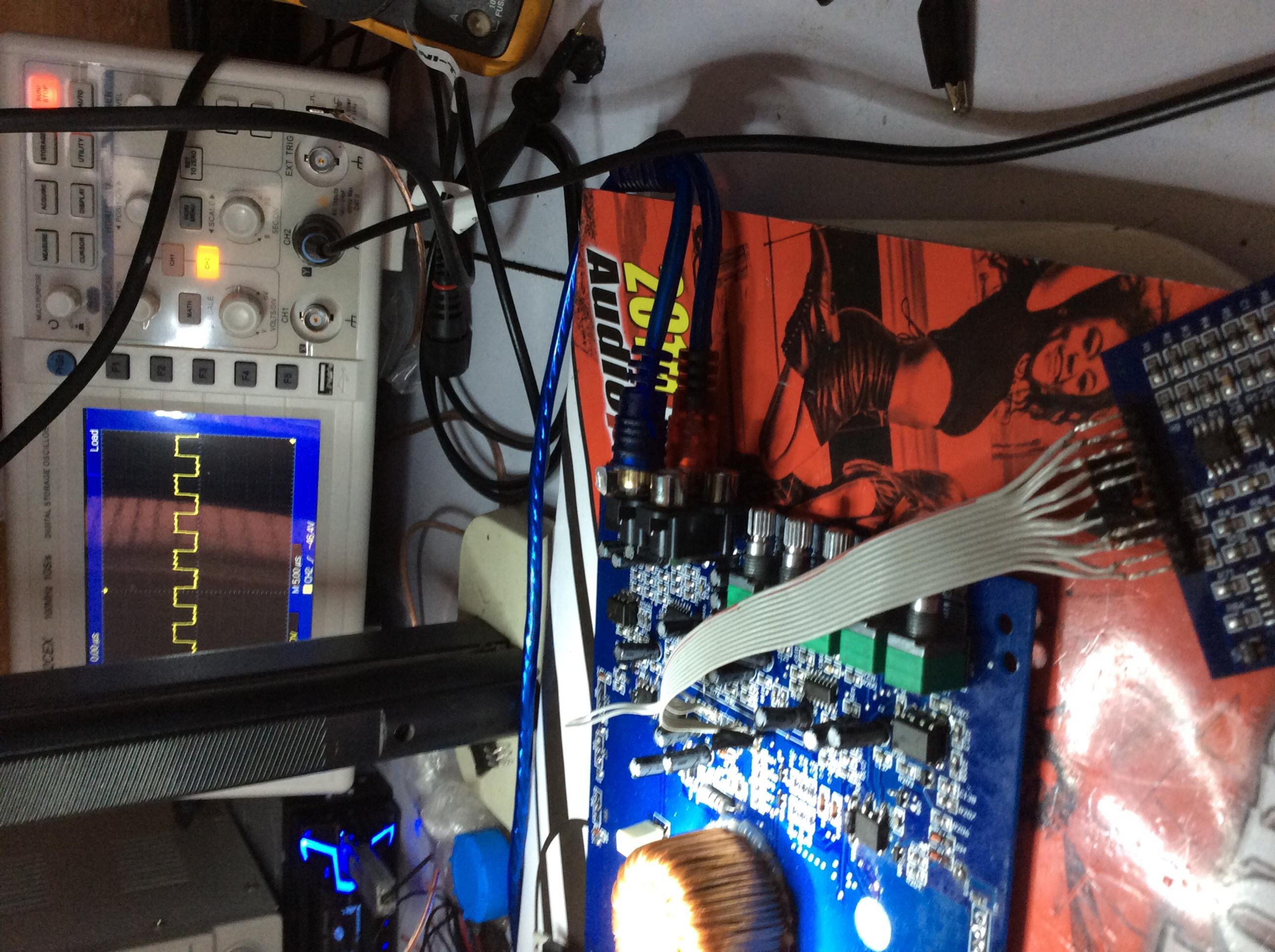

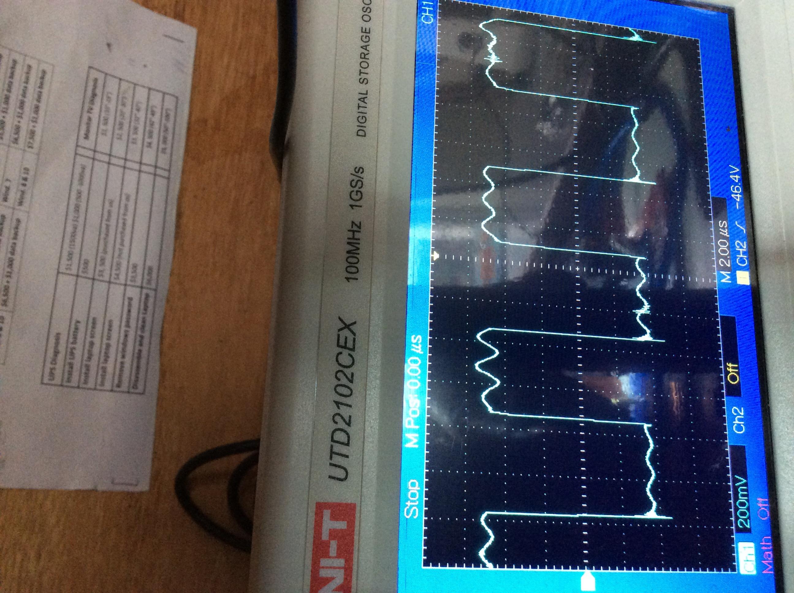

I don’t know if without the fets I would get a solid square wave, but the side that’s heating up has a waveform like my attached picture unlike the other side which is perfect square wave, the waveform is perfect up to the drive pins from the card but is distorted to the outputs.

I have 12+/- already to the drive circuit when measured with the fets in the drive waves are at least alike now.

So it’s now settings; rectifiers out, output installed, amp boots from protect to power good, gain at 50% (I only have music not a set frequency) how and what are the parts or components I probe around?
