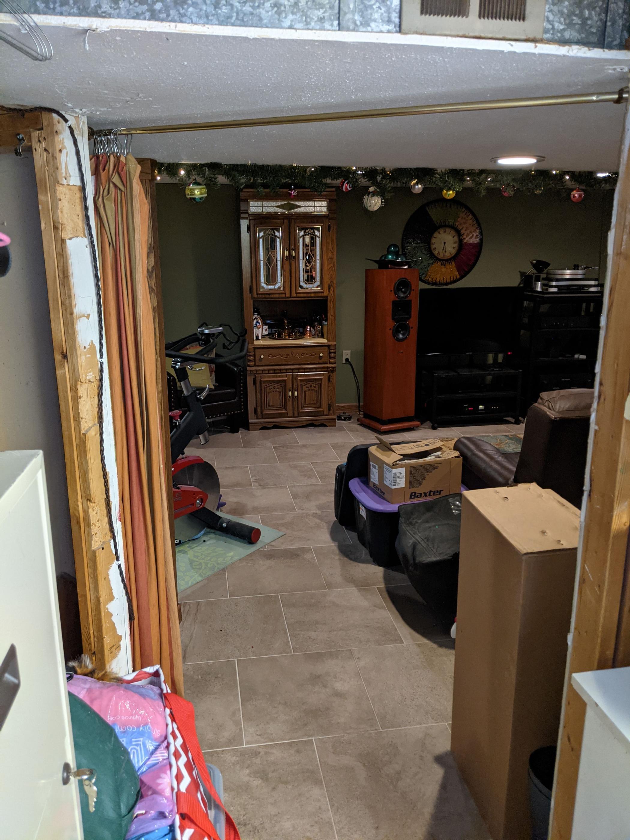

I'm looking for advice in building a "soundproof" door between my basement listening room and the utility room which has the washer & dryer along with the furnace.
What amount of noise reduction are you looking for, and at what frequencies? For example, do you want 30 dB reduction in the typical measurement ranges of 32 Hz to 250 Hz to reduce the rumble of the motors, or do you need 50 dB reduction in that range? Or, are you mostly concerned with the "whoosh" of the furnace fan and air, and the water and clothes in the washer and dryer?
How much noise is coming through the ductwork and the wall? Will a really good door end up redirecting your attention to other noise pathes such as these?
Just Dave,
I'm looking to reduce the operating noise of the washer, dryer and fan noise of the HVAC. If I could reduce noise by 30 db. I would be happy.
The walls will probably have to be addressed at some point they are 2" x 4" with drywall and the laundry room side of the wall is open (no drywall).
I will be insulating the floor joist area above the wall and into the laundry room.
Scott

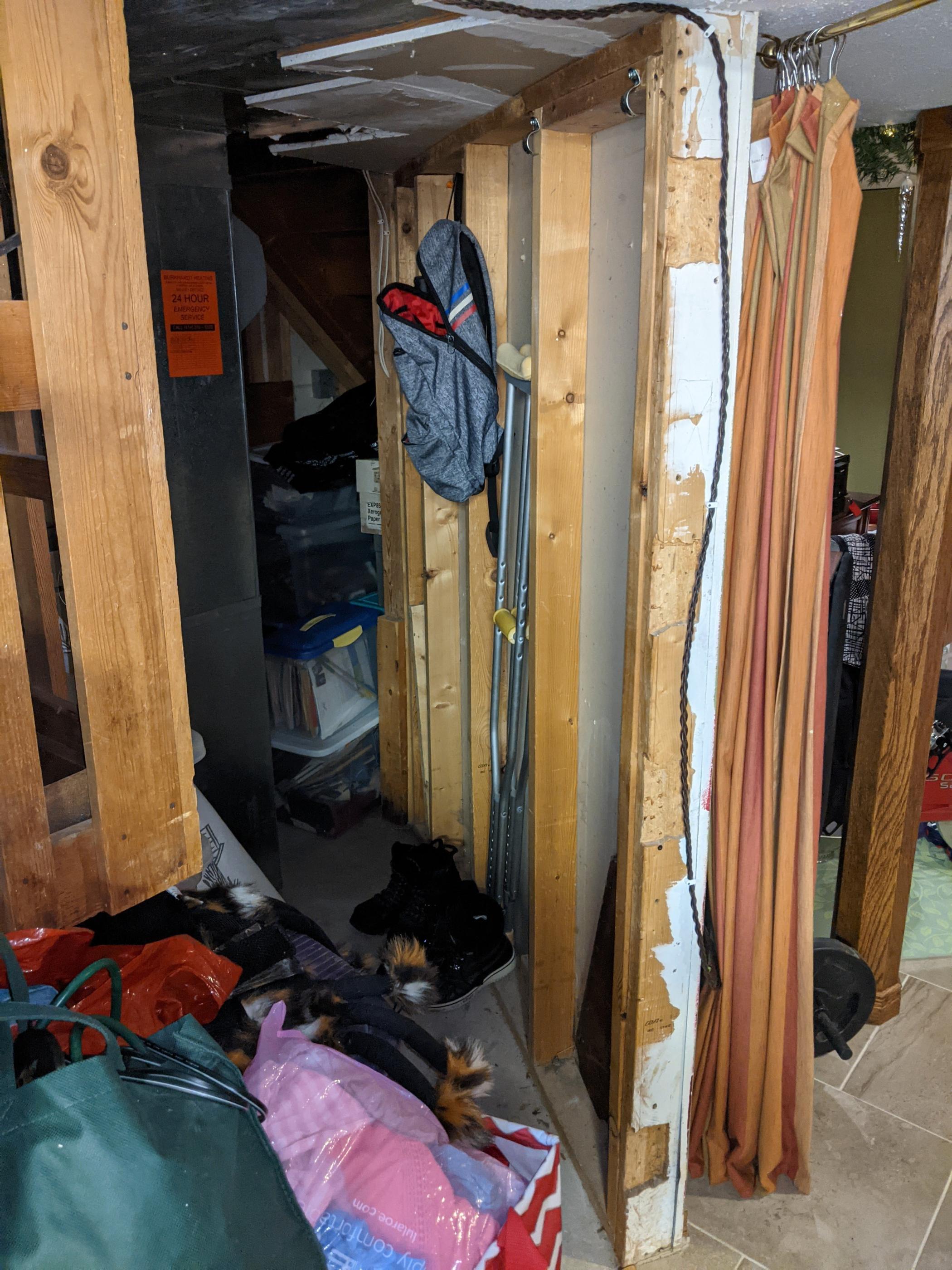

I hung 3 moving blankets across the opening tonight and it reduced the level of dryer noise by 5 db on my trusty Radio Shack db meter.
On the left hand side of the photo of the wall you can see the HVAC ductwork. The washer and dryer are behind me in the photos.
Please disregard all the junk on the floor!

Sorry, but have to agree with the naysayers on the heavy blankets / quilts -- it'll take the edge off the top octave, maybe top two, but that's about it.
It's a widely held misunderstanding. Absorptive materials give good attenuation of *reflections* from a solid surface. But to attenuate *transmission* requires mass -- only solid, heavy objects need apply for the job.
I'd be awfully tempted to split the 4½ foot width into 2½ & 2 ft, or 3 & 1½ ft wide, 'regular' hinged doors. Trying to seal a pocket door would be a nightmare. Also, you won't be able to add as much mass, since the whole of it has to be moved to open or close it, and no help from hinges (holding some of the weight), and no 2:1 mechanical advantage to move it.
Cheers

sorry but with only a drywall skin and open studding there's no attenuation there, so worrying about an effective door is a little pointless, no?
and with no space between the ceiling drywall and the duct above how is the duct isolated/attenuated?

The wall will be addressed with insulation and 2 layers of drywall with green glue between the layers.
My main concern is what to do for a door.
I have a neighbor that is a carpenter so I'll have him take a look at it and see what he has for ideas for the door.
You would be far better off addressing the main part of the wall by building a 2x2 stick frame with drywall and space it the distance you need to slide your new pocket door into. No green glue, no two layers of drywall, no connection between the new and old wall.
The pocket door can be made from triple layered 1/4" plywood on lathe picture frame separators. So it's plywood, lathe, plywood, lathe, plywood. This is where the green glue comes in. If you fasten only on the picture frame there will be little to no transmission of sound, not even the bass.
What you need to do is take what you have and adapt it as best you can like the pros do it. It's won't be perfect if you want to leave what's existing, but it will be darn good.
