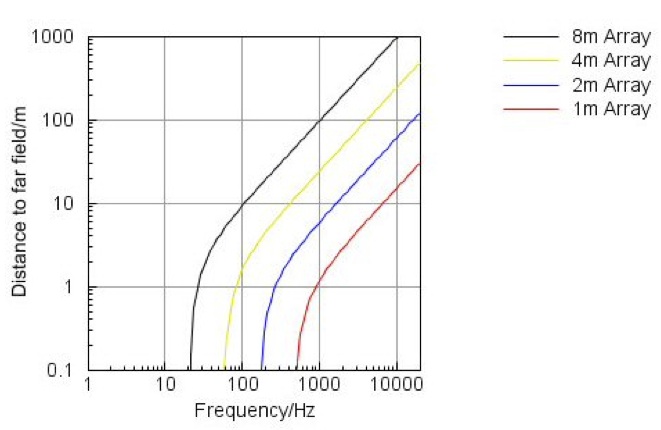

I have just read Stephen Buntings article on line arrays which included this graph showing the listening distance at which line arrays change from near field to far field sources, i.e. 3dB per doubling of distance to 6dB, compared to the length of the array and frequency.
A 1m long array is effectively far field at 1 m for all frequencies below 1Khz! It appears that there is not much benefit in a small line array except for increasing efficiency.

It is not a line array until it starts approaching floor to ceiling height
Why such limit? What about attic and basement? 😉
I did many experiments with line arrays, and can swear that even 1 meter high array of 12 mm drivers result in properties of line arrays. I use such an array as a tweeter in center channel. Right and left channels consist of 8 each 4.5" fullrangers, and 16 of Foster speakers for Dell notebooks as tweeters. Still, very low distortion due to greatly minimized excursions for needed SPL level, still wide "sweet area" instead of "sweet spot", and almost unnoticeable difference between standing and sitting listening (well, you can note it in dynamics, while sitting down, or standing up).

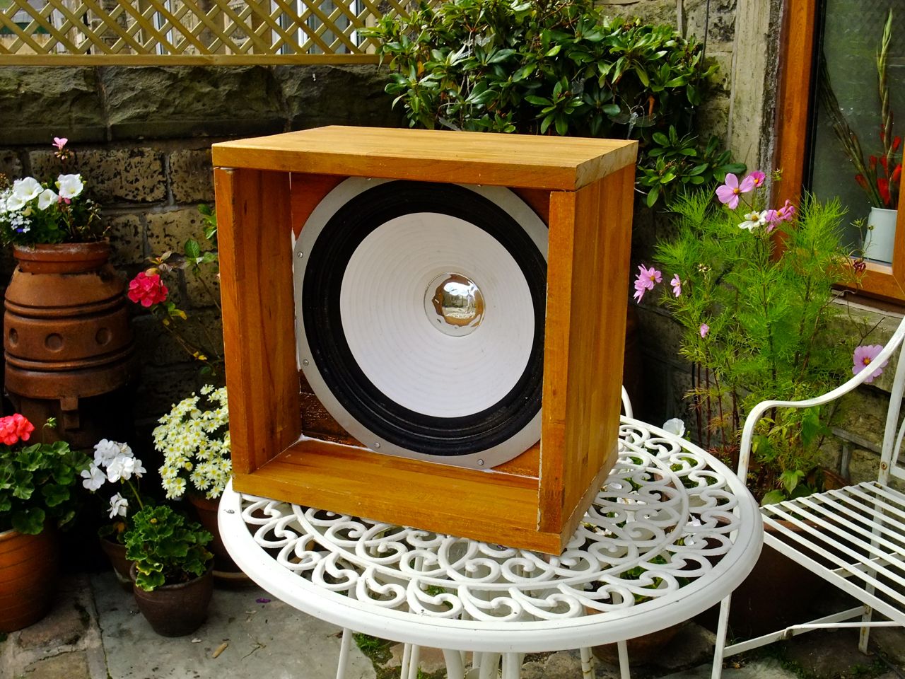

I now have an H-frame subwoofer! I made it from a piece of left-over beach work top. Don't look too close as my joinery skills are far from perfect. The excess white wood glue is an attempt to seal the gaps = it will dry clear.
The H-frame is based on Martin King's design. I shortened it slightly to tune the resonance and FPeak to around 310Hz. The cavity cross-section is 40.5 cm x 40.5 cm. The overall depth is 31.5cm giving an actual cavity depth of 14.25cm and effective depth (at low frequencies) of around 28cm. With a 12dB/octave low-pass filter set at 145Hz, the effective crossover frequency should be a little over 400 Hz. The sub will have its own amp and PSU.
The idea in raising the top reach of the sub-woofer is to allow smaller open-baffle satellites. I believe these should have an effective diameter to match the H-frame, i.e. 56cm. Using the same fpeak bump to move the effective crossover frequency down, I believe the actual high-pass filter needs to be set around 580 Hz.

aargh! How did the garden party go?
Well, thanks for asking. It went fine and the sound system was considered a marvel by those technically or sonically inclined. I have the system in my office now hooked up to my Mac.
The experience gave me the confidence to cut two 6" holes in my living room wall and install flush-mounted full-range drivers powered by a 'Class-D' amp for a truly purist experience!
I get the impression you don't believe me. I put them near but not in the corners to emphasise the bass (boundary effect x 2) above other frequencies. Being old and because treble does enjoy the baffle boost, this is boosted at the amp instead. So not perfectly pure but a superb sounding system for around £30!
