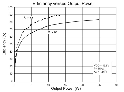

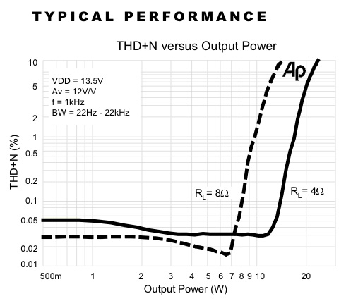

The AAs are the low self-discharge rate NiMh cells with a 2100mAh capacity: 2.1Ah x 12V nominal = 25.2 Wh.
With an 8 ohm load, the Tripath 2020 amp has a mean THD+noise of around 0.02% (-74dB) until around 7W when it starts climbing a cliff face to 10% @ 13W. Its efficiency starts around 20% and rises to 90% at 13W. At 7W, ts efficiency is around 81%: 7W/ 0.81 = 8.64W input or approx 3 hrs battery life at max usable power with a corresponding SPL of almost 120dB at 1m. I understand the Lepai amp uses an opamp to drive the tone controls so the actual battery life should be a little less than Tripath figures alone would suggest.
Here is a link to the Tripath data sheet. I have lifted the relevant graphs and stuck them below.
http://www.e-ele.net/DataSheet/TA2020.pdf
Tim.

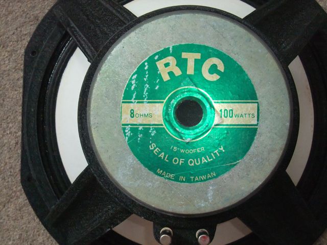

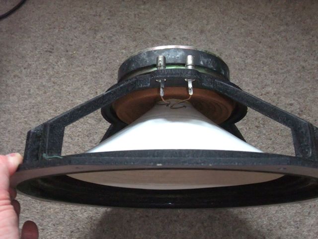

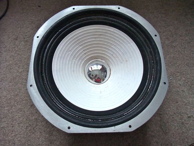

Also, there is now a new dimension in the equation. My brother had a clear out of his loft today and found a 15" woofer I bought almost 30 years ago. I thought it had long since been thrown away. Did I still want it ? Yes!!
When I bought it I knew the t/s parameters but not now. I have searched on the net and not even the make can be found let alone the model. It is probably not the best quality but does have a cast aluminium cage. The magnet looks like ferrite with dimensions 16cm x 20mm and it has a paper cone with rubberised edge.
So now I accept I need bass support, what is the best strategy with an unknown 15" woofer? It would be great to keep the main OB pair crossover-free, handling the 'critical range' low mids upwards and relying upon the natural bass roll-off instead. Then I could just put a corresponding low-pass on the woofer. Amps modules are cheap enough and I would like to avoid a huge box.
It has been a bit long-winded but basically I would like to have a pure OB, crossover-free pair handling all the critical range and use my unknown 15" woofer with filter and an extra amp in the smallest enclosure to handle what the OBs can't.
All ideas, pointers or links appreciated.
Thanks,
Tim.
Wahey, that's gonna help move some air.
With unknown T/S parameters, I think I'd try either a decent sized sealed cabinet, or a bigger ported one tuned ~40Hz.
I think it would be wise to put an active crossover in for the open baffles. They will be so much cleaner without the extra bass.
Any idea how much linear travel the woofer has?
