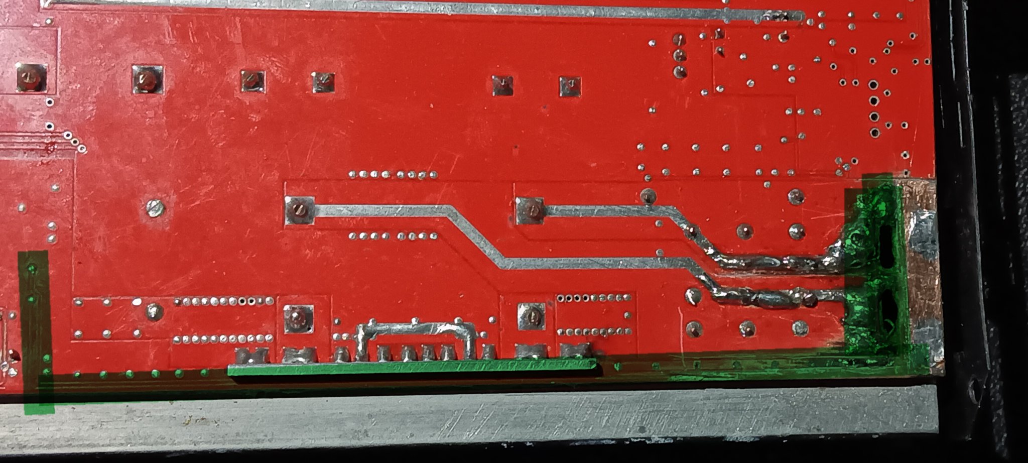

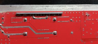

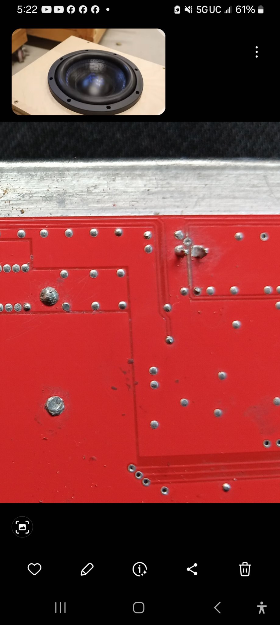

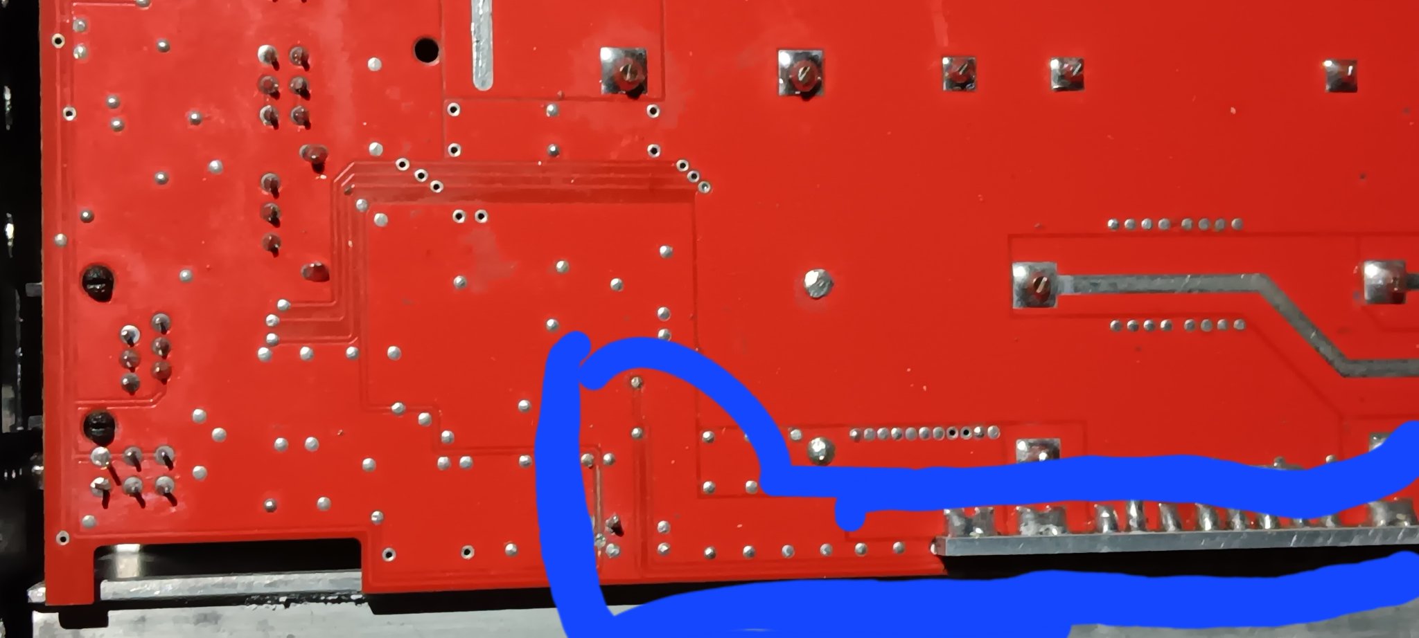

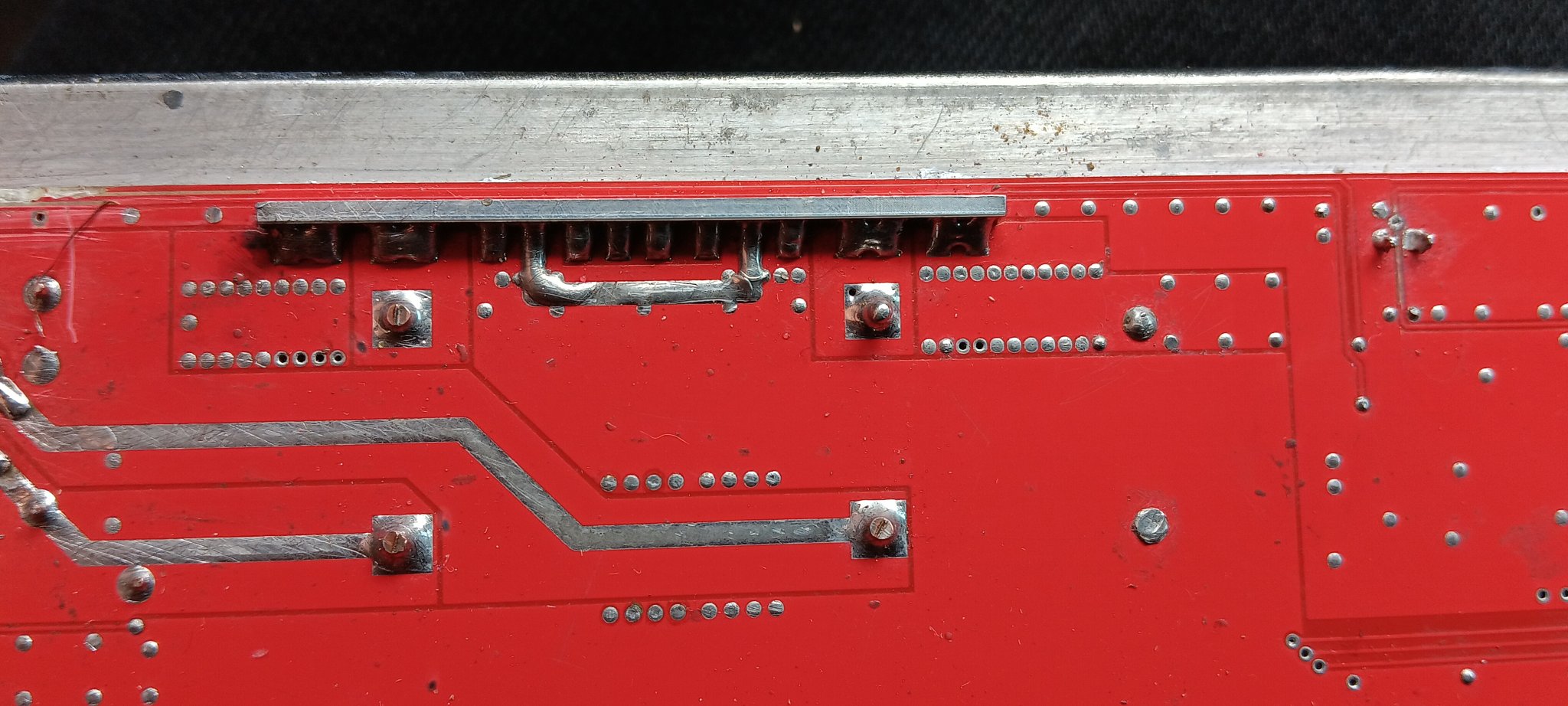

New to this site I was wondering if by any chance you had a picture or could just tell me where the two wires on the right top edge of the board go to. They are right next to the subwoofer output post soldered onto the board I have a 3000.1 evox2 amp and the output post where the subwoofer speaker wires bolt down to got loose on the main board. I fixed it once and they became loose again but this time I can't figure out where they went to
