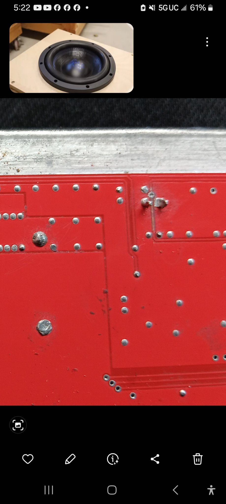

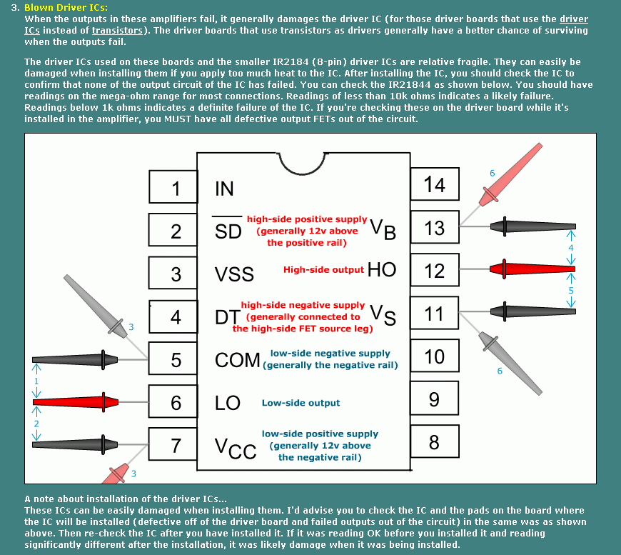

Okay I think I can manage with everything else but those output gate drivers are a big questionmark. Some Groundzeros had irs21844 so could I try the 8 pin version of it IR2184? Although I think the pinout is a bit different on these ones because the gates are controlled from different pins..I think, I'll try to measure and get back.
They may not be defective. Look at the pin configuration for the ICs in the image below. Use the pin names to see where to place the probes on your IC.
Do both ICs read the same?
